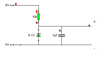

Hey all
picked up a new book today on power supplies (in an attempt to try and increase my 'limited' knowledge of electronics)
the circuit in question is attached below (although values not set - but just downloaded croc clips quickly and couldnt work out how to turn values off)
am i understanding this right? if the unstabilised input voltage from the left of the circuit increases (above zener voltage) it starts to conduct, which means the decoupling capacitor will "take over" until the voltage is back to normal and then if the voltage drops below the zener voltage it will also conduct meaning the capacitor will be used?
just wanted to clear this up :)
Kane
No Kane, you do not appear to be understanding the circuit.
When the supply voltage is below the Zener voltage, the Zener is off and the capacitor is charged to whatever the voltage is. If a load is applied, the voltage will decrease in proportion.
When the supply voltage is above the Zener voltage, the Zener is on and current flows through it. The capacitor is charged to the Zener voltage.
If a load is applied, current flows through the load and the Zener current decreases. But the voltage does not decrease very much. So the voltage is regulated at the Zener voltage (about 5.1 Volt)
Provided that the current taken by the load is less than the current through the Zener before the load was applied, the voltage will be regulated. Once the load current exceeds this value, the voltage will decrease in proportion.
Your circuit shows that the supply voltage is 9 Volt and the resistor is 10k. Thus with no load, the Zener current will be about 9 - 5.1)/10k = 3.9/10 = 3.9 mA.
So the voltage will be regulated at about 5.1 Volt provided the load is less than 3 mA. At a load of 3 mA there will be 0.9 mA through the Zener thus it is still on. But if the load increases, the voltage will decrease gradually until the load current reaches 3.9 Volt and then it will decrease in proportion thereafter.
The capacitor is provided in order to provide a low AC source impedance. It does not provide regulation.
Len

This statement is misleading.
The capacitor can only maintain the voltage for a very short time. In the circuit shown, if the load was 3 mA, the load resistance would be about 5.1/3 = 1.7k. Thus the time constant would be 1 uF x 1.7k = 1.7 millisecond. This means that if the 9 Volt supply was switched off, the voltage would fall to zero within 1.7 x 5 millisecond, ie. about 8.5 millisecond.
Len

there is just one thing i dont understand
if the zener is "on" and the current is flowing straight through it ....how can the capacitor be charged?
Kane
When the Zener is on, there is about 5.1 Volt across it. So the capacitor charges to this voltage.
Len
so if this is used as a stabilised supply and the voltage increases, the zener turns on and starts to charge the capacitor... so how does this create a constant output if it is only charging the cap?
When the input (9 volts) starts from zero, all the current goes to charge the capacitor, until the voltage reaches 5.1 volts where the zener turns on. Thereafter, no current goes to the capacitor, it all goes thru the zener. The purpose of the capacitor is to supply pulse current to the load. The load could draw more than 3 mA for a short time, pulling the current from the capacitor.

That should be 3.9/10k=390ua.
Ignore the capacitor, it doesn't really affect the working of the circuit, in fact remove the capacitor completely!.

thats exactly what i was trying to explain ... and then the capacitor is simply used to "soften" this noise of the quick switching?
but then ljcox said something about the capacitor being charged by the zener ...which totally threw me off!
Thanks alot
Kane
The 5.1 volt zener has a positive resistance, it won't turn on and off. One advantage of 5.1 volts is that the temperature coefficient is close to zero. Lower voltages have have a negative coefficient, higher voltages are positive.
