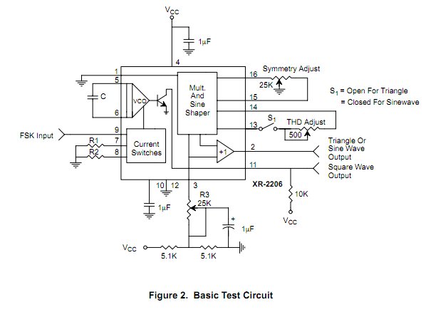

I've built the basic test circuit shown in the datasheet for the XR2206, it works ok, but when I'm turning up the supply beyond 10V, the output becomes unstable and the frequency wobbles around.
https://www.electro-tech-online.com/custompdfs/2011/07/XR2206V1PDF.pdf (See figure 2)
The datasheet says I can use from 10V to 26V for the supply, yet the distortion in the output seems to increase significantly with voltage above 10V.

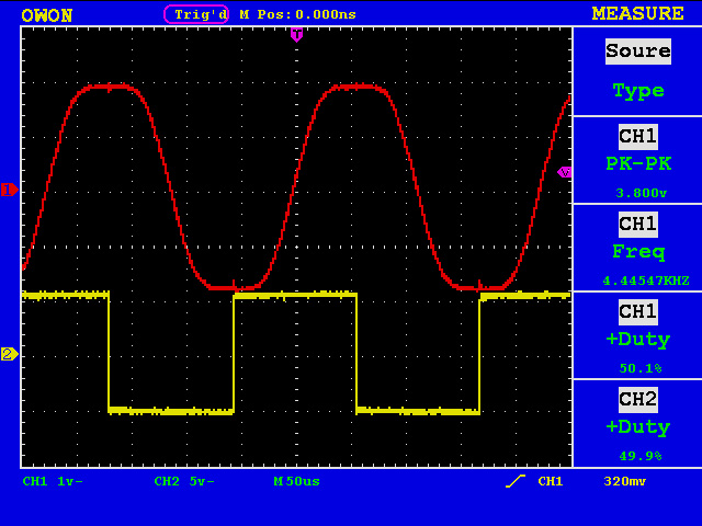

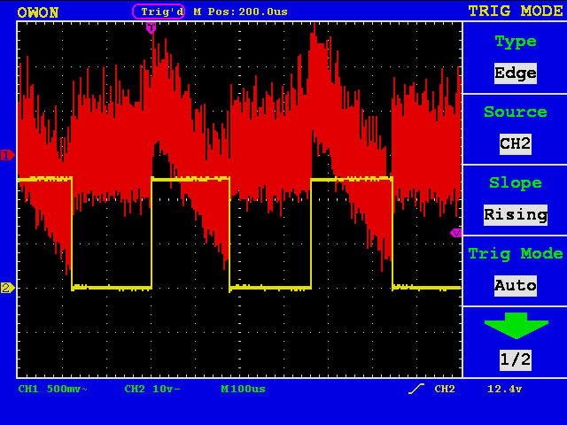

It is the frequency that's jumping around. I've attached scope shots at 10V and 25V.
At 25V the sine has lots of noise. The frequency of both is jumping around on both, although that is hard to see from the scope still.

Even at 10V the sine wave is being clipped.?
I can see the change in the square wave mark/space at 25V.

Yes, clipped at 10V, but when higher volts it seems not to be clipped, but then the noise appears.

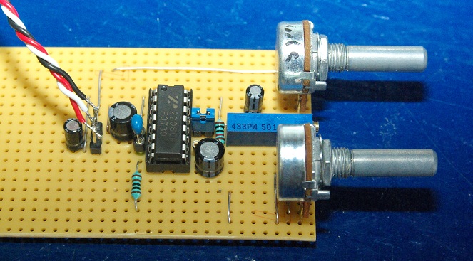

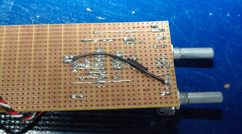

I've just made a PCB and the problem still persists! :(
See attached.

I'm using a split supply, therefore all the GND points in the diagram go to negative rail, and I use the supply GND instead of the resistor divider near pin 3. (I tried the resistor version on single supply too but same result)

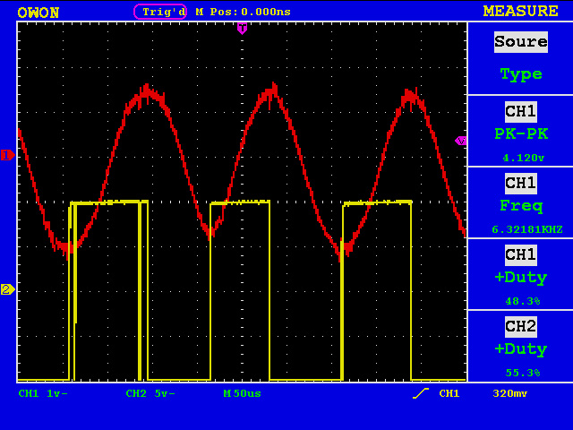

I have noticed that if I use a larger timing resistor such as 1M, the problem becomes significantly worse. Unfortunately, using a much smaller resistor does not make it better.
Tried all sorts of combinations or R & C, but can't get it to be better. I've attached a shot of the signal I measure on the timing cap (scope on AC coupling). Seems messy, is that how it should look?
