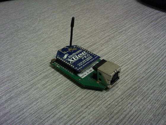

okay, I've exchanged it. But it keeps getting "garbage" i.e PORTD keeps changing outputs, and even if I didn't turn the transmitter on, it retains it's state.
How do I improve the receiving quality?
How far apart are the modules...... with any kind of aerial, they should be at least a metre away...
I ALWAYS test on a PC first.. just to be sure they are talking ( and they are setup correctly) have you downloaded X-CTU, to check they are on the same PANID ?
err you mean we have to "setup" these things through PC first? I thought's they're just like other modules?
So.... basically I have to build the FTDI-wired-to-the-Xbee circuit first to configure it, is it?
Thanks dude...
Also, you mean we have to "setup" these things through PC first? I thought's they're just like other modules?
Basically I have to build the FTDI-wired-to-the-Xbee circuit first to configure it, is it?
Thanks Ian.
I bought one of these
All I know is that the X-CTU detects what software is on the module (there is quite a few versions) and lets you make a pair.. You set up the speed (baud) and then put them on the same PANID.. then you can tell them which module to talk to.... Download the manual and have a read. These things do a whole lot more.
