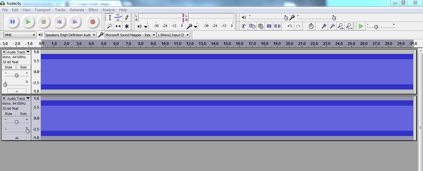

I can tell you what is feeding this 'scope:
In audacity, I have two mono tracks, one with 1000hz sine, the other with 1001hz sine. The 1000hz sine has the balance slider pulled to the left only, and the 1001hz sine has the balance slider pulled to the right (as in the picture). Could it be that there is some other in-phase noise coming through on the silent channels of each track?

Yes, I'm only selecting & generating sine waves in audacity. As I always thought, I'm sure audacity isn't designed to generate 'scope test signals.

This is my configuration:
With 'scope in X-Y mode...
Audacity signal LEFT channel = 'scope channel #1, "X"
Audacity signal RIGHT channel = 'scope channel #2, "Y"
