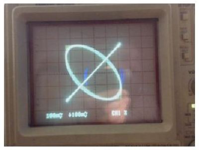

I have a Tek 2445A, into which I am feeding two sine waves; 1000hz X, 1002hz Y. When I feed them and observe in X-Y mode, as well as the pretty rotating circle, I have an intense diagonal line, heading from bottom-left to top-right:
I know this must be something mega simple, but this 'scope is SO new to me, with so many knobs and doo-dahs... help?
Thank you :)
Could you post a photo?
Done (edited OP)
Thanks!
I have seen that before, I just can't remember the circumstances. What are you using to generate the sine waves?
Well the diagonal line would show up if the sine waves were equal in frequency. The rotating circle happens when they're not in sync (frequency differences). It looks like you're at just that point where it's close enough to show the line but different enough to display the rotating circle....

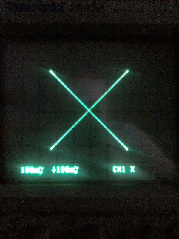

What happens if you play a 1khz sine wave through through both channels? Do you see just the straight line?
No, I see a cross
No, I see a cross
Really? Photo please ;)
That makes me think there is another signal that shouldn't be there. Perhaps it's picking up mains hum on both channels? Are you using actual probes, or just headphone wires? You're probably getting some interference from somewhere else.

Okay, so I had the "invert" mode on... oops - with invert off again, I get the single diag line when putting the same freq in both channels, but when putting the frequencies in that are listed in the OP, for the circle, the line re-appears...
Yep, it seems to me two of your signals are equal frequency and in the same phase, but you have another mystery signal of the same frequency but 180 degrees out of phase. That's the only thing I can think of that would give you that X .
Haha yup, that would explain the backwards diagonal line.
Still not sure why you're getting a diagonal line AND a rotating circle though. What are your scope knobs set to? (hint: A photo would be great here as well :p)

Looking at your controls do you have Add selected in the vertical mode? If yes, turn add off and just use the X, Y mode.
