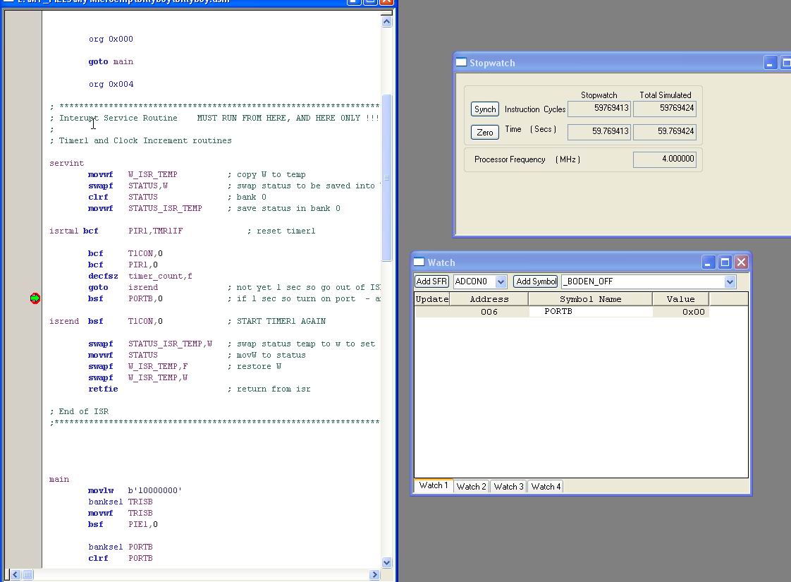

Hi Again,
Was rushing around when I pointed you to that manual, those examples are not the best for using the Interrupt system.
The attached file uses your code but the main loop just sits there waiting for timer1 to Interrupt and then turn on PortB.
Normally the main loop would be busy doing other things while timer 1 and the ISR take care of each other.
Have a look at the code - one thing , do not use a goto or call to go out of the ISR routine or it will get lost, keep your ISR code tight and short, set flags to do more complex things in the main program loop.

hi Wp100
thanks so much..I have it all working it now....I really appreciate you replying in the midst of your busyness...Thanks:):):):):):)
