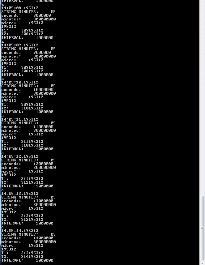

Alright, here is the same C program to receive the serial data, but i changed the Arduino code like I said i would. I used a compare timer, and here are the results.
This is the C program that uses "now" lol. Surprising results coz i read, and even as misterT mentioned, stopwatch is the way to go for such a thing.
Did a test earlier, but didn't have time to post it, got a bit busy.
Again, ignore the nonsense, and look at the interval. I set it for 1Hz

Results are currently good. I will try some more tests working the a higher freq, and increasing the bps. Hopefully the results will be good as well :)
Why all the records are exactly the same? Even all the T1 and T2 values are identical.. do you have a bug in your code?
EDIT: Sorry, my mistake. The numbers are not identical. The change is only one digit because the timing is so accurate. Hard to spot the changing digit. That is why I first thought they are identical :)
Well, it seems, the pc has reached its limits when it comes to even reasonably accurate microsecond timing of events.
My pc can't handle anything above 10Hz! the deviation in time between each pulse at 10Hz is too much.
