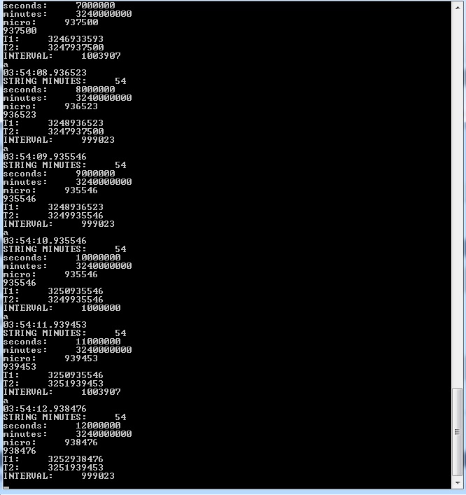

I wrote a little program for the arduino which sends out the letter "a" to the pc at 1000 ms intervals.
I've been fooling around with c#, and i made a little program that reads the serial port and displays the time interval between pulses, coz i wanted to check the accuracy.
the results aren't good. the interval is constantly changing.
Ignore all the nonsense and only bother to look at the line that says "INTERVAL:"
This could be due to a the pc timer generating the microsecond timestamp not being accurate, and then it could the arduino coz i used delay(1000) in the program. Tomorrow i will write the program with OVF timer or COMP timer and see how much better my accuracy becomes and will help me to deduce what is causing the non-constant time interval
The "PC timer" is really not that good for accurate timing. Are you using the "System.Diagnostics.StopWatch" or "System.Timers.Timer"? You should be using the diagnostics StopWatch.
For very accurate timing you can use Win32 multimedia timer. But, for this purpose I don't think it is worth the effort. I think the rs232 communication also introduces jitter when the received byte passes through all the drivers, operating system stuff and .Net runtime environment.

Actually, I'm just using "string dt = DateTime.Now.ToString("HH:mm:ss.ffffff");" . But you're right, I was doing some reading, and the stopwatch has good accuracy. I'm gonna write the arduino code to help reduce my error in timing from that side, and give stopwatch a go. Hopefully it'll yield good results.

Ok, yeah. You picked probably the worst method for timing in C#.
I have not used much Arduino IDE. Bad thing about it is that it hides much of the details. For accurate timing (in microcontroller) you should use Timer interrupts.
