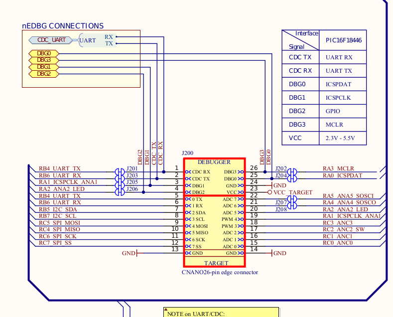

Well I figured whats happening here the nEDBG acts as a Virtual COM Port is holding the 16f18446 in reset.
waiting on I guess the dtr to toggle
You don't want it to toggle... You only want it to toggle when updating, when used as CDC you put a cap on the reset to STOP the toggle..
This not a arduino
there no pin hooked to the reset
The sam needs a in stoftware DTR toggle to tell it you want use the Virtual COM Port
What happens is it holding the 16f18446 if you use usb serial adapter it send the right data out the pin
but if you open the com port the Virtual COM Port is using it stops the 16f18446 dead
Hang up and the usb serial adapter start working agin
I put a cap on mclr that stopped the serial ttyACM0 from working there is no DTR from samd21

Can I confirm that you where you put the cap? mclr to 0v?

I have spotted the restart of the terminal reset the ports, or, changing the baud rate... this is not the norm for a Microchip product (see Xpress Board 16f18855) and I have told them the new norm is a bad norm.
I've tried it both ways it stops the 16f18446 remove the cap and it works with a usb adapter i have
But nothing with the CDC serial But I did find something elase the VCC dosen't have 3.3 volts on it there is nothing.
Ive tried it both ways it stops the 16f18446 remove the cap and it works with a usb adapter i have
Being dim here. Both ways? and, both ways stop the 16f188446?
''it works with a usb adapter i have ' means ... if you use PPS to set the 16f18446 then you can use an external usb adapter ok? At the moment this does seems the only stable method to serially communicate.

Can you check this. I have three boards and I have just checked. All are ok. I have one board on test for the i2c bug and that is providing 3.3v pullup voltage so I am sure this is ok. The vvc I am referring to is 4th pin on right hand side in section 1.2 of the **broken link removed**.

If you check the com ports shows up if you try to open a terminal it stop's the 16f18446 from work you can no longer see data showing up on the TX pin.
I tried a cap from mclr to ground and to vdd. Both stop the 16f18446 from sending any data.
Then I checked the VCC pin it has no voltage.
So now I'm looking to see why I have not used the VCC pin It should read 3.3 volts
So I know I didn't kill the regulator or something. I have not used the pin I just tested it. there is nothing on it.
I had no problem with the 16f18855 board I have.
If you check the com ports shows up if you try to open a terminal it stop's the 16f18446 from work you can no longer see data showing up on the TX pin. Checking. The 'com ports' is the USB/CDC Virtual Com Port (VCP) ? The experience is reported to Microchip as - if you able to get a Terminal operations when using the VCP and you reprogram then the (host) terminal software either stops communicating or the (host) terminal software displays garbage. Are you saying the 16f18466 TX pin as defined by the PPS instruction on the Xpress board no longer shows data transmission, or, are you saying the ATMEL microprocessor no longer shows data transmission?
I tried a cap from mclr to ground and to vdd. Both stop the 16f18446 from sending any data. OK
