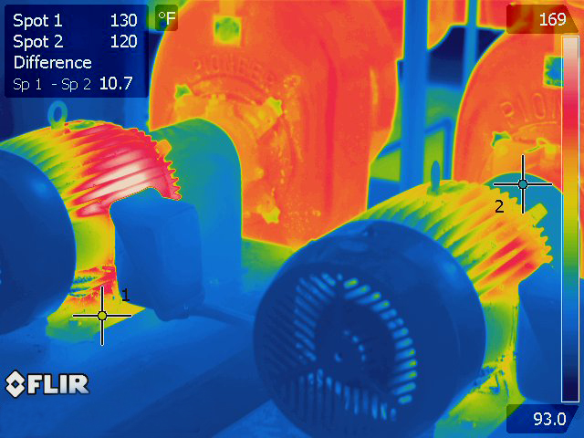

You need images with clear outlines like these:
But I found that's never what I got. I'm rather surprised you can pick out the flange butt up against the casing and especially that you can read the text "PIONEER". You need a camera that can pick out outines like that in things that are in physical contact. Otherwise, cheaper alternatives are just as effective.
