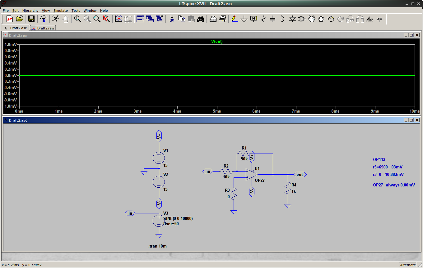

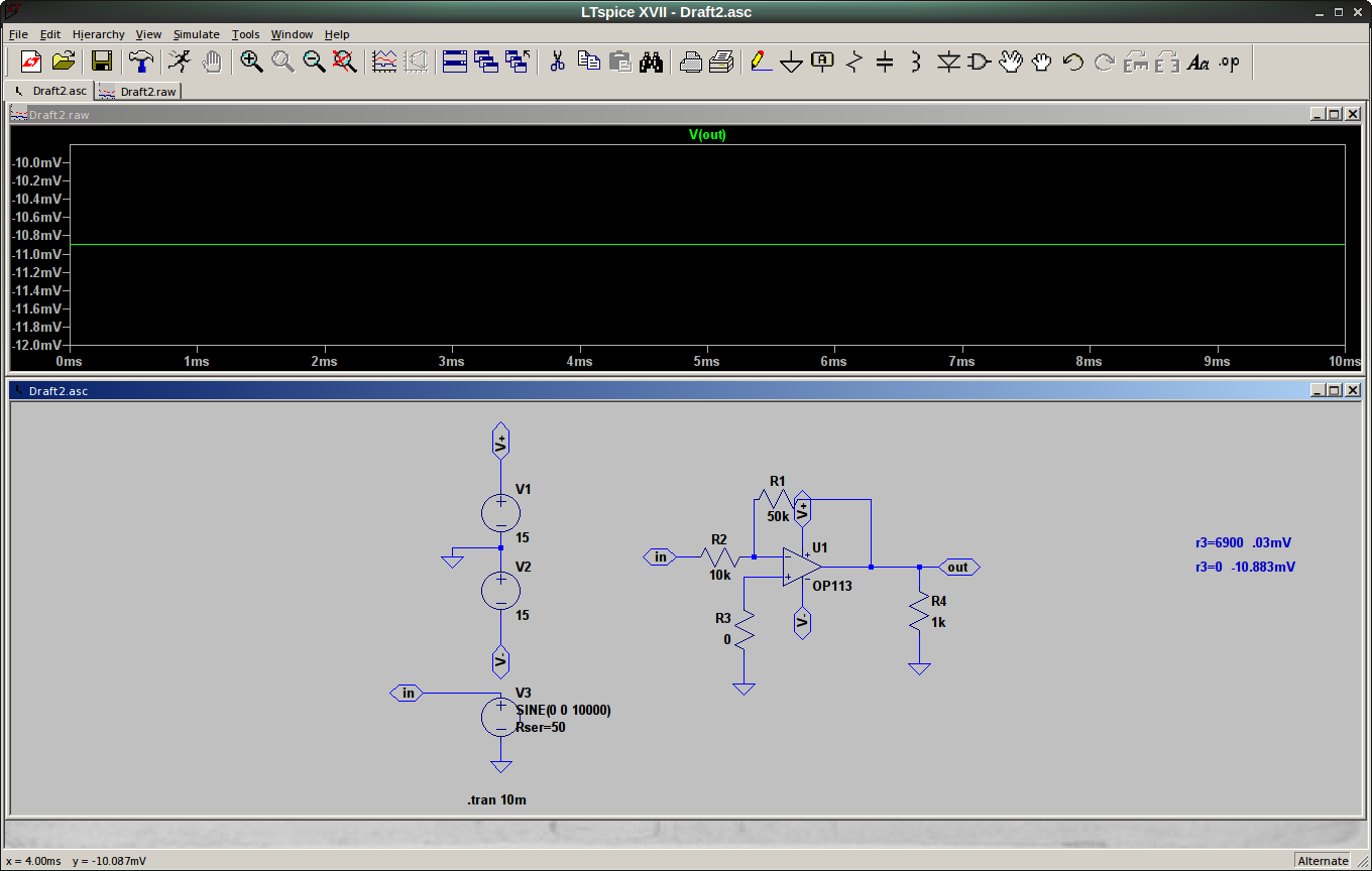

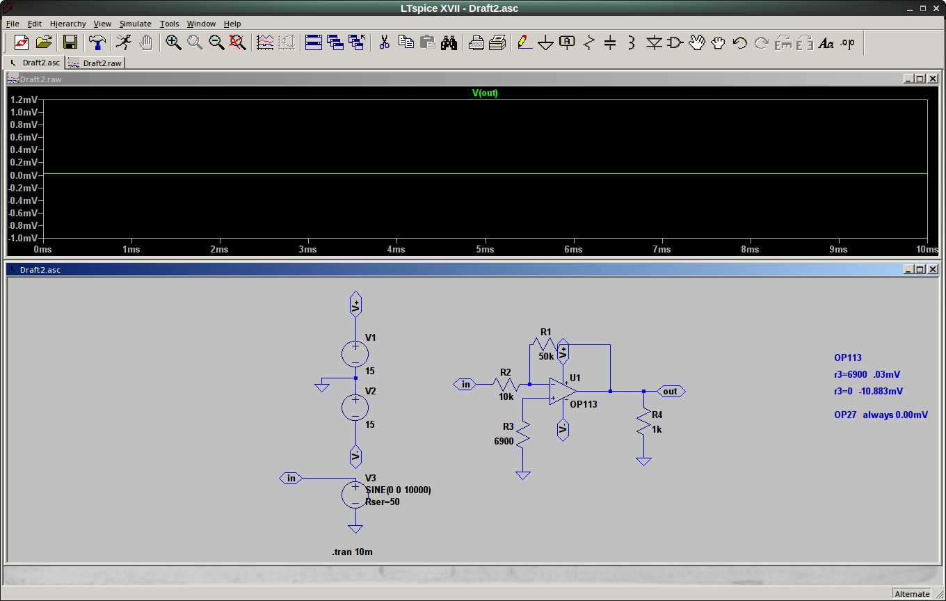

ok, so here's some info you might find useful, not only does it demonstrate how the input balancing technique works, but also what happens when you use an op amp that auto-nulls.
this is an OP113 which is a general purpose op amp. notice the DC offset when R3 = 0. this is due to the same value input currents creating different voltages across differing resistances.
this is the OP113 with R3 = 6.9k. notice the offset is now 0.03mV this result required trial and error, placing different values of R3 until the result was less than a millivolt. this type of nulling could use a potentiometer or resistance decade switch and "DFT" (Determined at Final Test) placement of trimmer resistors if it were being made in a production environment.
this is an OP27 which auto nulls, and that changing R3 has no effect on the offset.
