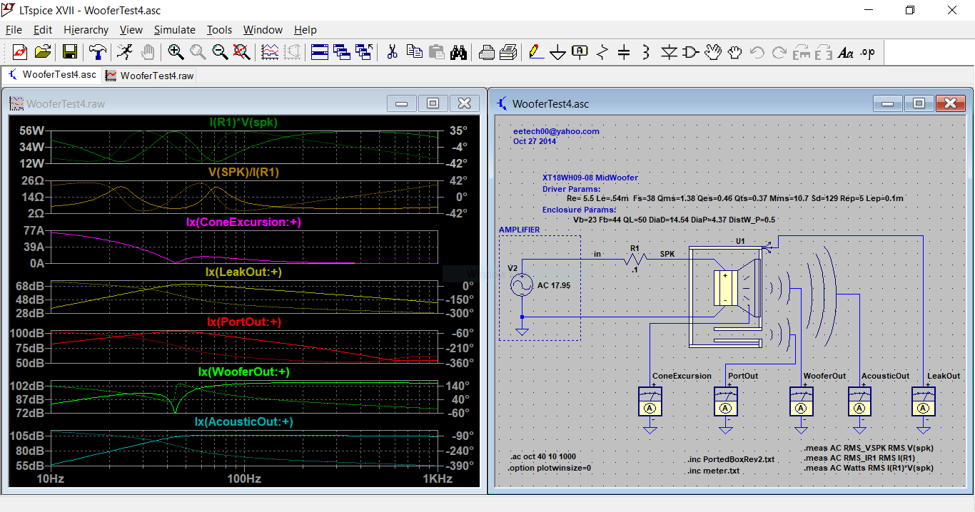

A request was made if I could share the simulation files for a Woofer simulation I posted a couple years ago.:eek:
Anyway...I'm posting them for anyone who is interested. Have fun.
  • FinalSpeakerTest.zip
You forgot to say its size so I looked it up. This woofer is 7" in diameter.
The Vifa spec's are on their website and at Madisound. Don't you trust their spec's that are the same as your results?
