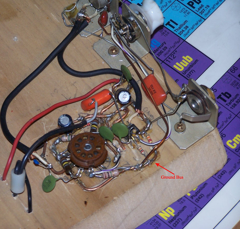

I made this breadboard on Maple.
breadboard-jpg.28762
Nice.
So how did you fasten stuff to the breadboard? Can't see any screws or nails. It looks like you chiseled or routed out channels for the wiring.
Nice.
That's exactly what I did. I used a dremel minirouter for the groundbus and glued it in. The ground bus made the support for the rest.
