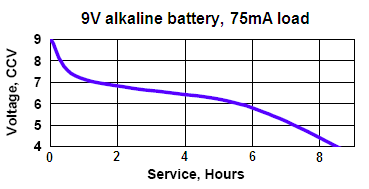

A 9V alkaline battery has 6 tiny skinny AAAA cells inside so it doesn't have much capacity.
8 LEDs connected with 2 in series and in series with a current-limiting resistor as shown with 18mA per string has a total current of 72mA.
Go to a battery manufacturer's website to see the datasheet for a 9V alkaline battery. Energizer shows that with 75mA, a 9V alkaline battery voltage drops to 7V in about 1 hour.
The white LEDs will dim during the hour then not light anymore. The red LEDs will dim slower and not light after about 8 hours.

Thanks for the calculators they help alot. What can I do for a power supply that will last? I am really limited on space for a battery pack. Right now I have a 2-AA side by side holder and it just barely fits without interfering with any of the moving parts. Also, is there any chance that any of this could interfere with the radio controls?
