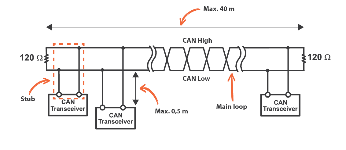

You have just re-invented the CAN concept, Dan!
That is exactly what you have with that, 12V power and a thin data bus connection through dozens of different devices.
It's even brought out to the OBDII diagnostic sockets, on vehicles that support that setup:
Only 1/2 a Meter? I guess that's twisted pair from the coax. The coax could probably be plenty long. Oh I see it's 40 meters. I am just wondering, what it takes to interface to it for example input and output devices.
A number of PIC's include CAN interfacers, no doubt there are application notes at MicroChip.
No coax, it's a just a loosely twisted pair of wires for moderate distances such as within vehicles, thought it may be shielded for industrial applications between different pieces of equipment.
You can get single chip "dumb" i/o expanders with configurable digital and analog / pwm inputs and outputs, eg.
A lot of the higher end PIC MCUs have CAN included, I've used it in some of my designs.
They can work as controllers, peripherals or both,
There is also a CAN controller that works as an SPI peripheral, with PICs or such as Raspberry Pi etc.
The basic idea of a simple CAN system is that every device broadcasts it's readings or whatever, with the unit address saying what that reading relates to - temperature, engine revs, throttle position or whatever.
Any other device that needs any info from any specific sensor just listens for packets from the appropriate addresses.
The CAN interface has facilities for "masks" that allow groups of addresses to be ignored so devices don't have to process irrelevant data.
And of course command data can be sent to specific addresses.
