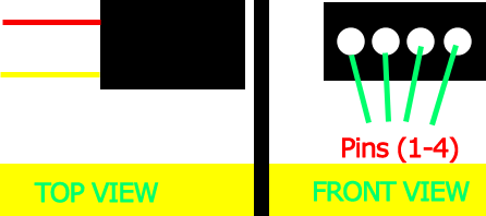

The motor has a black 4 pin plug attached to it, going into this plug (from the motor) are two wires, red and yellow.
If i connect the first pin and the last pin, the motor spins quickly.
If i connect the last pin and the pin next to it, the motor turns slowly and in reverse direction.
Does this help?
thanks

Yes, you can't turn it because of the internal gearbox - you should be connecting it so it runs fast, that's probably a direct connection to the motor. Usually one of the motor connections will be connected to the metal body of the motor, that should be the negative connection.

Okay, 4 wires... You have 2 speeds, there is a 'Home' sensor so it doesn't stop in the middle of the windshield (windscreen), not sure if its one or two wires, almost all automotive ground to chasis. The gearhead in the one I took apart many years ago had a worm gear, so gotta go with the on direction deal. Put (-) to the case, and 2 of the 4 wires should make it go...
Since it got hot enough to mention, guessing very hot. I'd open the gear head and see if there is damage, and just to make sure its well greased after the melt. Makes a big difference...
