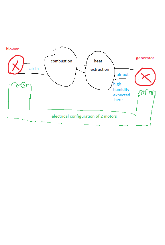

i dont think you were off anytime guys,
I do want a blower that is going to push air in at the input,
I just so happen to coincidentally acquired this little guy:
https://www.robotshop.com/ca/en/12v-16cfm-33mm-blower-fan.html
but i also want a generator too at the air output
just like in a jet engine ... the generator speeds up the blower using the additional forced air from combustion
although my stove will not be using high power combustion like a jet, i will only be using convection forces from a slow burn.
my concern is matching a generator to the blower since i am coupling with magnetic fields(of the bldc) instead of the conventional drive shaft
How? Are you proposing to use electrical power from the generator to boost the electrical input of the blower motor? That's the sort of thing the over-unity crowd attempt.
The generator would actually block part of the air flow from the blower.
It sounds like that but he's just describing it poorly.
He wants to basically have a turbocharger in his stove, harness the energy in the exhaust pressure to increase airflow into the stove to improve it's efficiency or performance.
alec - I don't think this is an over-unity project, just a way of building a forced-air stove without the need for external power. Any additional energy would come from the burning.
I think I see what you're getting at, but I'm not sure it will work. There might be better ways to extract energy from the fire.
Do you want to just get enough energy to power the blower, or are you hoping to extract extra energy for an external load?
I'm not sure it will work either, especially if you are trying to convert the exhaust pressure to electricity and then use that to electricity to turn the fan. At such low airflows, the generator is going to have crap efficiency and then there's another efficiency loss when the electricity gets converted back into mechanical motion to turn the compressor fan which is also going to have crap efficiency for the same reason (there's not enough power available to turn it quickly). Can you even get anywhere near 10% efficiency in either the generation or motoring stages at the low RPM that I imagine convection airflow would be capable of?

lol im not sure! what is the relationship between a jet compressor and turbine?
by how i read the answer is yes, just enough
the excess heat energy will be mostly dumped into thermal masses,
i could try conventional mechanical driveshaft but those are trickier for me to pull off ..... plus then i need additional blower for startup and cold drafts .. if i could convert to electrical i can also think of regulation and braking circuitry.
... i wouldn't mind using a small power supply to kick start things if that helps.
Then why not attach several Peltier elements to the flue pipe? But in the end there is no free lunch or energy for that matter. Anyheat you take from the flue, will probably increase the creasote build up in the chimney increasing the risk of a chimney fire. And those are very scary.
Any increase in the speed of the gases coming from the flue like the proposed "jet engine" I can't see happening with solid fuel in the combustion chamber of the burner and then where are the compressor fans that a jet engine uses to make it's thrust?
