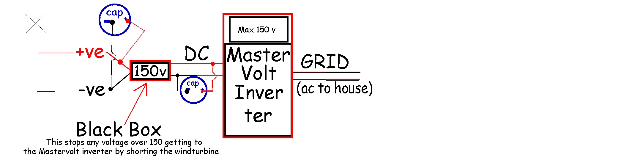

I have a wind turbine which runs most of the time below 150 volts, connected to a windmaster inverter, which is grid tied. The windmaster is limited to 150 volts, so I have a device which shorts out the turbine when 150 volts is reached - this activates the break to slow the turbine.
I was thinking of another solution.
Voltage dividers exist, I am using one to log the voltage generated by dividing the voltage by 10 because my data logger was designed for a 24 volt system, not 150 volts.
How easy would it be to build a device that when the voltage reaches 145 volts, it 'adds' in a circuit that acts as a voltage divider, taking off say 30 volts from the circut, so that the break device does not activate. If the wind speed ever got to the point when it procuced 180 volts, then the break device would get its 150 volts and activate the wind turbine break.

You want continuity to 150v and a voltage limiter after that.
Assuming smooth DC at first, the equivalent circuit would be a 150v Zener with a dropping resistor that varies from zero up to whatever is necessary to dissipate the extra power.
One way is to have a comparator that senses the 150v and switches in series resistors using one or more relays.

The upper voltage is supposed to be 240v DC. I got this by running the turbine against a car tire simulating the max RMP the turbine goes before it turns on its own breaks.
Thus far in all my logging, I have seen a single spike of 205 volts but the highest 'normal' value of the turbine when running during a storm was 180 volts, then the tail caused it to furl - ie the electronic break did not kick in, the tail furled the turbine way before the electronic breaker value.
Electronically, the final component in my circut, just before the actual inverter is this 150V limiting switch. It was designed to stop anything over 150V hitting the inverter, so I can continue to use that as my safety switch, and work the balance of the electronics to suit the 80% of the cases.
So it is possible to 'dump' voltage into a thing like a 24v water heater? I can get one of those. So when the electronics senses 145 volts, it opens a gate for the voltage to get dumped into this 24 volt water heater...?

The current circut is simple and shown in the following picture.
A soon to be made change will insert two capacitors into the feed, one before and one after the 'Black Box' to try and smooth the 'saw-tooth' sine wave DC voltage into a smoother current, as the Mastervolt is more efficient when it has smooth voltage.

Do you have any information on the circuit that operates the brake?
No information at all. I do know - by tracing their inverter wiring - that turning on the switch called 'Wind Break' disconnects the inverter from the DC input ( opens a relay ) and then almost immediately it shorts the two DC input wires via a second relay.
When this break is applied the turbine is very stiff to turn, and slows down dramatically in good wind and stops completely in average wind.
I have tested this myself, holding the DC wires in hand. The turbine spins and touching the two wires together brings it to a halt. The 'Black Box' was a device I bough off the internet. It shorts the two input wires at about 149 volts, and this causes the turbine to slow down. The output wires from the black box drop directly to zero volts when this occurs. It holds this short for about 8 seconds, then releases the short, allowing the turbine to start turning again.

This alternate diagram would be able to replace the 'Black Box', as it does the same function! Except in place of shorting the turbine, it actually does something usefull with the current...
Shorting a generator provides dynamic braking. I think this is set up this way to prevent damage to the turbine. Sounds like we can't take advantage of high wind speeds.
