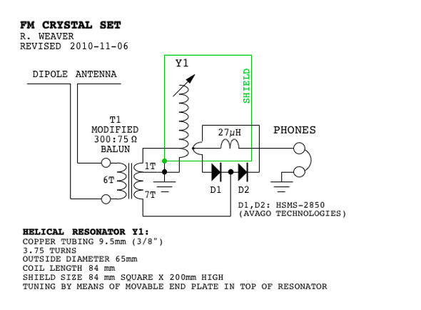

It is also possible to build a true FM detector using two diodes and a 90￾0„3￾0Š0 phase shift arrangement to make a quadrature detector. I built one a few years ago with a helical resonator (unloaded Q of about 2000, and loaded Q of about 500).
It works quite well picking up all the local stations with an indoor dipole antenna. I did a detailed writeup on it:
Another nice work! But I am little unfamiliar with matching BalUns! Also there are lots of coils you arranged them in a box, looks complicated :)

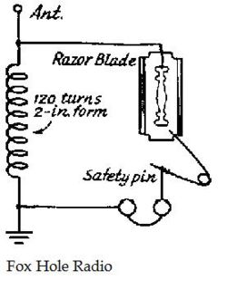

I found a unique radio called- Foxhole Radio (lots of foxhole). Designer used a blade and safty pin instead of point contact germanium diode.
At first, I laughed and now I am thinking that it is not hard to make Point contact germenium diode. :) But I don't know what is actually it! Looks amazing! Thinking that how these type of radio can work!

hi Willen,
Look up 'Cats whisker radio'.
https://www.google.co.uk/search?q=c...s=org.mozilla:en-US:official&client=firefox-a
We used to make transistors using two pieces of razor blade and a half of a diode, all mounted on a bottle cork,,, gain of about 3!
hahaha within few days, I am being mad on ancient electronics because of its simplicity! How shocking they were! But I am not familier with Galena crystal and with its equivalent minerals to build Cat's whisker radio :(
Now I knew that how Germenium diode were invented. The Germenium diode has not been changed till now anymore. It looks like detector stage of cat's whisker detector; has spring wire (whisker) pointed on Germenium Wow!
I am too much excited listening about your blade's transistor which had gain of 3! Wow! I cannot think that I can make a transistor myself! Do you have any schematics, guides or links of your work or others?

If any dissimilar metal act as as AM detector then fox hole radio (with razor blade and safety pin) might act as nice AM radio! Wow!
