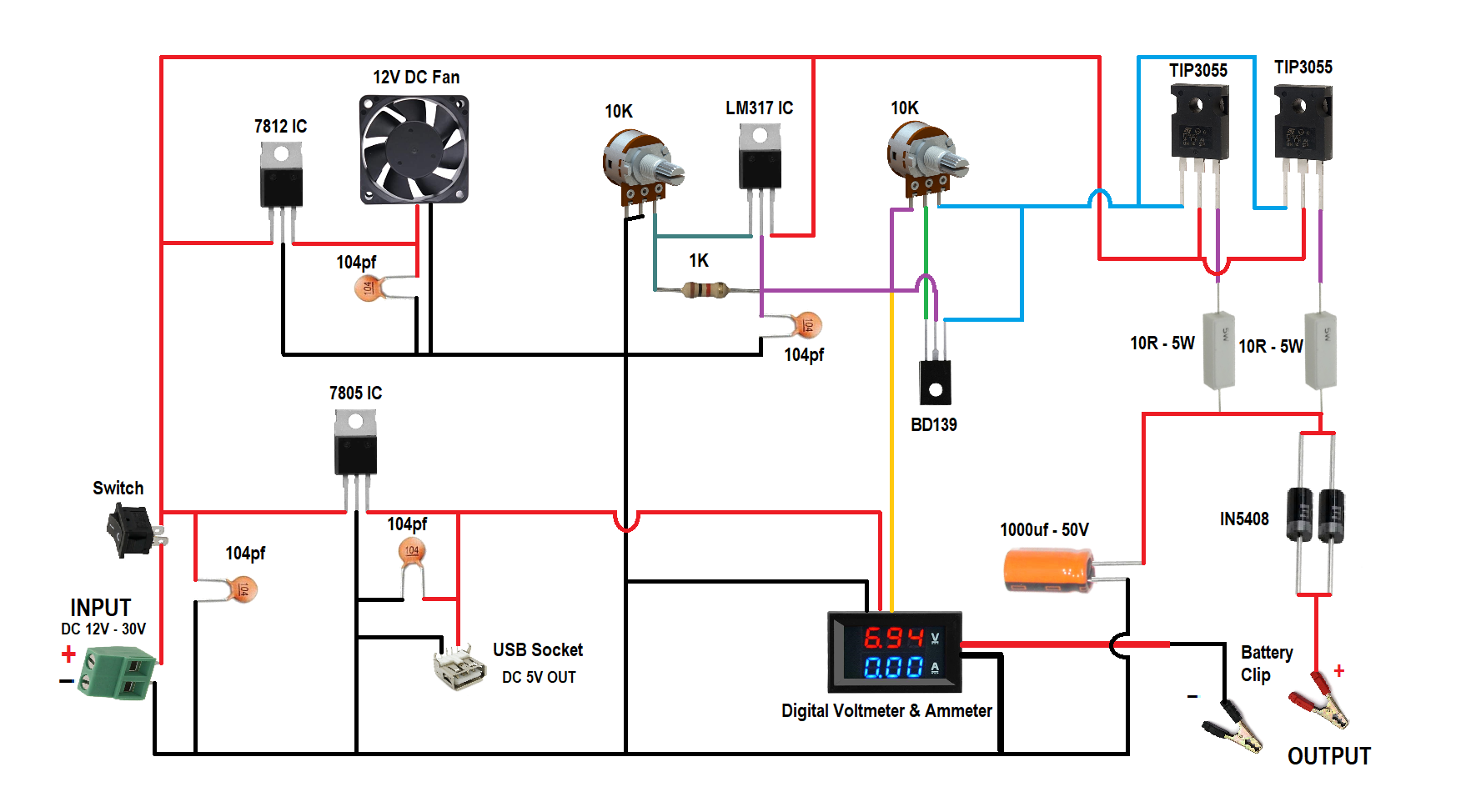

I wanna make a LAB BENCH POWER SUPPLY using LM317 with CV & CC
Can anyone plz inform me how this circuit current limiting function work? It says it can limit current 0 - 10A. As I'm a student I don't know actually will this circuit can limit current or not. It will be helpful if you kindly let me know

Everything in that circuit looks like it would be correct.
Hey this circuit works. CV has coarse adjustment and I know how to do fine CV adjustment. But can you help me to do fine CC adjustment? CC adjust coarse ( I tried 1A load using lamp, then adjust CC knob it shows : 1A , 700mA, 500mA, 200mA then 0) but how can I do fine CC adjustment ?
The current circuit is plain weird..
It has no actual sensing across the series power resistors, and the voltage regulation does not allow for the voltage drop across those so the output voltage is not actually stabilised, or the true output being displayed on the meter.

Having looked at that bizarre circuit of a power supply, I believe that it was intended as a (rude) battery charger.
There are diodes on the +ve output connection, those diodes are not inside a feedback loop to give a "constant voltage" function.
The two current sharing resistors on the emitters of the TIP3055 transistors are not inside a feedback loop to give a "constant voltage" function.
There is no obvious current sensing of the output current to give a current limit function.
To me this appears to be a bad circuit, dump it and find a better one.
Sonce none of the pins on any of the parts are identified, the drawing (note: *not* schematic) is almost impossible to decipher. If you draw a actual schematic, you will see many of the problems.
Note - crossed wires do not indicate a connection; they indicate a mistake waiting to happen. Connection dots indicate connections.
