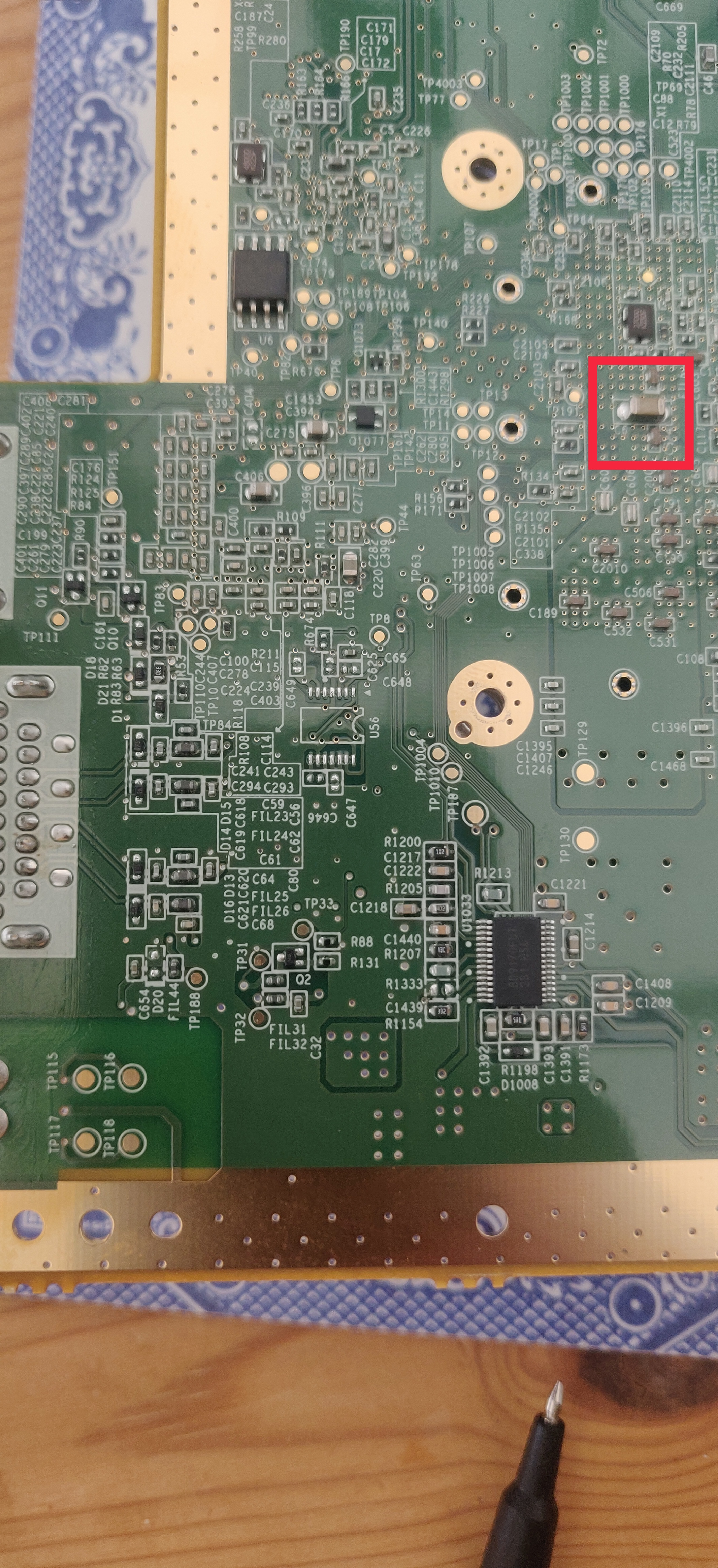

Hi, I'm very new to this sort of stuff and would like to try and repair a Wii u console just for fun really and learn new skills. I've watched alot of tronixfix on youtube alot as I found it interesting and think it's time to have ago myself.

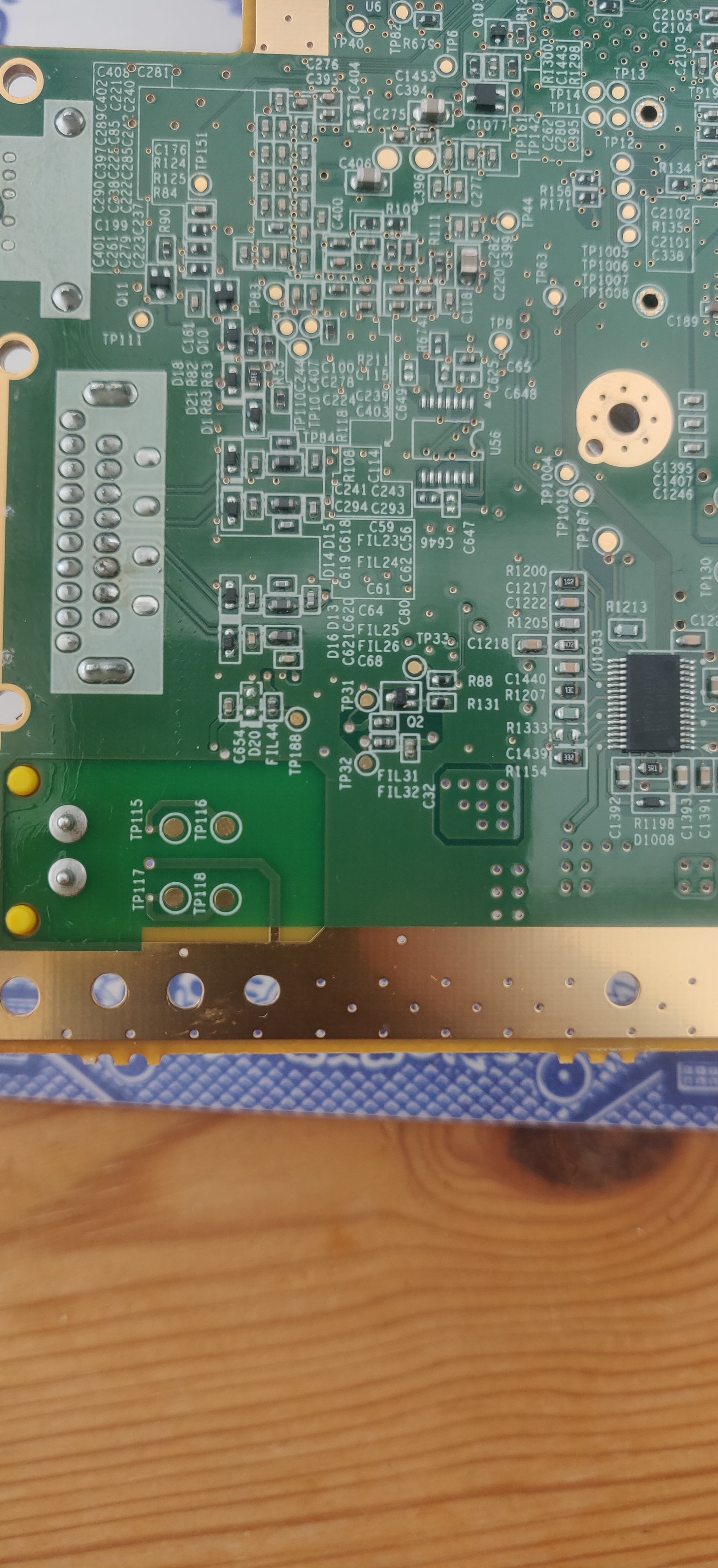

The console has been tested with a known working power supply and it's still dead. I've stripped it down the motherboard and have tested all the fuses I think. Here is where my problem is tho. I found 4 chips which I'm not to sure what they are but 2 of them beep and the other 2 don't. Here is a picture of them if anyone can identify them for me and if I'm on to something or if I'm barking up the wrong tree. The 2 on the left beep but the 2 on the right don't. Any pointers are welcome, thanks

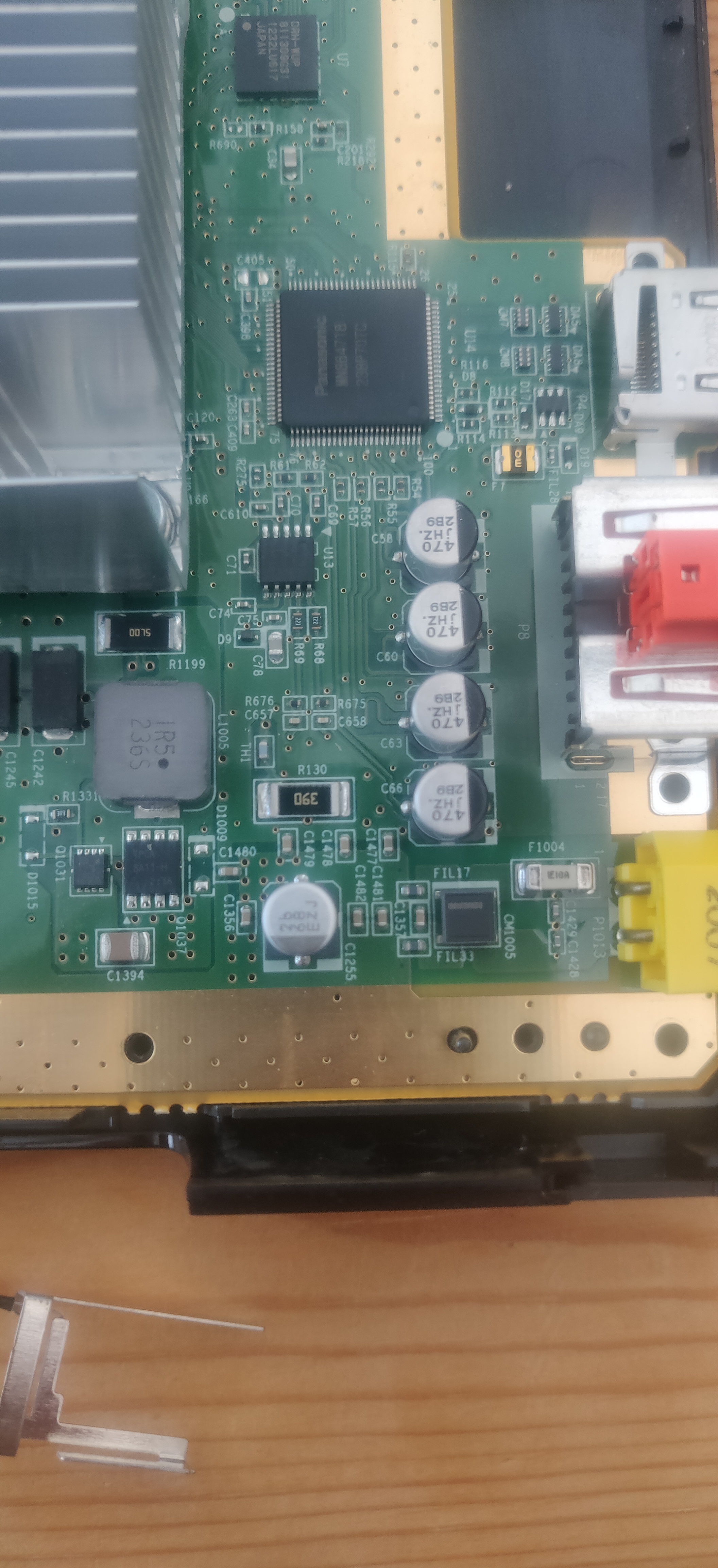

Here is a pic of where the power comes in. Any advice on where to start is welcome.

There is a fuse immediately behind the yellow connector - is that OK?
The black "chips" in the first photo are capacitors, so any readings across them will depend on what they connect to in the rest of the machine circuit.

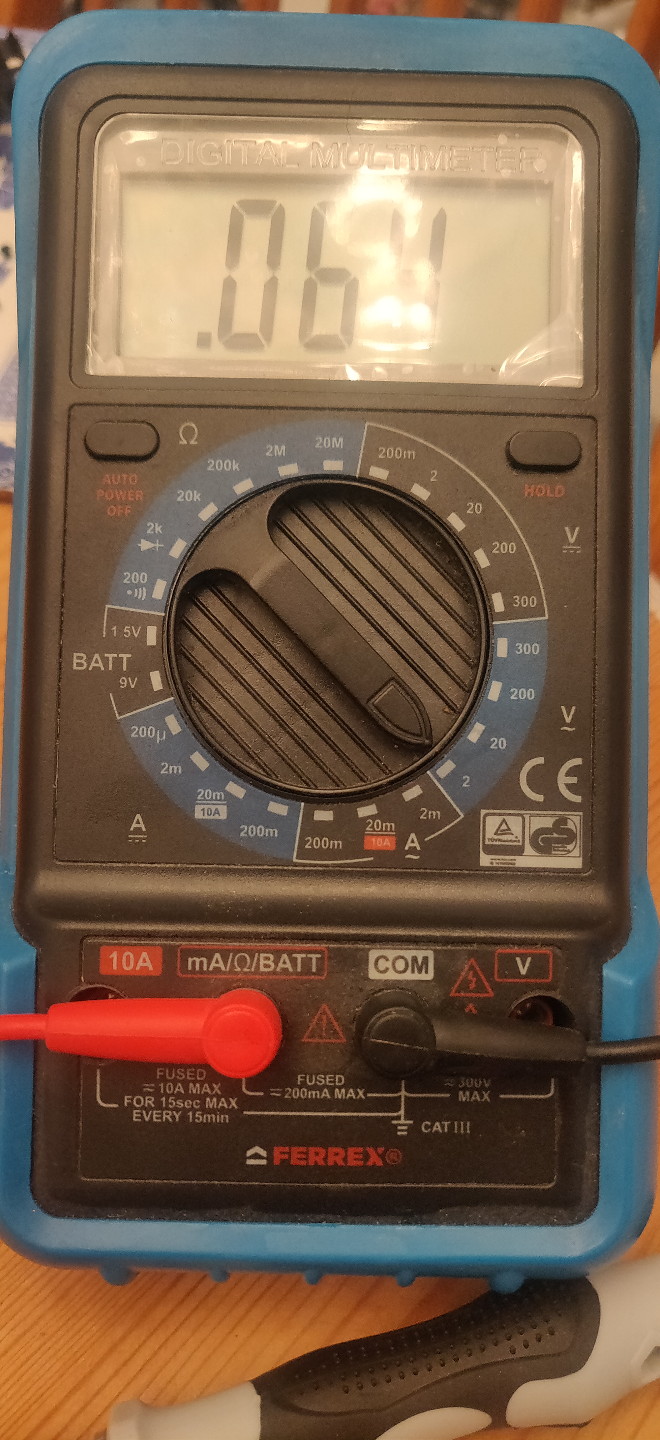

OK, with power on, what voltage is there across one of the caps to right of centre and what voltage across one left of centre (in the first photo)?
The right side probably has the power adapter voltage & left side either 5V or 12V??

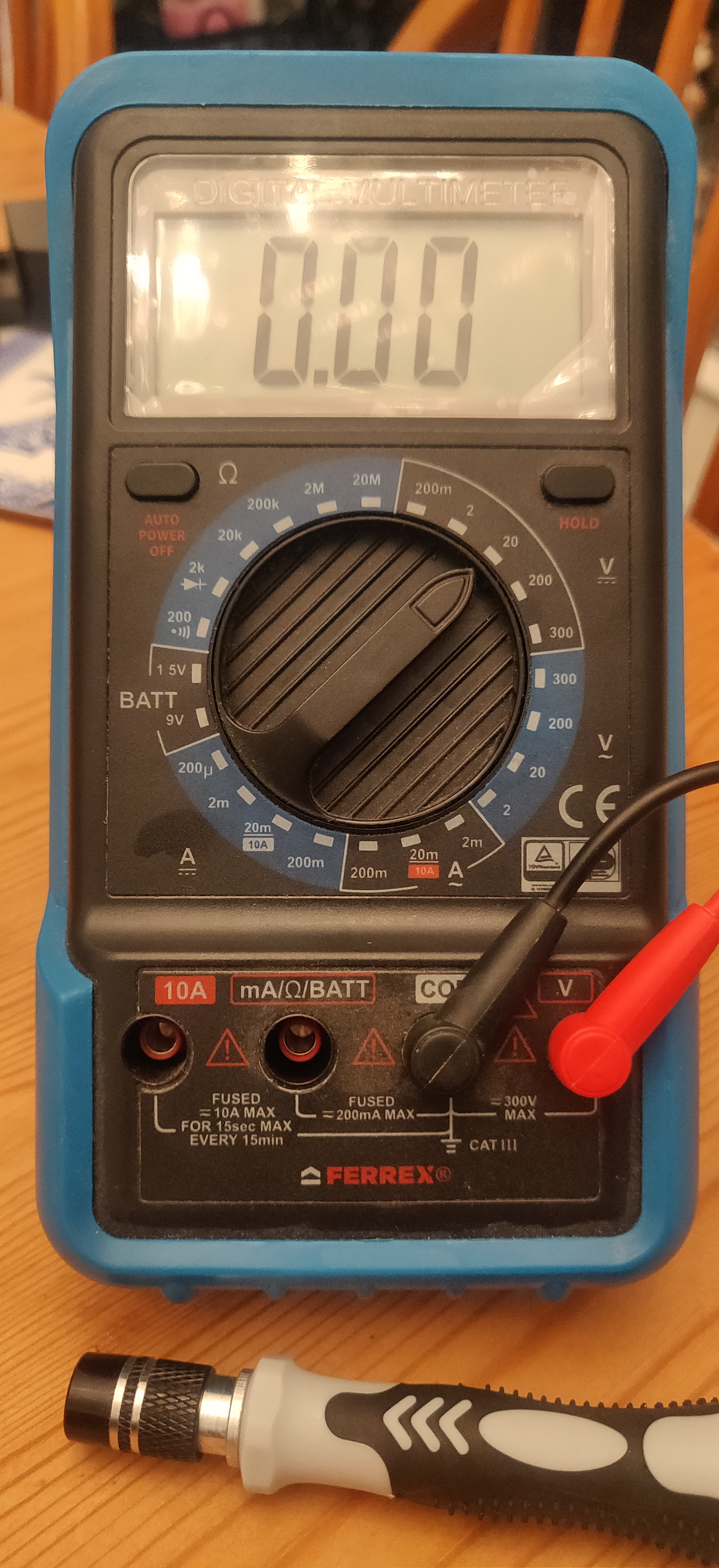

DC voltage, the 20V range (or 200V if that shows overrange); the upper right quadrant - the dotted equal sign indicates DC, the lower right with ~ is AC volts.
And make sure the test leads are in the COM(-) and V(+) sockets when measuring voltage; if you leave one in the Ohms/mA socket it may damage the meter or whatever you connect it to.
With this setting in picture. The left of centre cap has fluctuations of 0.02 to 0.05. the right of centre cap is doing the same between 0.02 and 0.07.

Looking again at the photos, it appears there are two switched-mode regulators; check for voltage across the round aluminium cap that's bottom centre in the first photo?
Put the negative lead on the metal lower edge of the PCB and test from the fuse next to the power socket and the upper terminal of that capacitor?
The fuse next to the power socket shows at 14.96 on both sides of the fuse. The upper part of the cap is also at 14.96.

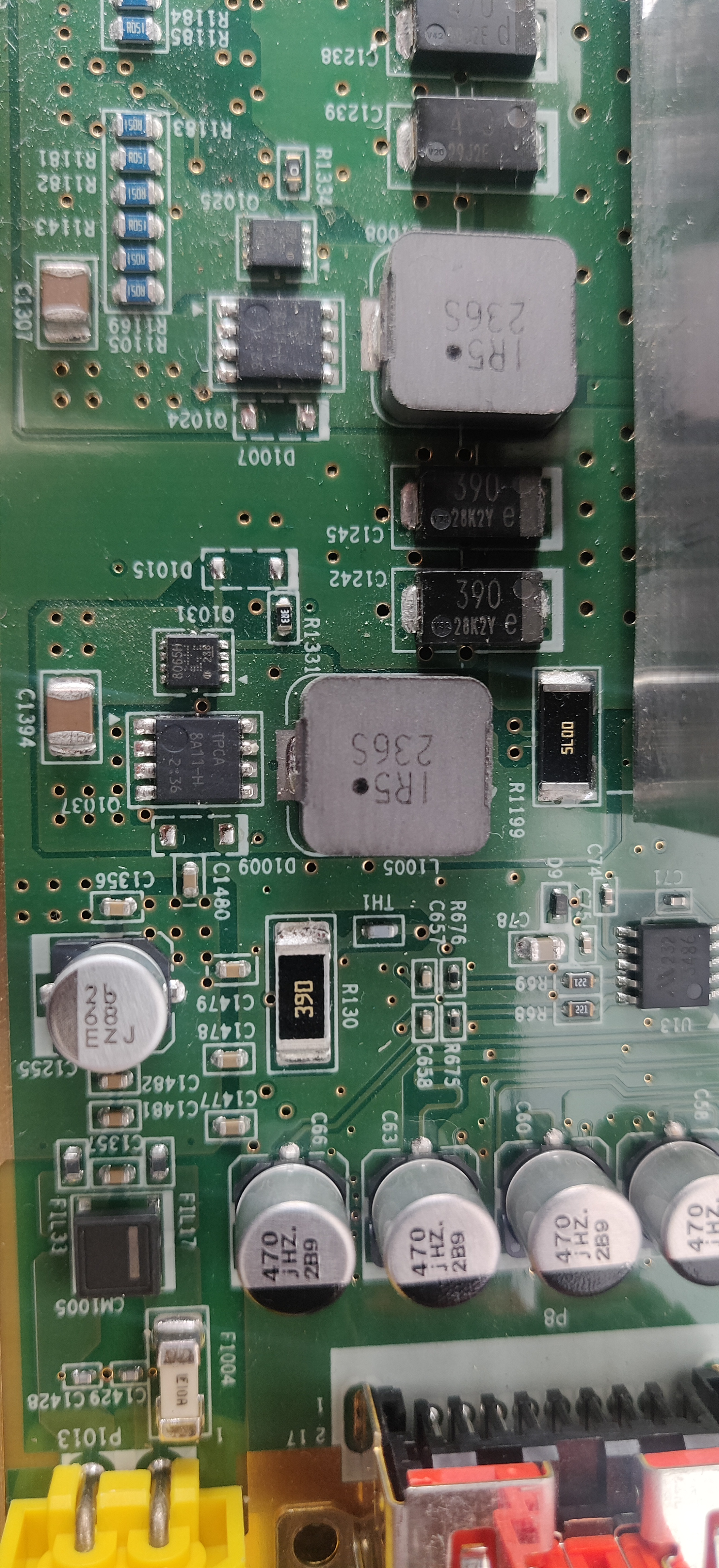

Check voltage (from ground; the metal edge) to both sides of C1394 and to the upper pins on the large 8 pin IC (actually a power FET) just above it.
Can you also take a better close-up photo of that overall area, that has the part numbers on the components clear?
Ok, C1394 is not giving a reading and the 8pin above is also not giving a reading. This seems like we've found the problem?

Don't know if this mean anything but the fuse here is beeping both ways on continuity?

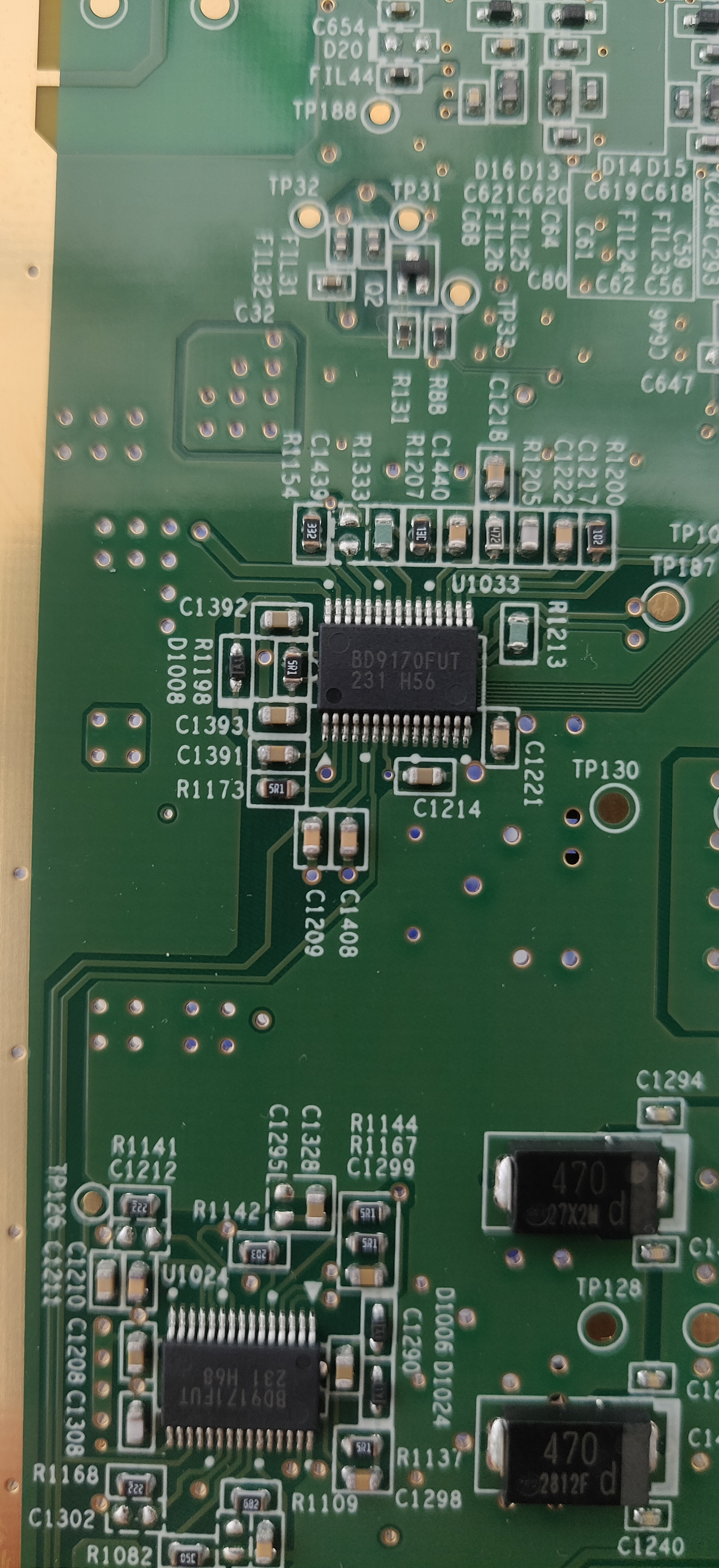

Can you get the number from IC "U103" on the underside? That is what controls the power FET.
