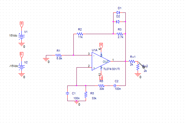

Hi ,
I want a sin-wave oscillator , when I can control frequency between 5-50 Hz and control amplitude between 1-10 volt ...
the important thing the frequency and amplitude are independent....condition (*)
so if I've change the frequency , the amplitude shouldn't be changed .
i used wien bridge oscillator same as the figure in post #2, but the condition (*) didn't done ...
i used wien bridge oscillator same as the figure in post #2...

sorry but there is problem with upload photo ,may the cause is the browser.
I used op-amp tl074 and changed the RR using a double variable resistance
when i decreasing the frequency , the amplitude decreased too.
firstly I measured the amplitude directly , then i put a voltage divider at output terminal
but in tow way if I had change the frequency , the amplitude was changing...
What did you use to measure the output amplitude?
A cheap multimeter is accurate only at 50Hz or 60Hz. It wrongly shows decreased amplitude at lower and higher frequencies. Use an oscilloscope instead.
Maybe your plus and minus power supply is not filtered well.
What is the output load?
there is no load ...
i just simulate the circuit using pspice and not apply it yet
Since the output amplitude drops as you increase the values of R and R then pspice does not know how a Wien Bridge oscillator is supposed to work.
this is my circuit
i used wien bridge oscillator same as the figure , but the condition (*) didn't done

The TL074 is a quad opamp with 4 opamps inside. How did you disable or use the other 3 opamps to prevent them from oscillating?
Your circuit is WRONG:
1) R5 and R6 should have exactly the same values and should be a dual potentiometer for frequency adjustment. Each one should have the same value series resistor at one end to limit the highest frequency.
2) R2 should be closer to 2 times the value of R1. Consider if the value of R1 is 5% high and R2 is 5% low due to tolerance.
3) It is better to use lower supply voltages instead of attenuating the output.

Hello,
Your problem seems to be that the output amplitude changes when you adjust the frequency, and/or the frequency changes when you try to adjust the amplitude. Im not sure which or both of these are happening. But what you need to show now is HOW are you changing the frequency for example? I think when you change the frequency you need to change TWO components at the same time, like the two resistors that go with the two capacitors, and also to get a wider frequency adjustment you need to switch in or out two different capacitors so you can get a totally different range.
In other words, there is more to it when you want to adjust the frequency. Let us know what you tried already and that might help.

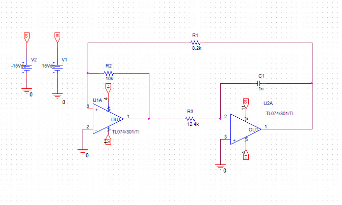

Hi ,
Thanks for your previous help :)
now , I ask you about the triangular oscillator using tl074
1. about the equations for amplitude and frequency ?
2. how the circuit work and some extra information ?
3. the oscillation' condition

U1A is a Schmitt-trigger. It has positive feedback applied with R1 and R2. The values of R1 and R2 and the supply voltage determine the input threshold voltage at the peak level of the triangle waveform.
U2A is an integrator. Its charging and discharging times are set by the values of R3 and C1.
With a plus and minus 15V supply, the maximum output of a TL07x opamp is about +12.5V and -13.5V. It can make a pretty good triangle wave up to about 20kHz, but to about 50kHz when it has a plus and minus 5V supply.
It takes time for the capacitor to charge and discharge to certain voltages on the ramps of the triangle so the output level also affects the frequency of a triangle wave generator.
The capacitor charging current is determined by the voltage level at the output of U1A in the value of R3. Pin 2 of U2A is at 0V.
Look in Google for the formulas.
so I can't get a determined value of output ?
The output level of the triangle wave is calculated during the design of the oscillator.
The frequency from this triangle wave oscillator can be higher when the output level is lower because the capacitor charges and discharges for less time.
The frequency from an opamp can also be higher when the level is lower due to its slew rate limitation.
If you want a higher frequency then the capacitor must charge and discharge faster which means the capacitor value and the resistor value that charges it must be smaller.
