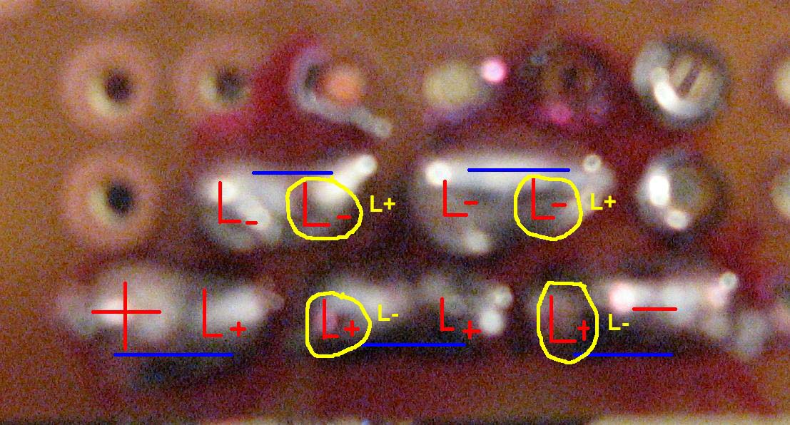

Hello I am a very, very, very non-electronic person, so I thought I could do a simple task of making a LED circuit, but I guess I was wrong. I am running this off of a 13.8V source, theres 4 blue LEDS (3.2V ea), and I have a 1/8 watt 56 ohm resistor. By all accounts this should light up I suppose but it didn't, the LEDs all were working and I can assume the resistor was as well, but when I hooked it up, nada. I assume the problem lies with my soldering since I am no expert in that area. Any ideas on how to fix this would be great! Thanks!

Ok so I resoldered everything, the blue lines are the solder, the L+ L- are the LED's. + and - are the source and ground. Still doesnt work. Did I do it wrong again?
It is not easy to tell exactly what you meant by that picture, but it looks like you have two of the LEDs wired backwards.
Reverse the two LEDs, whose connections I've circled in yellow.
