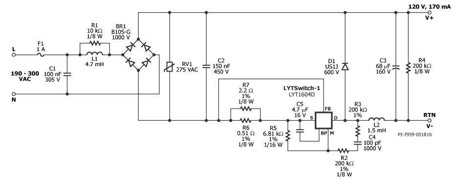

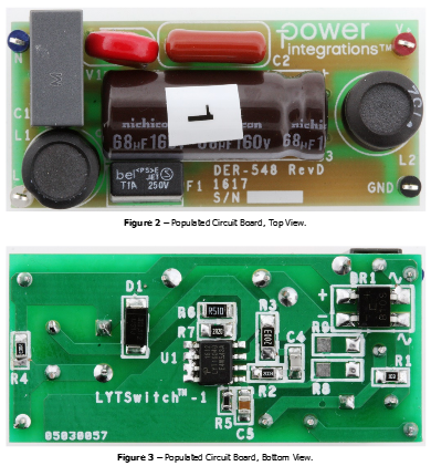

https://led-driver.power.com/sites/default/files/PDFFiles/der548.pdf
Thanks, as you allure with your “1” sticker on the electrolytic capacitor, that LYTswitch design is no good for a street light because it uses an electrolytic.
