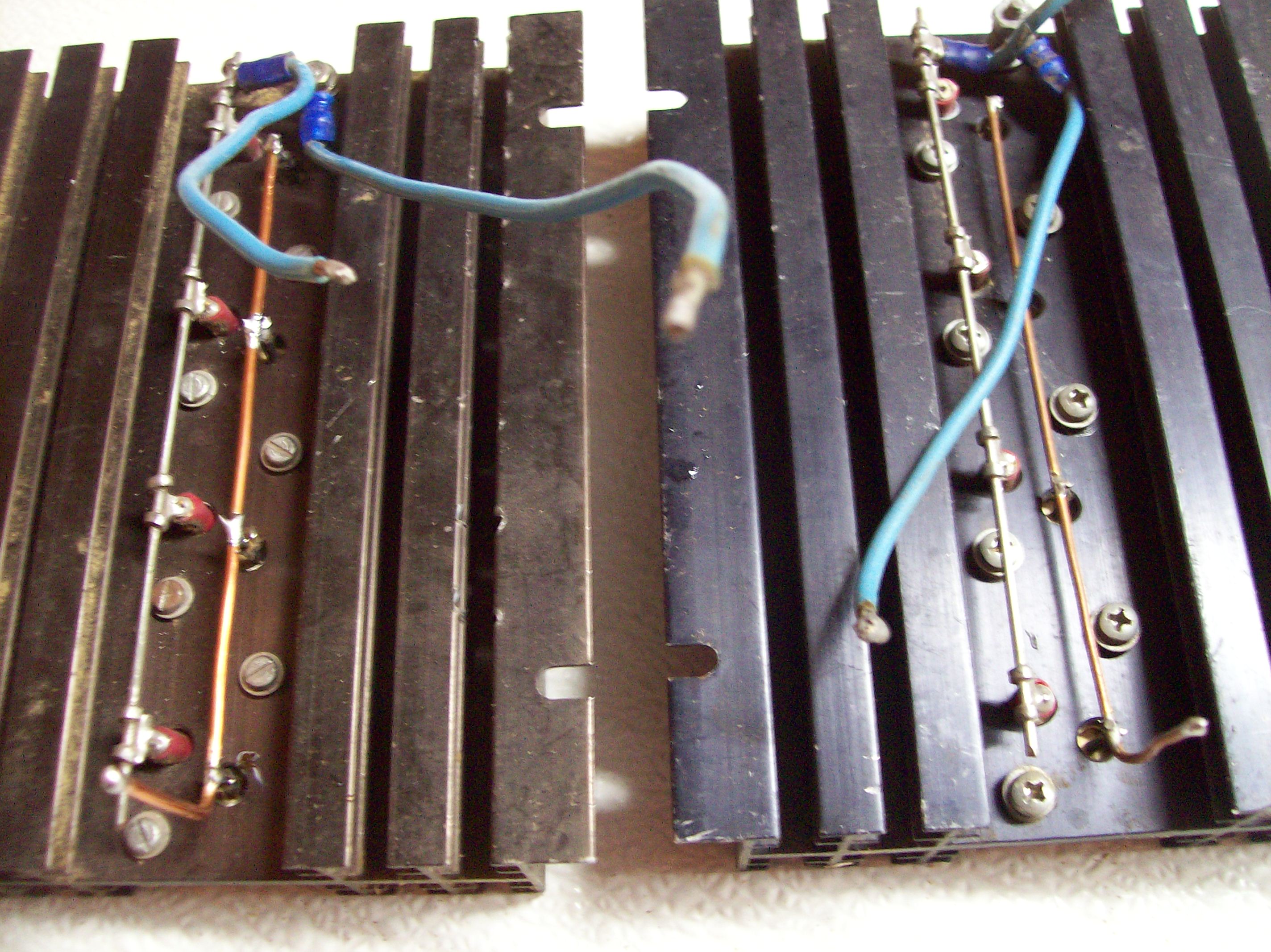

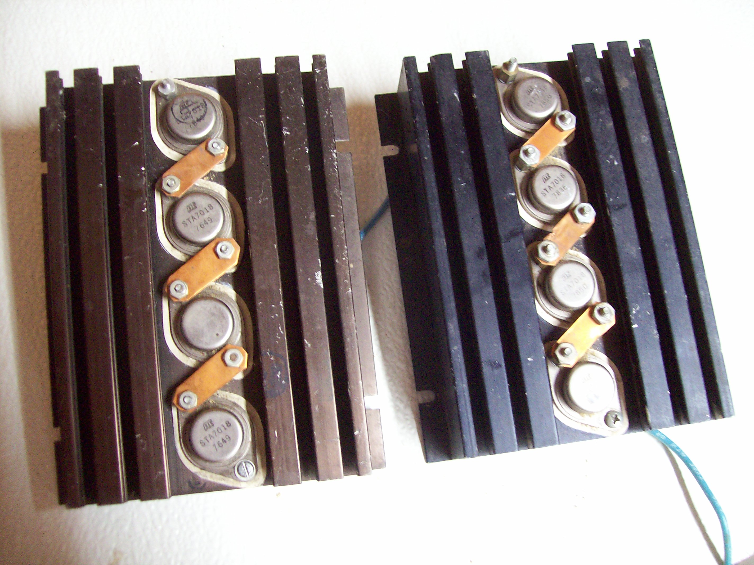

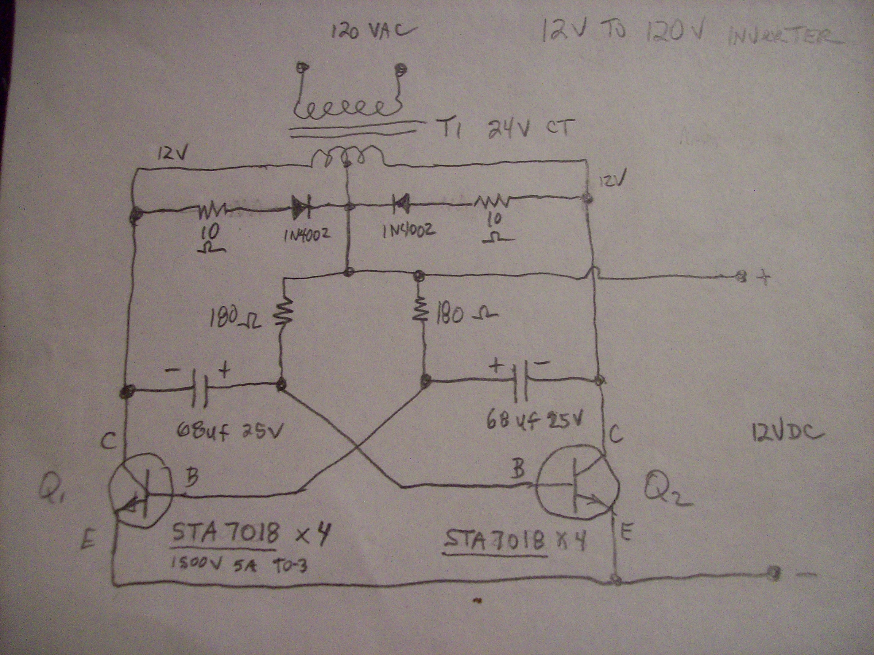

Today I came across this 12 vdc to 120 vac inverter that I built about 25 years ago. Heat sinks with 4 transistors each in parallel are industrial salvage stuff from the local scrap yard 10 cents per lbs long ago. I paid about 20¢ for these. I have a 120vac to 24vac CT transformer connected with 24v as the primary. 12v car battery produced 120vac. It will light up a 100 watt light bulb. At the campground it would light up several smaller 7w lights and strings of Christmas tree lights. Only datasheet information I find on the 7018 transistors is 1500v 5a. This is not very important anymore with $25 inverters that work good these days.
I tried to build this same circuit with 2N3055 transistors but transistors will not work in parallel. I tried nichrome wire to connect emitters in parallel but it
never worked.
Why do the 7018 transistors work in parallel but other transistors won't?
You can't put BJTs in parallel because they conduct better (lower C-E voltage drop) the hotter they get. Due to manufacturing variations, no BJT is identical, so the BJT that is the most efficient carries a bit more of the load current than the others which makes it hotter, which reduces it's C-E voltage drop which makes it carry even more the total load current which makes it even hotter until it's the only one carrying all the current and none of the others are and it fries. If you do put them in parallel, you need to put a so-called current balancing resistor in series with every BJT to prevent this from happening.
MOSFETs conduct worse (higher D-S voltage drop) when they get hotter, so as one gets hotter, it less of the total load current flows through it and instead flows through the other MOSFETs which heats those up so they don't conduct as well and a balance is maintained amongst all the MOSFETs.

I was told small resistor like nichrome wire connecting transistors in parallel will work but it did not work on 2N3055.

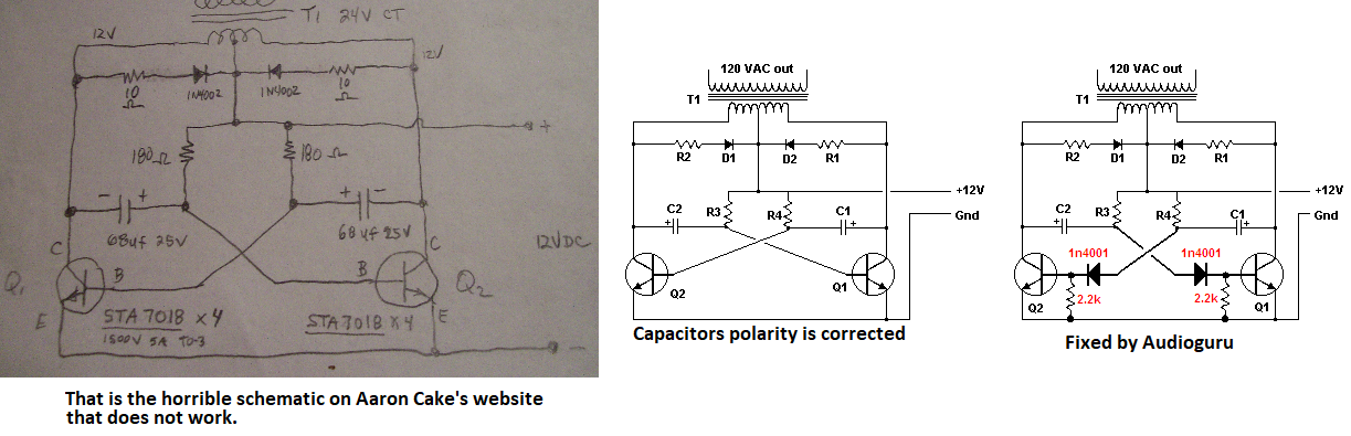

That horrible old schematic is the same as the one on Aaron Cake's website that does not work.
Its capacitor polarities were backwards and it used only a single pair of 2N3055 transistors.
Its problem is that each capacitor charges to about +23V then discharges into the base of the other transistor. But most silicon transistors including the old 2N3055 transistor are destroyed if their reverse emitter-base voltage is more than 7V. It is called avalanche breakdown.

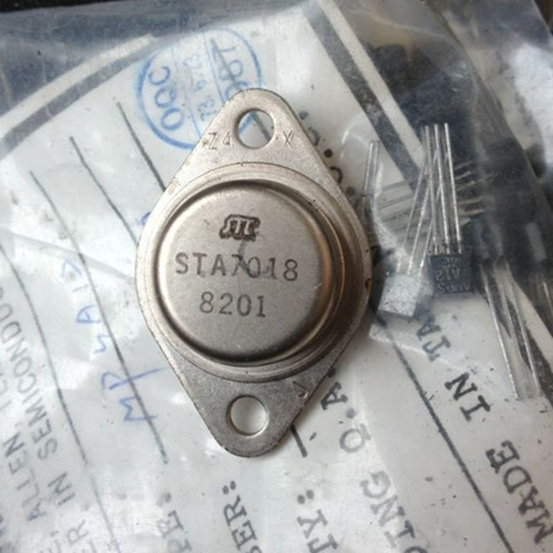

The 7018 transistor is so old that its datasheet is not available. It was a high voltage transistor used in an old TV. Maybe four in parallel are not zapped in that circuit.

I developed a fix for the problem:

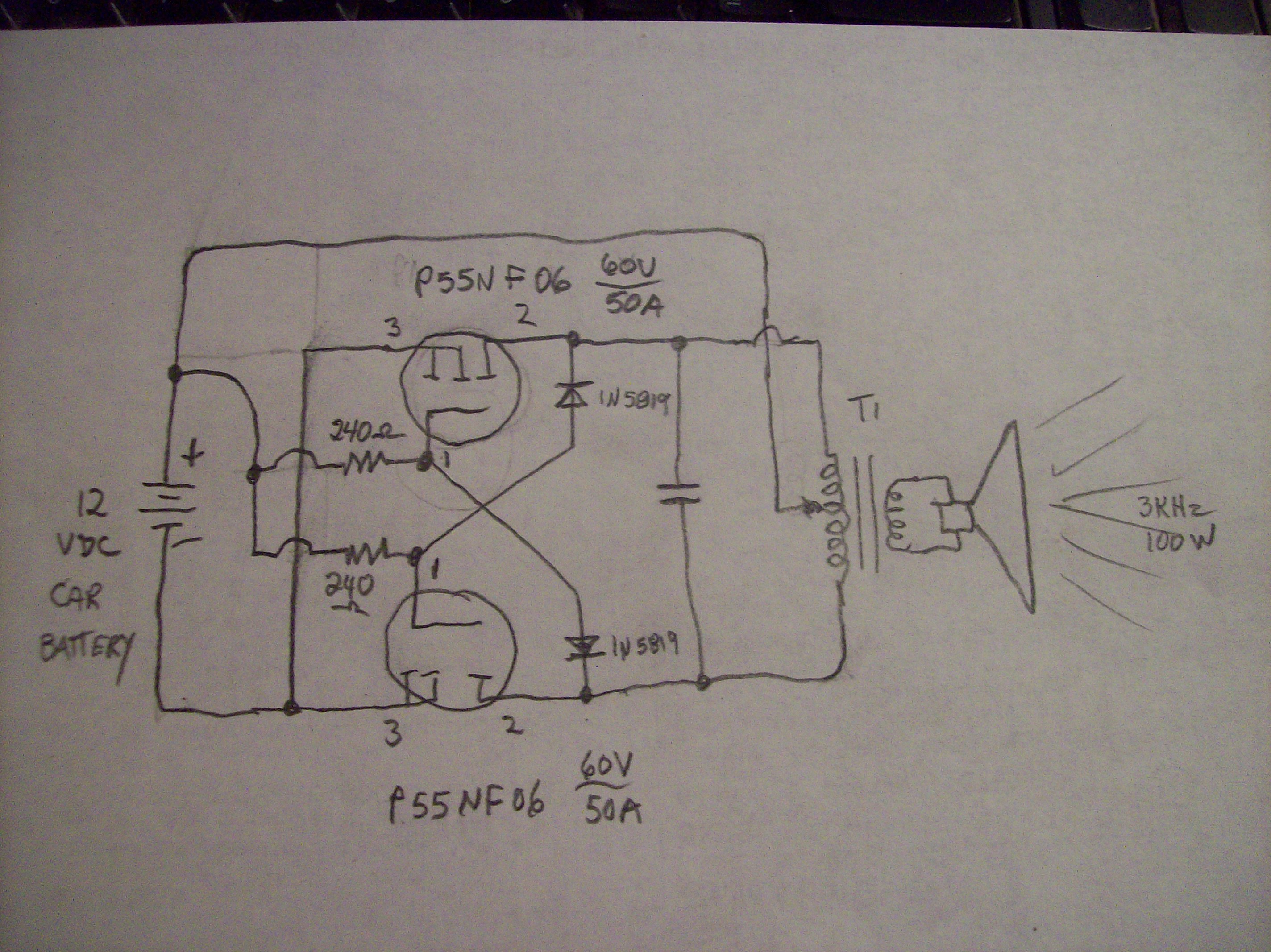

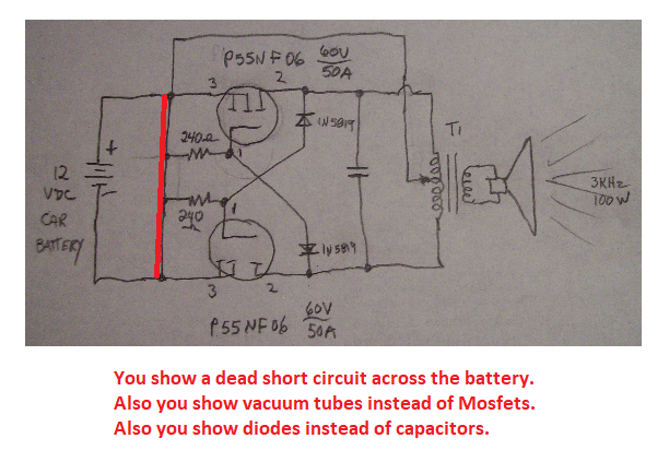

The improved circuit drawing is interesting. If I still had a 24v CT transformer I will build this just to see how it compares to the other circuit. It use to power a 100w light bulb. The only diodes that I have are 1N4007 how important is it to have 1N4001 and 1N4002 in this circuit. Not likely I have any 68uf caps or 33uf to connect in parallel but I probably have 47uf an 22uf = 69uf. I will make notes on the circuit drawing. I have an idea that might be FUN, I have a 1 to 1 ratio transformer rated about 200w and several 100w speakers, if I change the 68uf cap to get higher Hz it will make a great 100w horn. LOL I use to have 300 lbs of old transformers, wish I still had them. I'm not sure what a good KHz is for a horn maybe 2K or 3K.
No way to know what this 4 transistor thing was originally used for I rescued it from the scrap yard. One 2N3055 will do the same thing as these 4 transistors.
The datasheet for the 1N4001 to 1N4007 diodes shows that any of them can conduct 1A continuously and can conduct 30A brief pulses. The diode current in this circuit is only mA. The max allowed reverse voltage for a 1N4001 is 50V but it gets only 24V in this circuit and a 1N4007 can be used instead because its max allowed reverse voltage is 1000V.
The circuit will not work with a 1:1 transformer, the center tap is important. You can make the similar multivibrator circuit you used to blink LEDs to make a buzzer sound fed to an amplifier and a speaker.

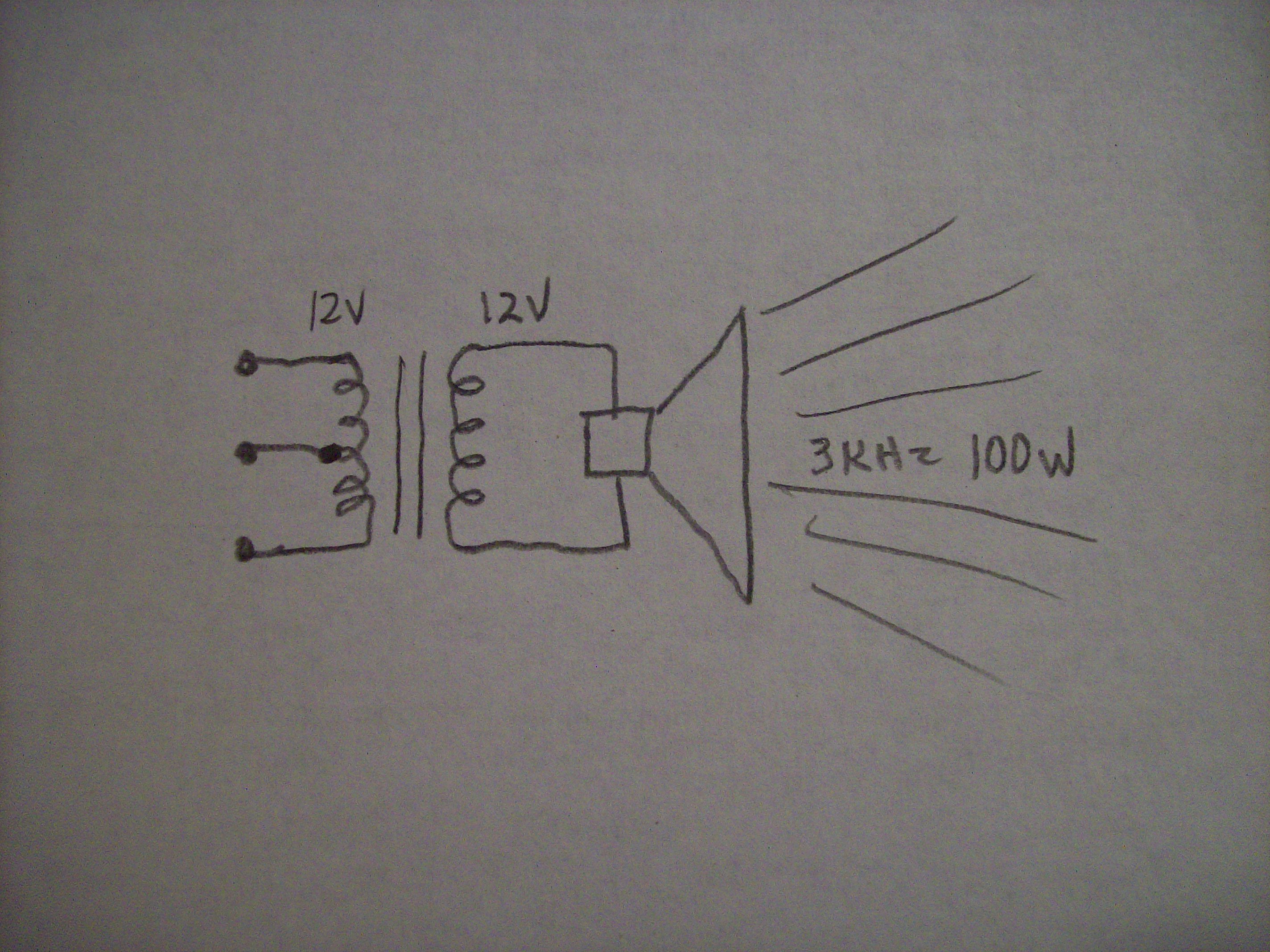

I am talking about primary with CT ratio is 1 to 1 with 12v on both windings. I can wind my own in the lathe in 30 minutes. I already have coil forms built to wind my own transformer coils. I can wind any ratio I want not sure what is best voltage for the speaker?
Ohm's law calculates that with only 12VAC in an 8 ohms speaker, the power is only (12V squared)/8 ohms= 18W. But if the transformer produces 24VAC then the power in the 8 ohm speaker will be (24V squared)/8 ohms= 72W. A mains transformer works poorly at audio frequencies.
But the circuit does not have enough base current (12V - 0.8V)/180 ohms= 62mA for the transistors to saturate so each transistor produces 12V at 0.62A= 7.4W then the output power in the speaker will be only 14.8W.

I don't have to use this horrible circuit, I can use mosfet circuit to power a speaker.

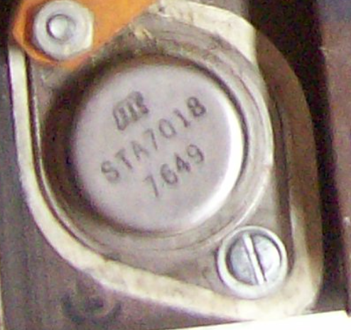

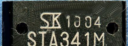

Sanken uses the traditional 2SA, B, C, and D for the part numbers of their bipolar transistors. STA is the prefix they use for "array" devices, which means there's more than just a transistor in that case. it could be a transistor and a low value (between 0.1 and 0.47 ohm) resistor right on the silicon. there are no data sheets for the STA part, so it's probably an OEM part. the only bipolar transistors that can be paralleled successfully (without emitter resistors) are germanium. i've seen some old amplifier schematics showing Ge transistors paralleled.
Dose any one recognize the maker? I don't think it is Sanken. I have some Sanken parts and can go check.
This is what a Sanken part looks like. "SK"
---Edited
---Edited
Found then in China. They don't know what they are. "STC"
I can't say I've ever heard that?, or seen any paralleled germanium devices without emitter resistors, and I was under the impression that germanium transistors were more prone to thermal runaway than silicon ones?.
However, it makes sense that the STA transistors could have suitable emitter resistors built-in.
