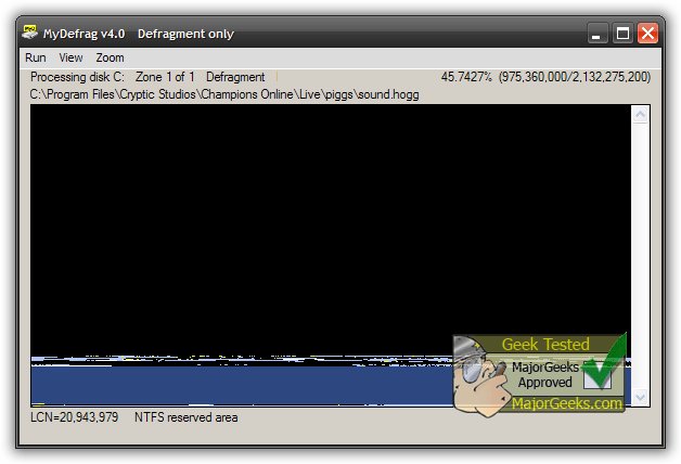

Running ccleaner to delete leftover temporary files, then in its tools - startup section, disabling all non essential stuff, then finally running its registry cleaner, can restore some performance.
Then get "mydefrag" and run that, using the system-monthly option on the C drive.
It will take a long time, but it is exceptionally good at optimising the drive for fast access.
The two together can often get a machine back to near-new performance.
(You can use the ccleaner part on any machine, but do not run a defragger on a solid-state drive, it will do no good and can shorten the drive life).
