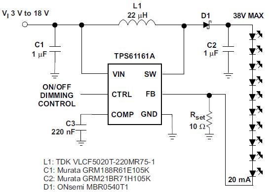

Why are car rear/brake LED lights done with linear LED drivers?
Flyback
Car Rear/Brakelights are only 4W each.
Why do people do them with linear regulators?
4W doesn't sound much but with the rear light being non-ventilated, that heat is trapped, and so can overheat.
Why can't an SMPS led driver be done as below.......?
This is a DCM Boost preceeded by a current clamp to prevent high current oscillations in the LC EMI filter if the driver "stutters" on and off repeatedly with the brake pedal.
From the moment the brake pedal is pressed, the output is in regulation just 1.3ms later......that ain't that much worse than a linear regulator....and it runs a whole lot cooler.

Its ether government regulations, reliability, complexity, cost, or any combination of any of them.
The TPS61161 looks good but isn't in any of the docs revealed to be for automotive use. I cant see why it shouldn't be....but it isn't revealed as such.
To be honest I reckon two tps61161 type supplys gives redundancy and I would say is more robust than any linear regulator solution, even if multiple linear regs are used.

I take your point....but I reckon switcher driven leds will last longer (the lamp will last longer).....and anyway, people who buy bentleys can afford a bit extra on the led drive. It seems a shame to have the 4W worth of leds on a huge heatsink, and then go and dump in an extra 4W of dissipation due to a linear led drive.

i do like the LM3421.....its the only constant off time controller that ive ever seen that has an internal error amplifier....it says it uses 'predictive off time' control, but from what i can see, the off time is just how long it takes the RCT cap to charge up to VIN/25.
It looks like you can connect the timing resistor to the drain or the vin.....but if its a boost converter, then connecting to the drain will make the off time longer.
The high side dimming drive blew my mind a bit , but i suppose it is the easiest way, even though it has shedloads of external components.
