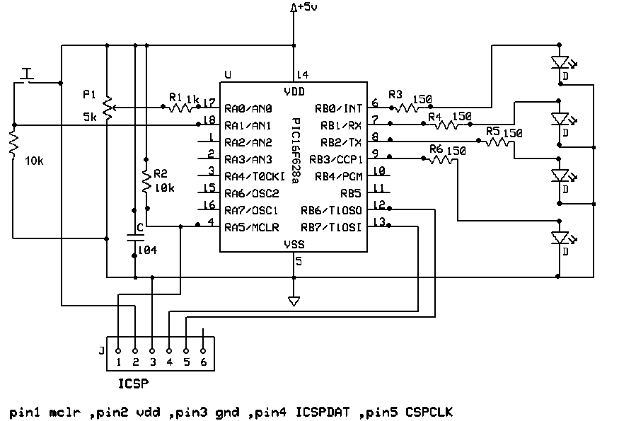

Make a board like this and you can do the picklt2 lessons with little changes

Hi be80be,
if you wouldn't mind, could you or someone else go through the code and explain each command and what it is doing?
thanks very much! :)
Hi Alharad,
That board be80be gave you will give you a good quick learning curve along with the code he has supplied. But I do see one problem when your ready to move on to other better things you would have to make another board. The reason I suggested Nigel's main 18 pin board is the ports all have header pins so it is a multi purpose board. It's up to you which way you go but when I first started I made most of Nigel's boards and they were great. A couple of years ago a friend wanted to start in pic's and I gave all my boards to him and got him to follow Nigel's tutorials. Since then those boards have gone onto atleast one or two more people wanting to get started.

bryan1 Nigel's boards are the best way to go. I thought he had the low pin count board but seeing he has the guide I just posted that so he could still go over the code and try it. The ADC sample is real good that comes with the guide.
