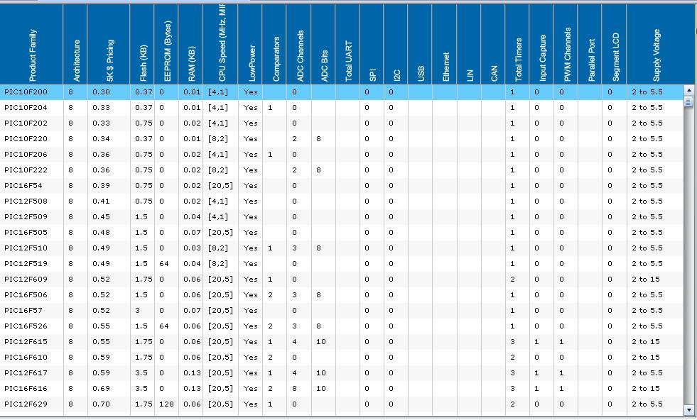

I'm looking for PIC Microcontroller suits my project discussed Here. and
Here. .
I've tried Microchip site to help me but found the attached list which made me more confused, so if anybody can help, I'll appreciate it. Here are my requirements:
  • A2D converter ( I need one channel only )
  • Enough space to connect LCD in 4bit mode.
  • Internal oscillator.
  • As few pin as possible.
Thank you

hi aljamri,
Your links will not connect.:D
Look at the 16F887 as on option.

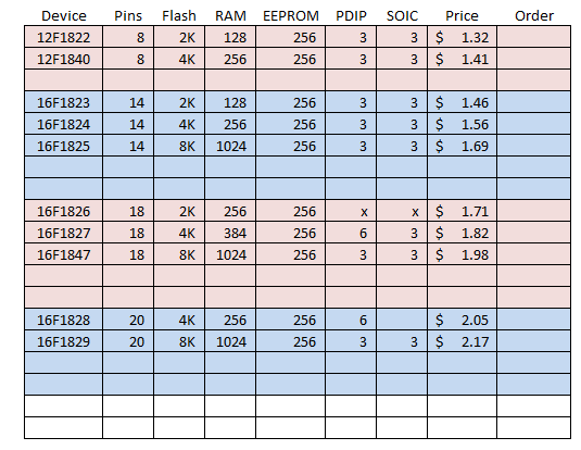

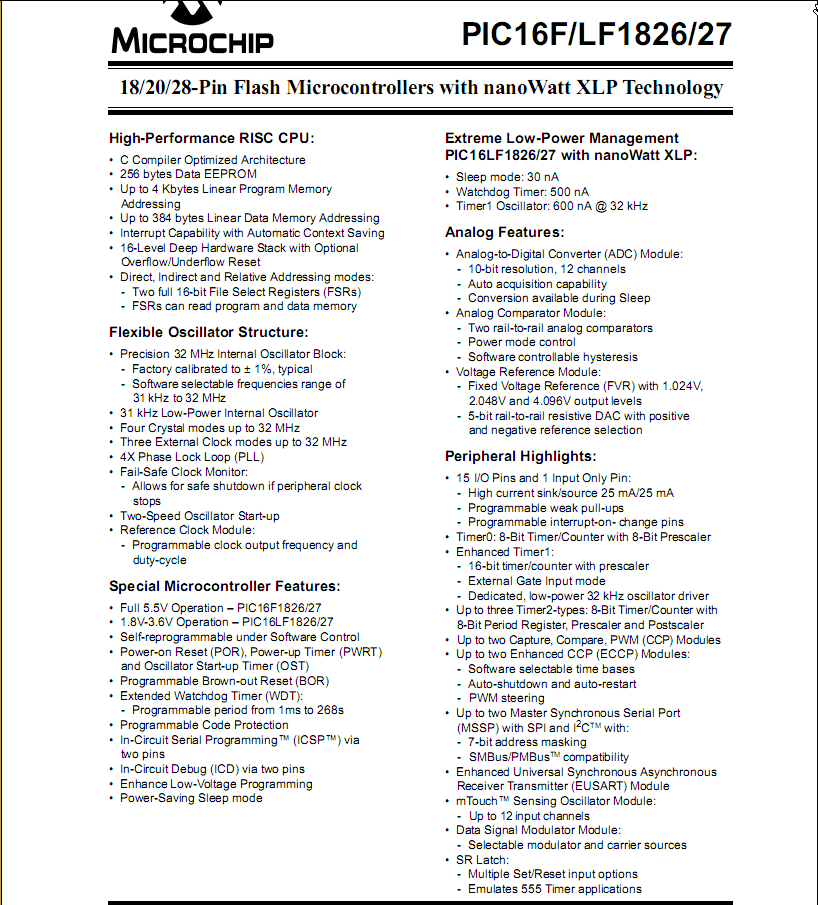

I suggest you look at the 16F1827 (which I've moved to recently), only 18 pins but an enhanced 14bit core, with loads of extra internal hardware and a number of extra software instructions. And the best thing?, it's a fraction of the price of the older devices like the 16F876.
hi aljamri,
The features page for the 16F1827

And only £0.97 in ones, the 16F648a's I've been using are about £3.40 each.
A great feature (which I specifically needed) is that you can access the GPR's as linear address space - so I've got a 220 byte RS232 buffer.
... I read it as 3848 but its only 348 (I thought the B was an 8, nearly jumped through the roof)
Ian, please take a look at some of the other "enhanced" device offerings. The 18 pin 16F1847 has 1024 bytes RAM...
Regards, Mike
Unfortunately, my online supplier has no such PIC. After all I decided to take PIC16F716 which supported by MikroC, my programmer, and has A2D, 20Pin, 2Ports and the lowest coast $1.45 :) .
