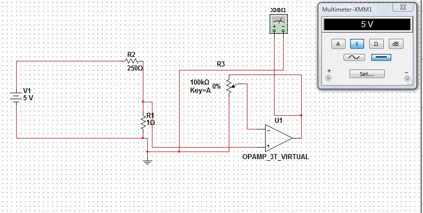

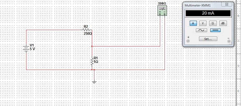

Here some thing to look at

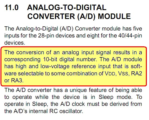

Before I start this thread, I remembered Eric said he would solve it in software, so I read a lot in its datasheet searching for port setting or alike ( remembering software reference in PIC comparators ) and found nothing in this regard except the attached part .
Thanks for all.

Amazing (for me at least) How do you get current reading while you've connected your Ammeter in parallel ??

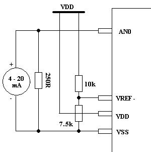

I've connected it to the VDD (5V), and the input as in the attached circuit.
Assuming the meter shown there is a real ammeter, then it's connected wrongly and will short out the 250 ohm.
The two resistors are also completely the wrong values, it won't give anything near a 1V reference - you need a 4K at the top, and a 1K at the bottom (or at least a 4 to 1 ratio).
Hi Nigel,
This is my mA source not Ammeter.
Frankly speaking, I was a bit lazy to find the proper Resistors, so what I did is connected a 10k Resistor and a variable resistor and turn it with a voltmeter until i got the 1v :eek:.

Hi Nigel,
Well assuming you're using those values, it's way off 1V.
