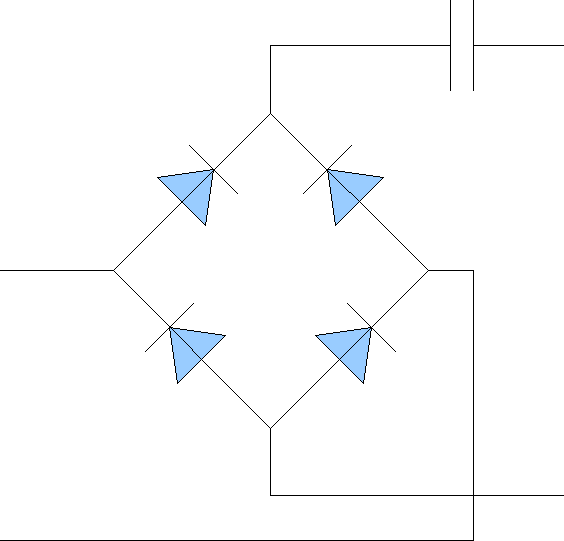

But pulsed DC from a rectifier won't go though a capacitor, it will just charge it up.
The source needs to be able to push as well as pull and a source that can only do either is providing pulsed DC in my book.
Put the capacitor in series with it, it will go through then!.
As I've repeatedly said, the ONLY difference is the DC level the signal is sat on - most electronic uses of AC wouldn't be AC by that theory - amplifiers, radios, almost everything.
Like this?
Like I said the capacitor will just charge up!
