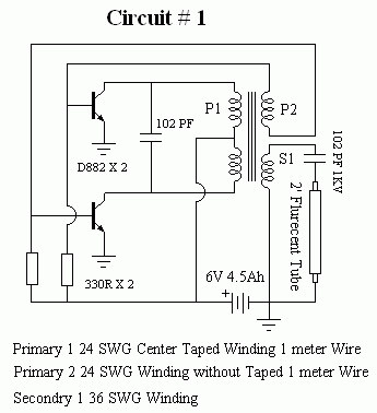

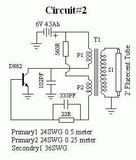

Hi All
I want a circuit for emergency Light.
Did some one help me to chose a better circuit for long
lighting time.
Which one is Better Circuit#1 Or Circuit#2
I also need a circuit for fast battery (6v 4.5Ah)charging
How can i use max712 for this purpose.
Circuit one is the best, it powes the tube of AC rather than pulsed DC.
Look at the datasheet for the MAX712.
Also note that if you're using a lead acid batter yyou don't need a fancy IC like to charge it, a constant voltage power supply will do.
Also D882 is getting hot too much. So it needs an adequate heat sink.
Instead of 2 Feet fluorescent tube you can couple two 7W small fluorescent tubes to get a sharp brightness also considering power consumption.

I am using 6.6 V D.C supply circuit for Charging It charge battery too slow nearly (Minimum.3 hours). I want a fast charger that can charge the battery in maximum 1 Hour. Do you have any other Circuit?
I second what Gayan Soyza says about using 7W tubes.
Also note that getting good performance from these simple circuits can be a challenge, you might need to play with the resistor values a bit to optimise it.
Charging at 7V will charge the battery faster (6.6V won't charge it fully) but why do you want a fast charger with an emergancy light? Normally you leave the thing pluged in continously so you don't need a fast charger.

For lead acid batteries the low current charge voltage would be 6.8V and you can leave it connected forever, the fast charge voltage would be 7.2V but after a full charge you should switch it to lower voltage.
About these designs, I would go for a simpler one or probably make both and see which is more efficient e.g. which would heat less air and give more light.
Also, the second design also gives AC at the secondary.
Good luck,
The second design does not give true AC at the secondary, it gives a stream of negitive pulses. If the tube is powered from it for too long only one of the cathodes will turn black dramatically shortening the life of the tube.
I assume he's using a lead acid battery.
The best option for a fast charge would be a microcontrolled charger and there are plenty of circuits around on the Internet for that.

I have seen most SLA charger circuits in emergency lights they use overnight charging methods.They have adjusted the charging voltage to 6.8V-6.9V standby voltage as in the battery specifications.

If you drive a transformer with a single transistor then you'll get pulses of current as the field collapses around the coil; these pulses will always be in the same direction.
The circuit with two transistors is a push pull blocking oscillator; the transistors turn on alternately and the coils are wound out of phase so the field alternates therefore the current in the secondary alternates between positive and negitive.
Of course you can make the first circuit produce true AC by adding a DC blocking capacitor in series with the load but it still won't be as good.
A good analogy is a complementary pair driving a load vs an h-bridge; the complementary pair won't give a true AC waveform without a DC blocking capacitor and the h-bridge will.

You've got me confused. Both circuits have transformer-coupled outputs, so no DC can flow unless the load is nonlinear. Furthermore, the 1st circuit does have a blocking capacitor in series with the load. Perhaps you meant to say "you can make the second circuit produce true AC by adding a DC blocking capacitor in series with the load". As I think you were implying, the 2nd circuit probably produces AC with a non-50% duty cycle.
A complementary driver can produce true AC if the load is returned to GND, while the driver swings plus/minus.

When I went to university, the EMF in secondary winding (let's make it simpler -Voltage) depended not on absolute magnetic flux but the change in that flux in time. So any DC component in the primary just won't go through the transformer, then you can say that those windings are galvanically isolated. That is actually the second use of a transformer.
Any DC component in the primary wind. will just heat it up, and reduce power handling capacity of the core, which makes a capacitor a good idea. You just need to tune it well to avoid too much oscillation.
This ground connection at the sec. side is there just to prevent voltage buildup due to various parasitic effects, pesonally I'd put a 1K-10K resistor there since actually no current will flow there if the system is built well, and it can preven too quick a discharge while pluging/unpluging the device.
But, again, might be, laws of physics did change, I didn't check lately. :p

I see why the first design tends to perform better. I'd still check it. Now believe me even if you feed the primary with AC+DC, the only current that you can get on the secondary will be AC, regardless if you drive the core to saturation or not. Of course if you do you'll have some losses there.
Let's see.
As primary gets series of pulses, the core's flux goes from 0 to maximum flux, (not - to + max-flux as if you'd power it with AC, drawback: you can use only half the transfer energy capacity of the core but that's not the issue here) As the flux rises you'll get the EMF in one direction, as it falls to zero, you'll get the emf in other direction. NO DC COMPOUND!
The most probable reasons for blackening one side of the tube (thus emmiting mass of one heater/electrode) would be:
-unbalanced duty factor, The duration of pulse should be as much as just to drive the core to saturation or even better, just not to. Duration of off period should be the same (as to allow the core to recover to zero). This can take some fiddly tuning and adjusting.
-the second reason would be very different rise and fall times of those pulses hence one electrode would handle higher current, the shorter time and vice versa. That can pretty much evaporate the electrode during time.
Otherwise, it should just work fine.
The first design makes beter use of transformer, hence the smaller is needed, but not really a standard one, and is easier to tune. The second uses one transistor, and a bigger transformer, but can be one off a shelf, and is a bit more fiddly to tune. Choose for yourself.

I think I see what is happening.
The secondary waveform is not symmetrical but has high negative peaks. The tube only conducts when this high peak is present, therefore the tube itself is acting "in a non-linear manner" as a rectifier, conducting only during part of the cycle, producing DC, causing the tube to wear at one end.

I think both our thinking is skewed here. What we have both neglected is the flyback effect. Consider a perfect transformer with a 1:1 turns ratio and a primary and secondary inductance of 1H connected to a 1V power supply via a switch; the switch will turn on practically instantly but it takes exactly 1ms to turn off and the current decay is linear. Suppose we turn on the inductor for one second v=di/dt so the secondary voltage will be 1V and during that time current will grow to 1A, now if we turn off the switch the current will decay to zero in 1ms, v = di/dt so the output voltage will decay by 1kV giving an output of -999V for 1ms.
Exactly the same thing is going on in the single transistor inverter, it's only the negitive pulses that are a high enough voltage cause the tube to light; therefore the electrode at the negitive end of the tube gets worn out and not the positive electrode.
