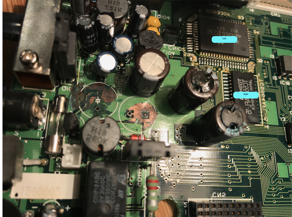

I bought a Leader Model 300 with an electrolytic leakage all around the power supply area. The device has yellowed and was probably exposed to sun and heat for a long period. And I suspect the device was used for a long time while with leakage. All electrolytics around the power supply are have been replaced and traces reconstructed.
Some background:
I am attaching images of the main board (top and bottom). Attached to the main board are separate boards. One for the DMM, another for the Oscilloscope and another for the display and buttons.

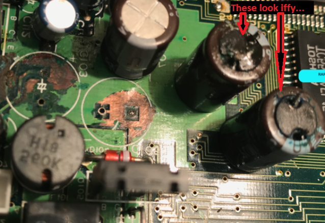

First pic: copper cladding looks rough, but serviceable. Noted caps don't look right, but they are out of focus somewhat...
Second pic: not sure what you're showing us... (don't see any damage and the colored lines aren't labeled).

The caps you think dont look right are the ones removed that caused the leak. The image shows the damage they made.

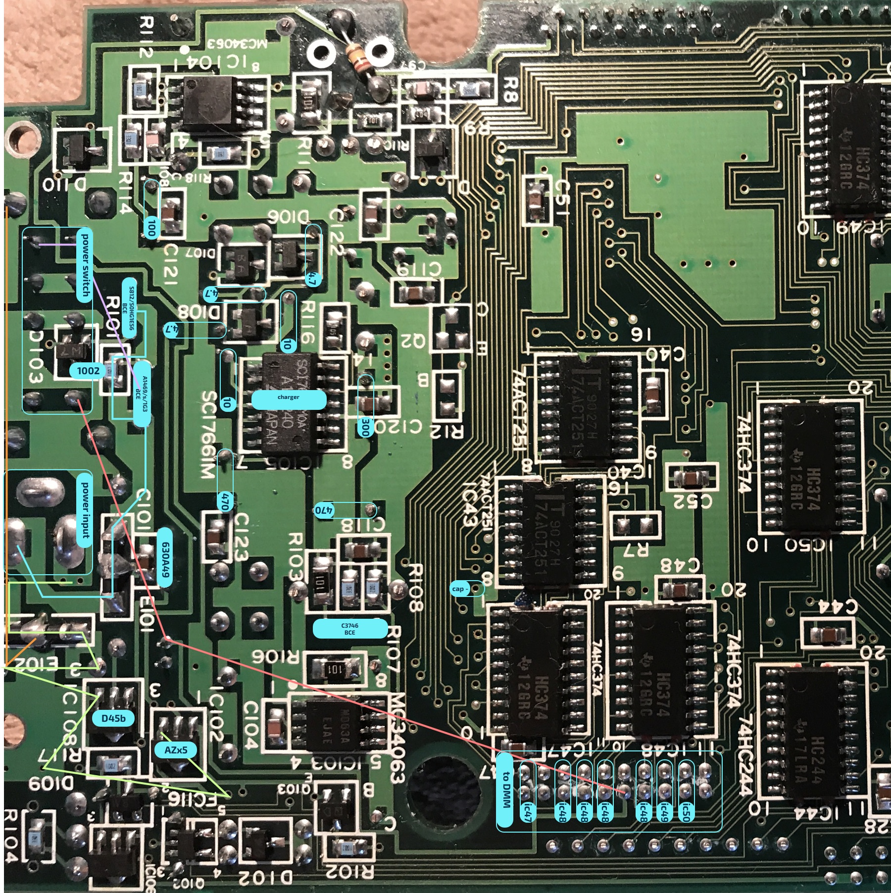

If you look at the image you did not understand, that was the back of the main board.

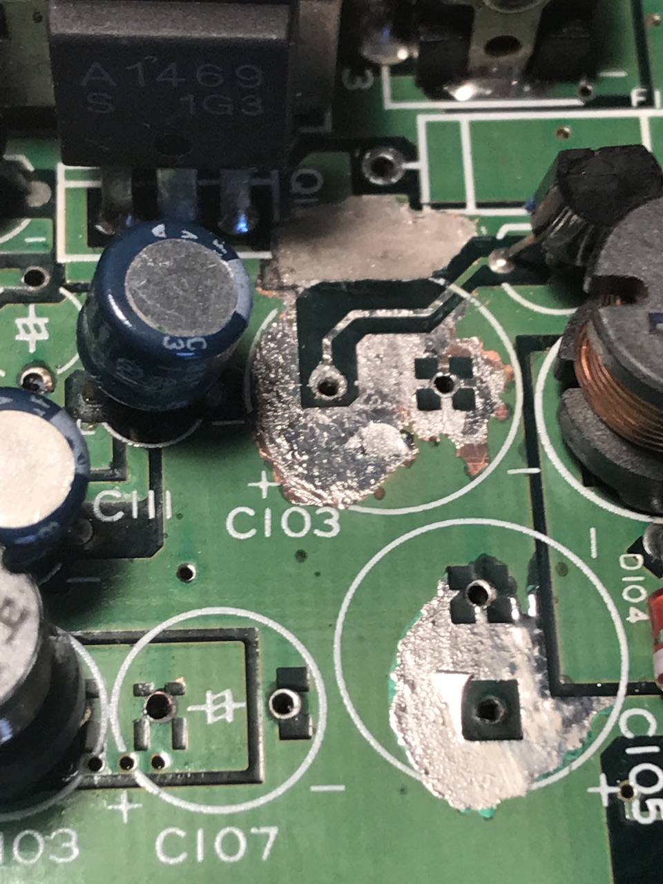

Here you see traces restored.

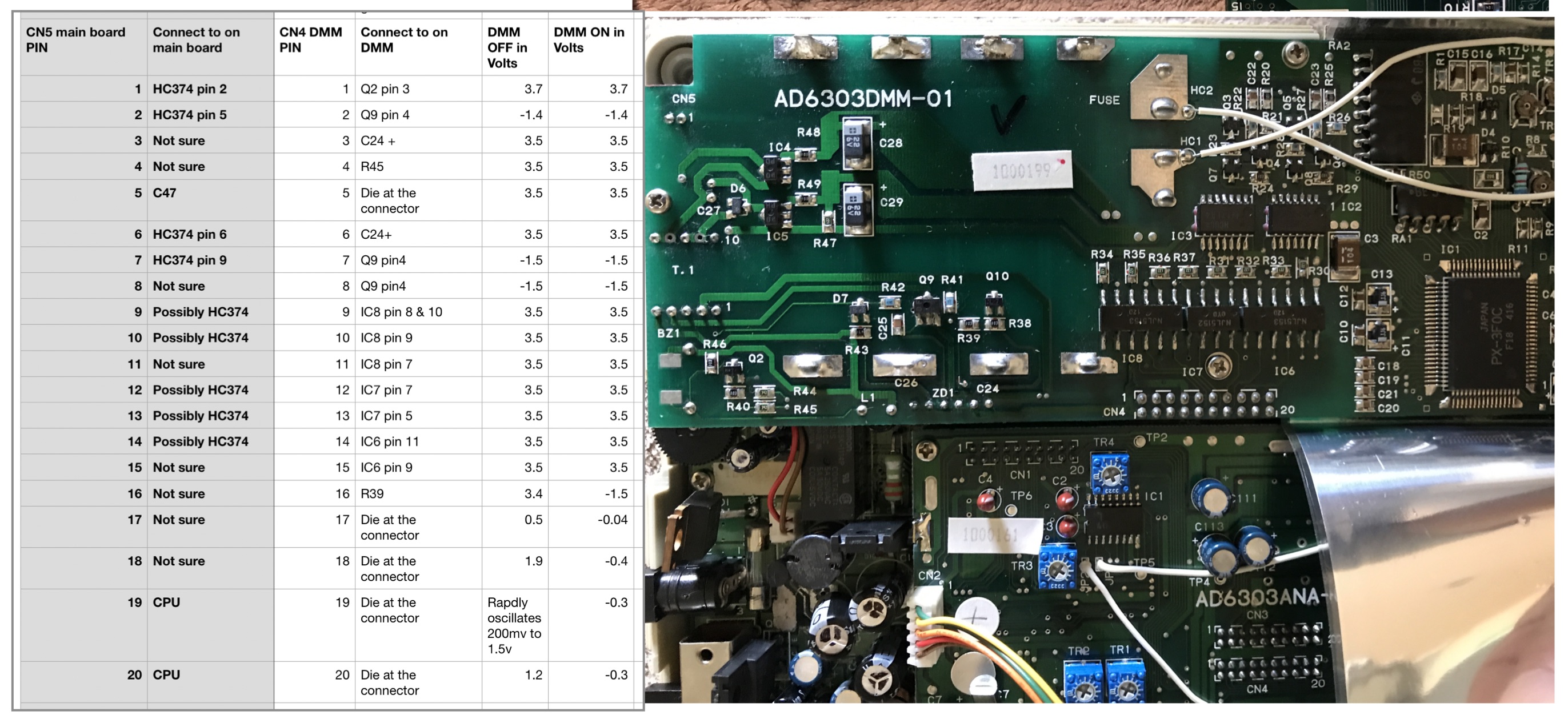

The image bellow is the DMM board (AD6303DMM) on the left where the CN4 leads.
DMM CN4 is the connection to the main board's CN5.
When DMM is on you can see there is a change in voltage on pins 16-20.
The table on the side shows where both connectors lead and voltages on each pin.

Traces between layers around the damaged area have been checked and fixed where needed.
