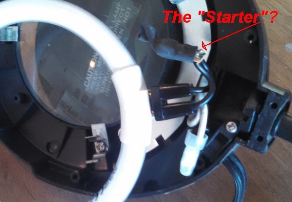

Issue 3 of 2016_08_15My understanding is that Fluorescent bulbs require a "starter" of some kind.
Is that it, that's shown in the picture? If not, then what is that part for?

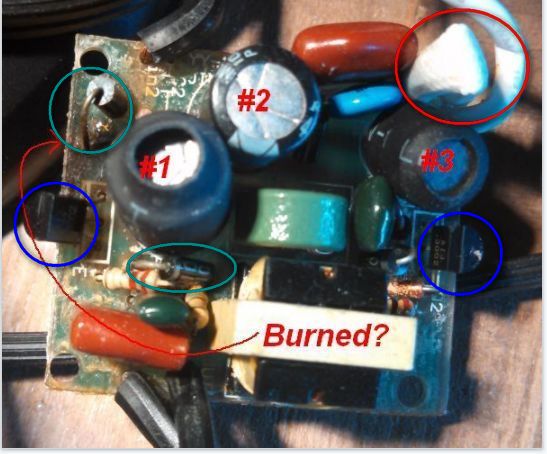

Max... no such luck. The PC board gets 120VAC just fine.
Wow, Spec,... information overload !Very cool!
You think the board might still be operational? Great!...
A voltmeter says the board IS getting 120VAC.
At the other end of the board, the two wires go to the lamp show no voltage. (Should that be AC or DC there?)
So, on the PCB, which part is the Capacitor? #1 or #2 or #3?

I suspect the board may be OK, or it may have a repairable fault. The only component that would not be available is the inductor (large item at lower right on your image).You think the board might still be operational?
That is goodA voltmeter says the board IS getting 120VAC.
Yes, I would expect 400V peak (282 RMS) to 1000V peak (707V RMS) across the two wires going to the FT; a meter set to AC input would read RMS but as the frequency of the AC is liable to be high the meter may be inaccurate or possibly read very little. There is no voltage present either because the main PCB circuit detects a fault with the wiring say, or because the main PCB has a fault. Beware of connecting your meter directly to any parts of the circuit or the meter may be damaged, as pfofit warns.At the other end of the board, the two wires go to the lamp show no voltage. (Should that be AC or DC there?)
No, I would not expect to get any hits on 'starter'. If it is a capacitor, as I suspect, it will be a standard high voltage capacitor, not specifically described as a starter.I Googled Capacitor images... nothing like that "Starter" thing that I asked about.
I suspect that what you describe as the 'starter' is a heater capacitor (CFL) or current limiting capacitor (CCFL)Please view the Dropbox pictures...
**broken link removed**So, on the PCB, which part is the Capacitor? #1 or #2 or #3?
As florescent tubes age they take more and more voltage between their electrodes to start the ionization. By heating an FT you make the gas inside the FT more active so that it will ionize at a lower voltage. But as there is no voltage from the main PCB, your FT will not start with heating.The "CCFL"... that's the bulb, Correct? And if I apply a hairdryer, it will light up? Wow. Never knew that.
I was referring to the connections physically to the FT. This is a common source of problems with FTs due to the high temperature of the FT when it is running and also due to the nature of the connecting wire which is designed for high voltage and tends to corrode easily.You mentioned the wires near the connection to the CCFL... Are you referring to up near the CCFL, or on the PCB?

1 and 2 are caps 3 is an inductor/coil.
Hi pfofit,

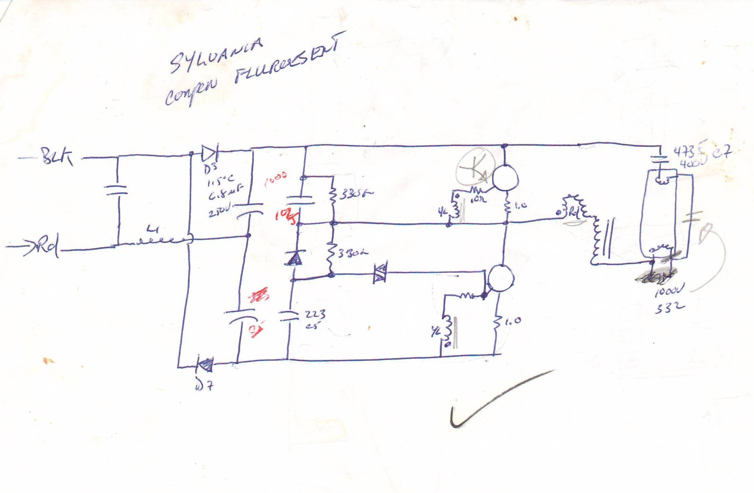

There should be a bridge rectifier in the circuit. I suspect that #1 is the bridge rectifier: what do you think?
I suspect that #2 is the reservoir capacitor.
The fuse that you highlight is included in the schematic of post #13.
