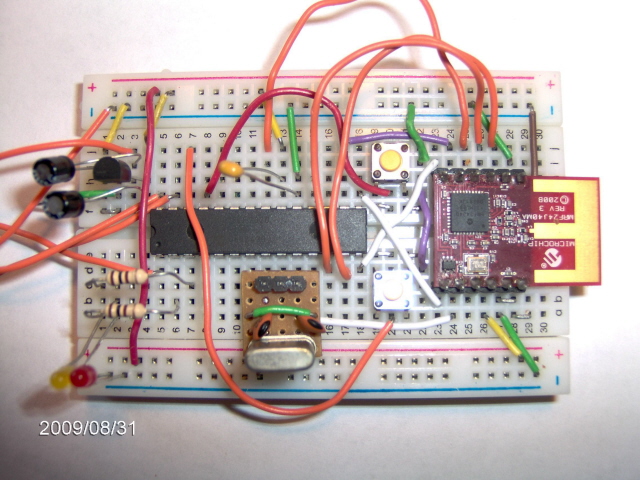

Here is the schematic for the Picdem Z breadboard project. With all the wires flying around, this project could be a little iffy, we'll see.

I am a bit excited to see another person here using Microchip's ZigBee. How good of a fit do you get soldering the pins to the side of the module.

Yes the layout of the MRF24J40MA is set up perfectly for the sip headers. The overall width is 0.700", and pin spacing is 0.100", to center of holes. I just use the breadboard or pcb as a jig for soldering the headers to the module, very sturdy connection. Way better than the Maxstream XBee layout.
Thanks for the heads up on the Zigbee stack limitations. Looks like a 18LFxxxx TQFP part may be in the future, oh boy. Right now just concentrating on getting the simple P2P stack going first. The demo would be up and running, but only have one 18f4620. So will be trying to get the node2 set up on a 18LF2320. Node1 is a 18f4620, with a 74HC244 buffer to the rf module. It acts like it wants to talk to another module.
