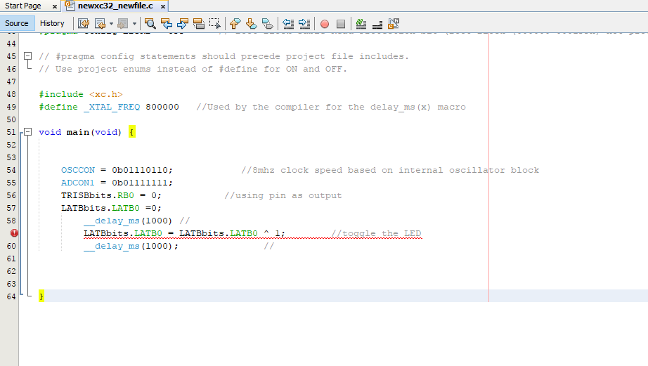

I cant get the naming right for some reason

it give me this error
"C:\Program Files\Microchip\xc8\v1.42\bin\xc8.exe" --pass1  --chip=18F1220 -Q -G  --double=24 --float=24 --emi=wordwrite --opt=+asm,+asmfile,-speed,+space,-debug,-local --addrqual=ignore --mode=free -P -N255 --warn=-3 --asmlist -DXPRJ_default=default  --summary=default,-psect,-class,+mem,-hex,-file --output=default,-inhx032 --runtime=default,+clear,+init,-keep,-no_startup,-download,+config,+clib,-plib   --output=-mcof,+elf:multilocs --stack=compiled:auto:auto:auto "--errformat=%f:%l: error: (%n) %s" "--warnformat=%f:%l: warning: (%n) %s" "--msgformat=%f:%l: advisory: (%n) %s"    -obuild/default/production/newxc32_newfile.p1  newxc32_newfile.c
newxc32_newfile.c:59: error: (195) expression syntax

Where is _delay() defined? The normal macros are __delay_ms() or __delay_us(). Note single and double underscores.
The dang thing shows the error at the LATBbits.LATB0 = LATBbits.LATB0 ^ 1;
But that should work I'm looking at the delay
I redid my code still no joy

Found it it was a dang ; missing above latbits
