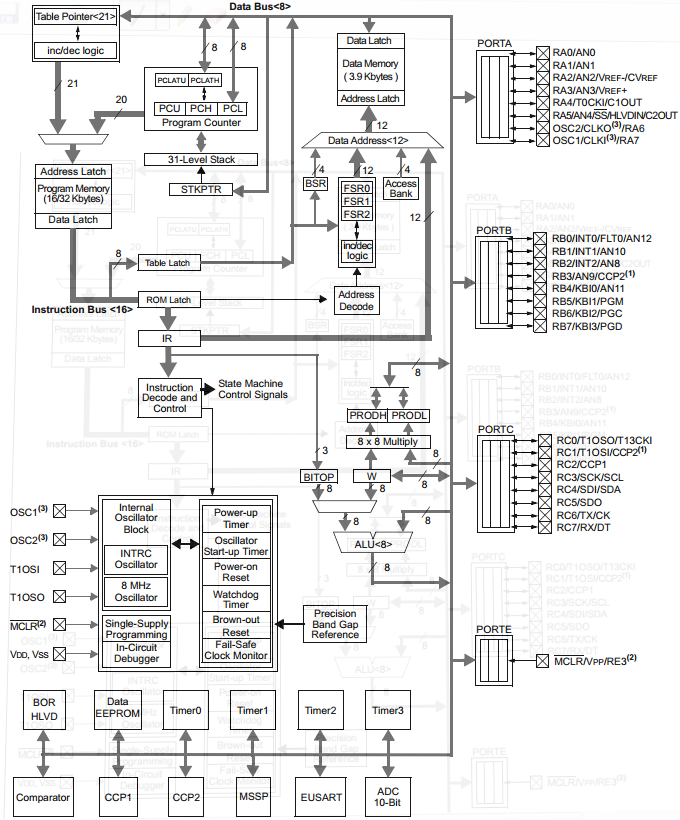

Hi guys,
I'm trying to understand the PIC18F block diagram (specifically, i have PIC18F4520).
Since the PIC18F is 8-bit, i.e. the address bus and data bus are 8-bit, wouldn't you expect the Program Coutner register to be 8-bit as well?
in the Block Diagram, it appears to be 20-bit.
An 8 bit computer has a 8 bit data bus only, the address bus can be any width. BTW, in the above diagram the address bus is 12 bits wide.

Hi dear friends.
I thank you very very much!
I learned a lot of this thread and i'm going to do (keep doing) a lot of reading.
Especially on Memory mapping which is new to me and you discussed this term.
Thanks a lot :)
