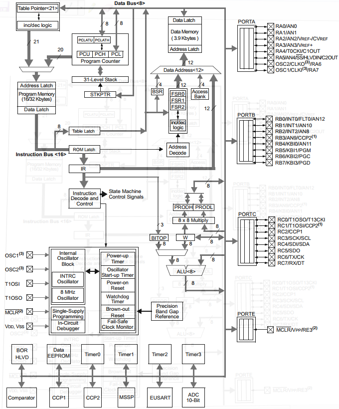

Hi guys,
I'm trying to understand the PIC18F block diagram (specifically, i have PIC18F4520).
Since the PIC18F is 8-bit, i.e. the address bus and data bus are 8-bit, wouldn't you expect the Program Coutner register to be 8-bit as well?
in the Block Diagram, it appears to be 20-bit.
