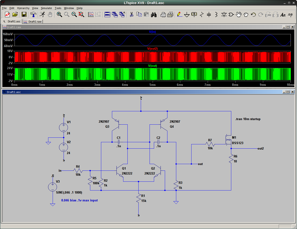

WHEN WAS THIS? #1 "BANG-BANG" AMPLIFIER
this was the earliest example of a Class D amplifier as far as i know. the circuit oscillates at about 43-60khz (the frequency drops a bit at the peaks of the audio input). the input voltage range is very narrow, and if the audio clips the amplifier, it stops oscillating (and fails to restart). there is a slight DC bias required of about 0.046V at the input, and the max audio input is 0.1Vp-p. it's easy to see why this never went into production, the output is very finicky about loading, and the circuit may stop oscillating if the output impedance is too low. i added the MOSFET buffer because of that. if you try this circuit, you will find it's even sensitive to the gate capacitance of the MOSFET, and will stop oscillating with different MOSFETS being driven. the gain of this circuit is around 180-200. the circuit was actually named "Bang-Bang Amplifier" in the book this circuit came from. the term "Class D" had not yet been thought of.

actually there were no transistor types in the schematic, and from the amount of "finicky" in the circuit, i wouldn't be surprised if the originals were germanium. don't go by the part numbers used.
i will publish a circuit using modern components.
i'm doing that so people don't have to go searching the web for germanium models or anything else out of the ordinary. as a matter of fact, i might try some devices with lower beta to see if that corrects some of the "finicky".

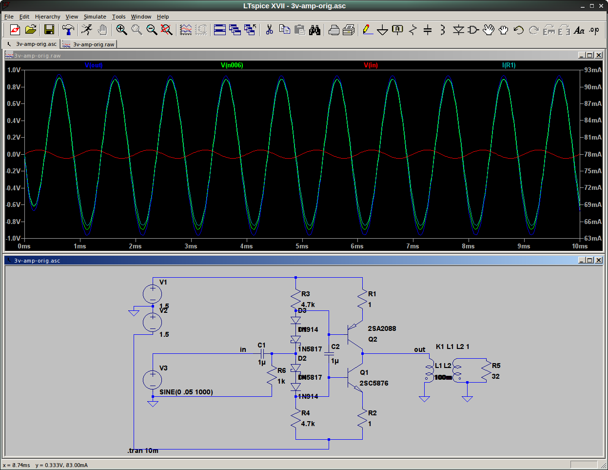

WHEN WAS THIS? #2 AMP POWERED BY D-CELLS
this little beauty has the advantage of being super simple. this amp is powered by 2 d-cell batteries. the amp has a voltage gain of 40, and was meant to power a speaker in a portable radio. there's only one real "gotcha" in this circuit, and that's the fact that the idle current is about 120mA. it's a battery eater. the use of a transformer to drive the speaker could be a clue to the "when was this" question. except for the idle current problem, this little circuit could have been the "LM386" of it's day.
WHEN WAS THIS? #2 CONTINUED D-CELL AMP IDLE CURRENT FIX
on the input side of the amp, are two diodes and a pair of 4.7k resistors. this diode/resistor network has a large effect on the idle current of the output stage. so, let's try to reduce the idle current some...

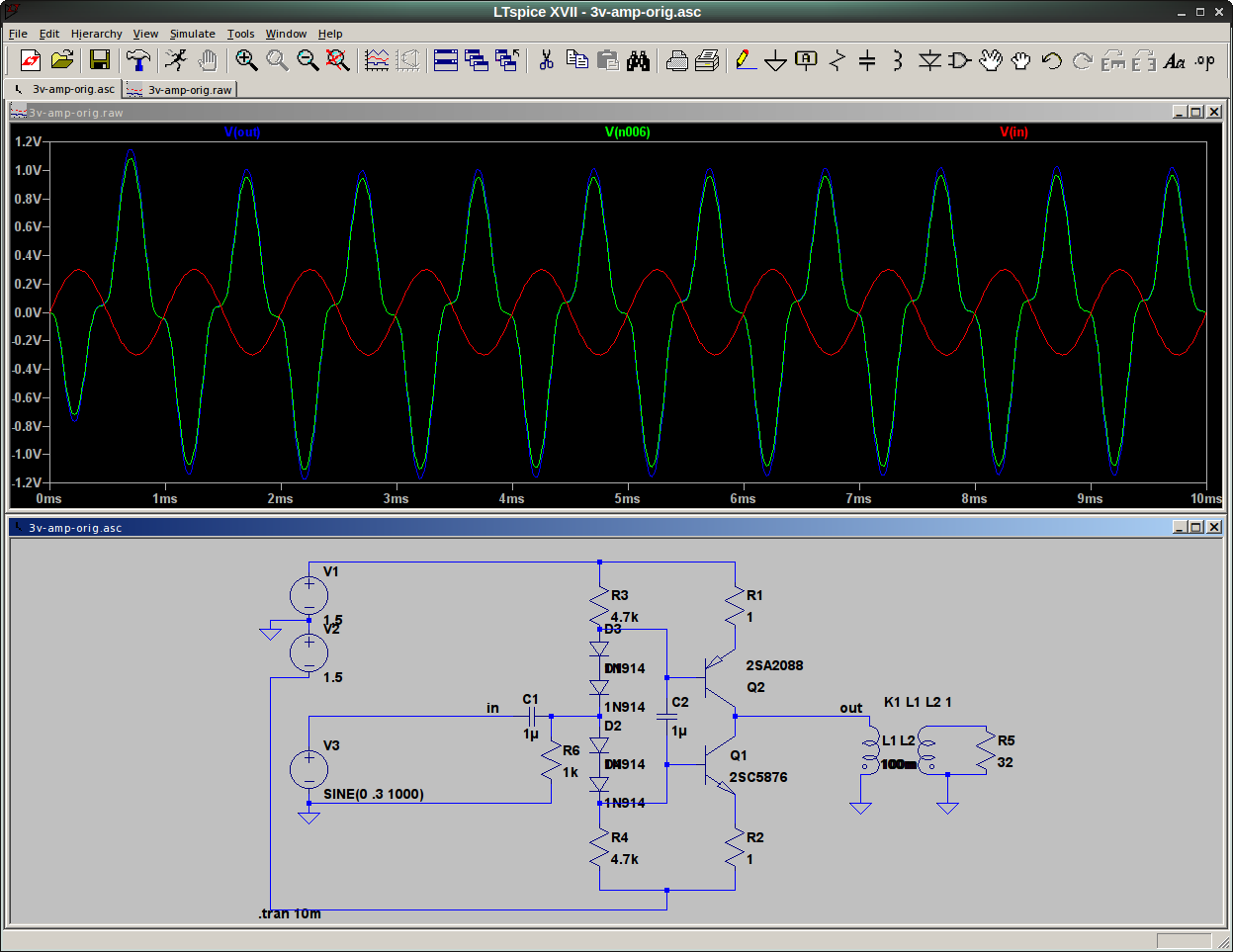

what i've done is add two more diodes to reduce the voltage on the bases of the transistors. this modification changed the gain to about 7, but it also created a "dead zone" where the output of the amp is zero, while the input waveform is within 0.1V of zero. this is very similar to crossover notch distortion in power amplifiers when the bias circuit fails. the crossover notch is not acceptable, so let's try something different... let's change two of the diodes to schottky diodes
this brought the gain back up, and got rid of the notch. the idle current is 78mA now (change the ac input to 0V, run the sim, and measure the current through R1). 78mA is still a bit high, so let's change the resistors next:

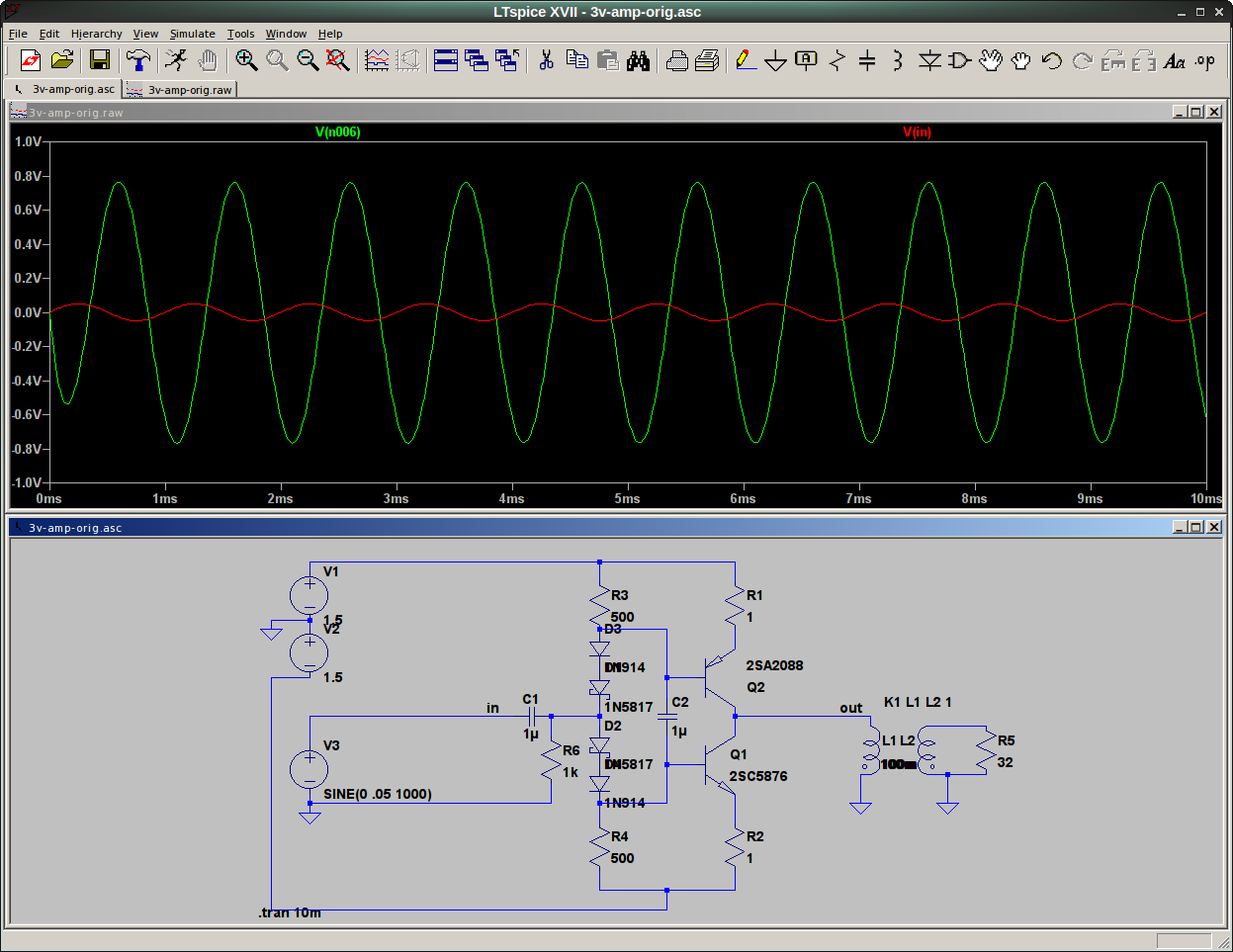

the base bias resistors are now 500 ohms instead of 4.7k. this reduced the idle current to 32mA, which is going to have to be sufficient, because the gain has been reduced to 32. lowering the idle current is now a game of diminishing returns, because it will also reduce the gain drastically. the circuit as it is now offers a fair trade-off, a voltage gain above 30, and idle current of less than 1/3 of what it was originally.

Are you sure that you have the transistors connected correctly in posts 5 & 6? If you had them connected emitter to emitter and the collectors to the power supply, then you'd have a standard complementary symmetry output stage. The diodes would be across the emitter-base junctions to bias the transistor just into conduction and eliminate crossover distortion. I've never seen a circuit like this with the transistors connected backwards.
Bear in mind that if this came out of one of those magazine circuit collections, those circuits were often submitted by people who thought they had some brilliant new idea, but the circuit was often marginal at best. The editorial staff never tested these things. They just published them and hoped for the best. I suppose that if they got a lot of negative reader feedback, they may have left it out of the later circuit collection books.

circuit #2 is from around 1963. the circuit is drawn correctly with opposed collectors. the whole point of the circuit is the voltage gain of a common emitter amplifier combined with the simplicity of symmetrical push-pull outputs. the original devices in the schematic were actually germanium transistors. the design actually works quite well, even though the idle current in my final modification is still a bit high. unlike the circuit in the earlier post (the class D amp, which turns out to be from about 1958 or so), the amplifier actually has a wide tolerance in output device characteristics and component values. the class D amp in post #2 is on the edge of not working, and changing component values more than a few percent stops it from working at all. the circuit in posts #5 and 6 can actually operate directly to a speaker, but i left the transformer there because it was in the original circuit. since the resistors from the bases to the supply rails set the idle current in the output devices, it's obvious that the 1.5V supply rails are about all these transistors can tolerate.

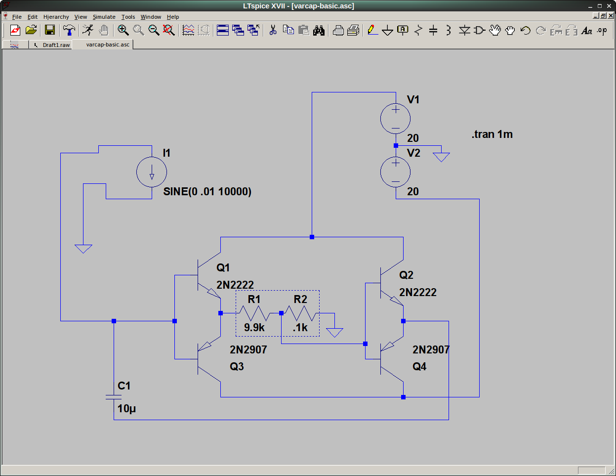

WHEN WAS THIS? #3 VARIABLE CAPACITOR
the following circuit is a variable capacitor using 4 transistors in a variable capacitance circuit. the current source is used as a way to measure the capacitive reactance. this circuit is kind of crude, and has a "dead band" within 0.7V of the zero crossing. R1 and R2 are a 10k potentiometer. with the wiper at the ground end, the effective capacitance is the same as C1, and moving the wiper towards the left decreases the capacitance. the advantages of using this circuit are that this circuit can operate at frequencies approaching the Ft of the transistors, as long as C1 is more than about 10x the junction capacitance of the transistors. the disadvantages of this circuit are a) this is a single ended capacitor (i.e. one end of the cap is grounded, and not floating), b) the +/-0.7V dead band can distort signals across the capacitance, and so this device is ineffective for small signals c) because the capacitor is operated in a half-bridge from bipolar supplies, polarized capacitors should not be used
