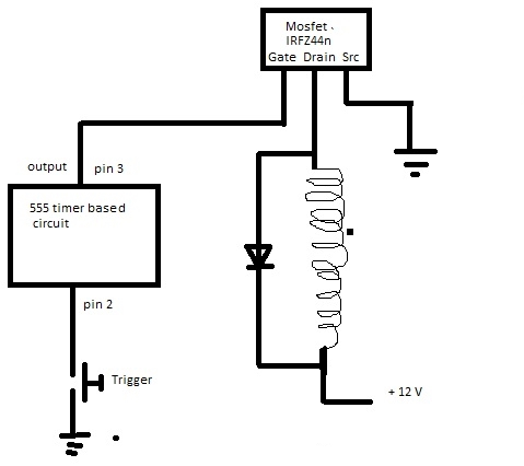

Here is a thumnail of where I have reached so far.
Am I correct ?

You'll want a 10k resistor going from the gate of the mosfet to ground, this helps protect the gate when the circuit isn't operating. Also in your schematic you have the +12 and the GND lines reversed. Source should be grounded directly and the load should be between the drain and +VCC.
Also don't use rectifier diodes as flyback protection, you'll want to use a fast diode, basically the highest current rated signal diode you have. Regular diodes take a little while to turn on when the voltage chances abruptly, at least in comparison to the sudden very high voltage the coil produces. A modest ceramic cap in parallel with the diode will further dampen the voltage spike from the solenoid, as it will conduct a decent amount of current during the high rise time of the inductive spike, enough to soften it for the diode a pinch.
