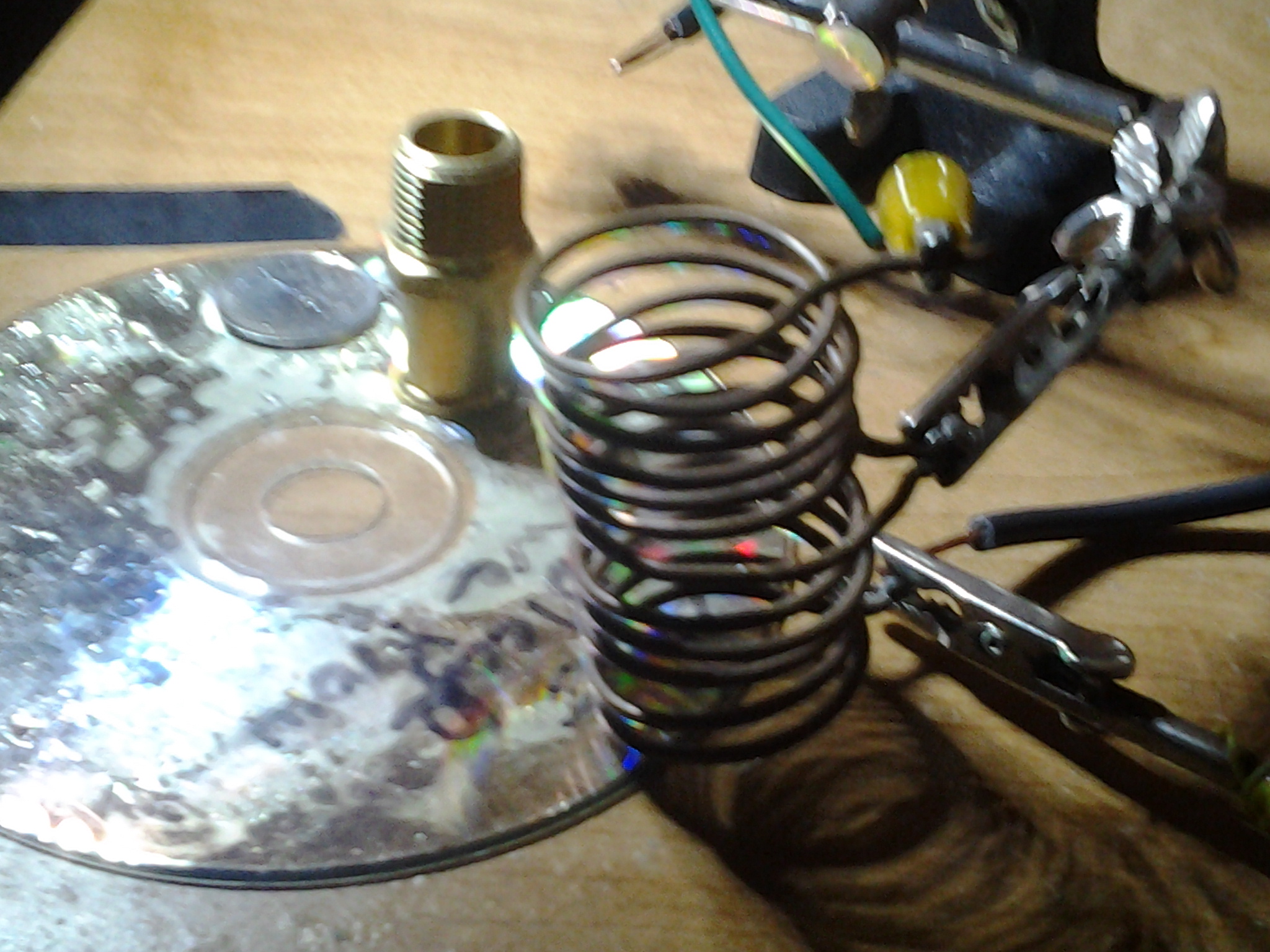

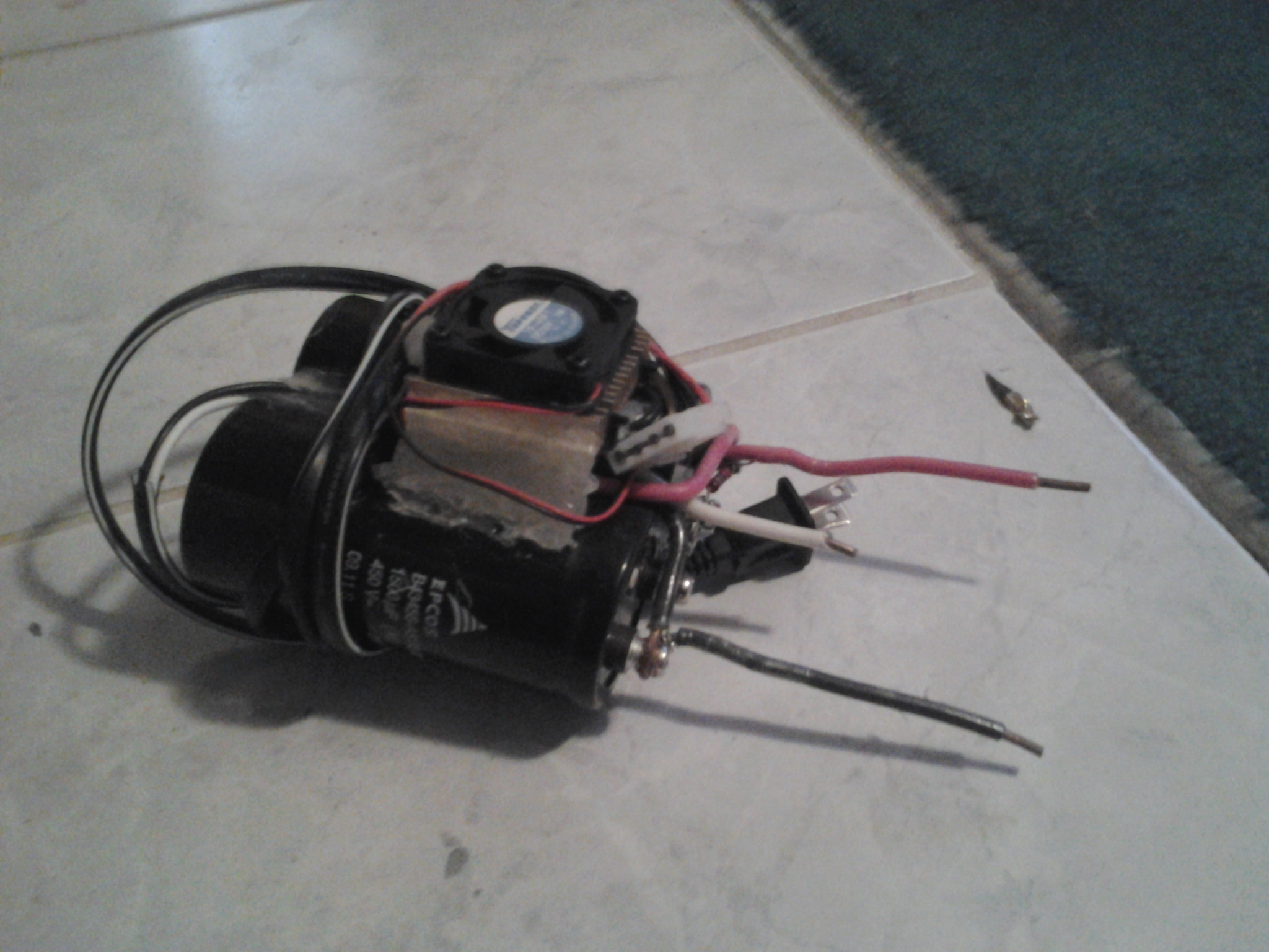

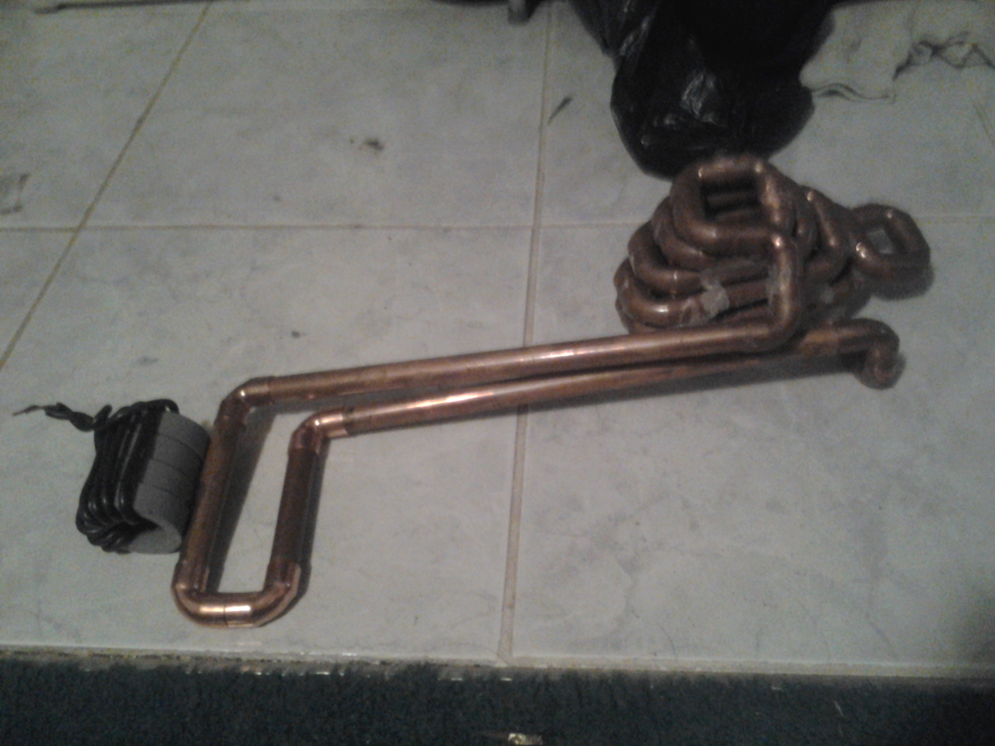

third, in the photos is my progress with my coils, the first one is the smallest, it idles at about 1.2amp draw from supply
(plus 0.5amp for cooling fan) and jumps up another amp when screwdriver is inside coil and heated past 100 degrees in just a few seconds, any smaller coils and the oscillation would break down, now with my final inductor which i am building now, as in the last photo, i am introducing a toroid to isolate the work coil,
i just wonder if i switch my secondary design to a small Tesla coil would the zvs tune in automatically, it is probabally smartest to switch up to a tesla coil, but i just wonder with the tuneing I will still need sparkgap and flyback but it will still sing rite? also I wonder since i will need to ground to AC outlet, what is a safe power limit?

I like the copper layout, I bet you dont melt that.
The inductor is an important part of a zvs, without it zvs operation isnt possible (unless the supply lines are acting as one), an air cored coil is better as saturationwill not be an issue.
As far as tuning from the zvs to the tesla is concerned, the zvs shouldnt really interact with the tesla as the spark gap to an extent isolates the 2, when the voltage from the zvs is high enough the spark gap flashes over connecting hv to the parallel tesla primary and capacitance, taking the zvs out of circuit for a few uS or nS, the frequency of operation will depend more on the zvs's circuitry and the load the tesla assy puts on it.
