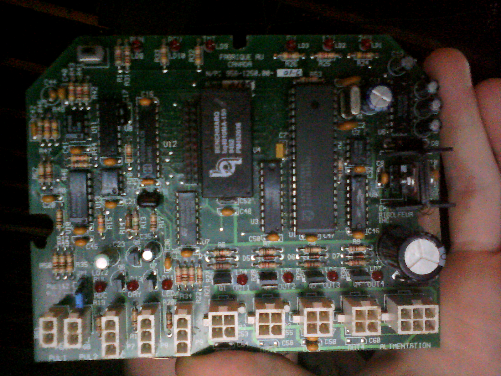

I have hex files to program on non volatile BQ4010MA-150 Sram Chips what programmer would work ?
It has to be under 100$ and it can be either usb or serial or parallel, I dont care.

It would help if we knew the application. We could possibly show how to do without a programmer if you have a processor in the circuit.
3v0
ok here's a picture and an explanation
The board is for a wackyputt minigolf course
It is program through the serial port (usually) but we dont have the software anymore.
The program has to pass through the SC87C51CCN40 8bit microcontroller and write in the 8x8k bq4010MA-150 nonvolatile sram chips
The program consists of .hex files containing hex sequences. i can upload one if necessary. I can also provide a more detailled description of the board and it's chips...

I think I found one for you
PRG-026 True-USB Willem programmer(GQ-3X) Full Pack
The only question left is what format the hex files are in. I think this beast will read most formats but you may have to know which you have. There are only a few of them.
If not converting the files to a readable format is a by far easier task.
The Willem is a class of programmers named for the original designer (I think). You maybe able to find one for as low as $40 possibly in kit form. I suggest A&T :)

EDIT: Ebay has Willem programmers starting under $20. Please check to see that they support you memory.
Your chip is a BQ4010
The MA suffix is possibly the packing or temperature range
The -150 is the speed
I haven't found the bq4010 but the Ds1225 from dallas wich is a pin for pin replacement according to Maxim IC...
