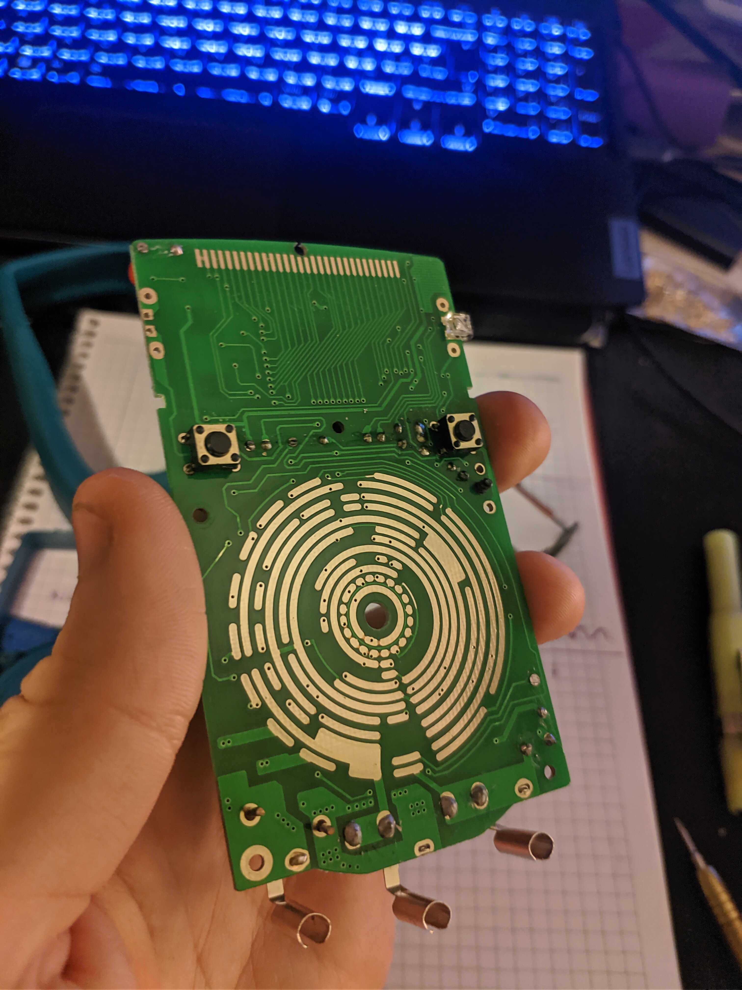

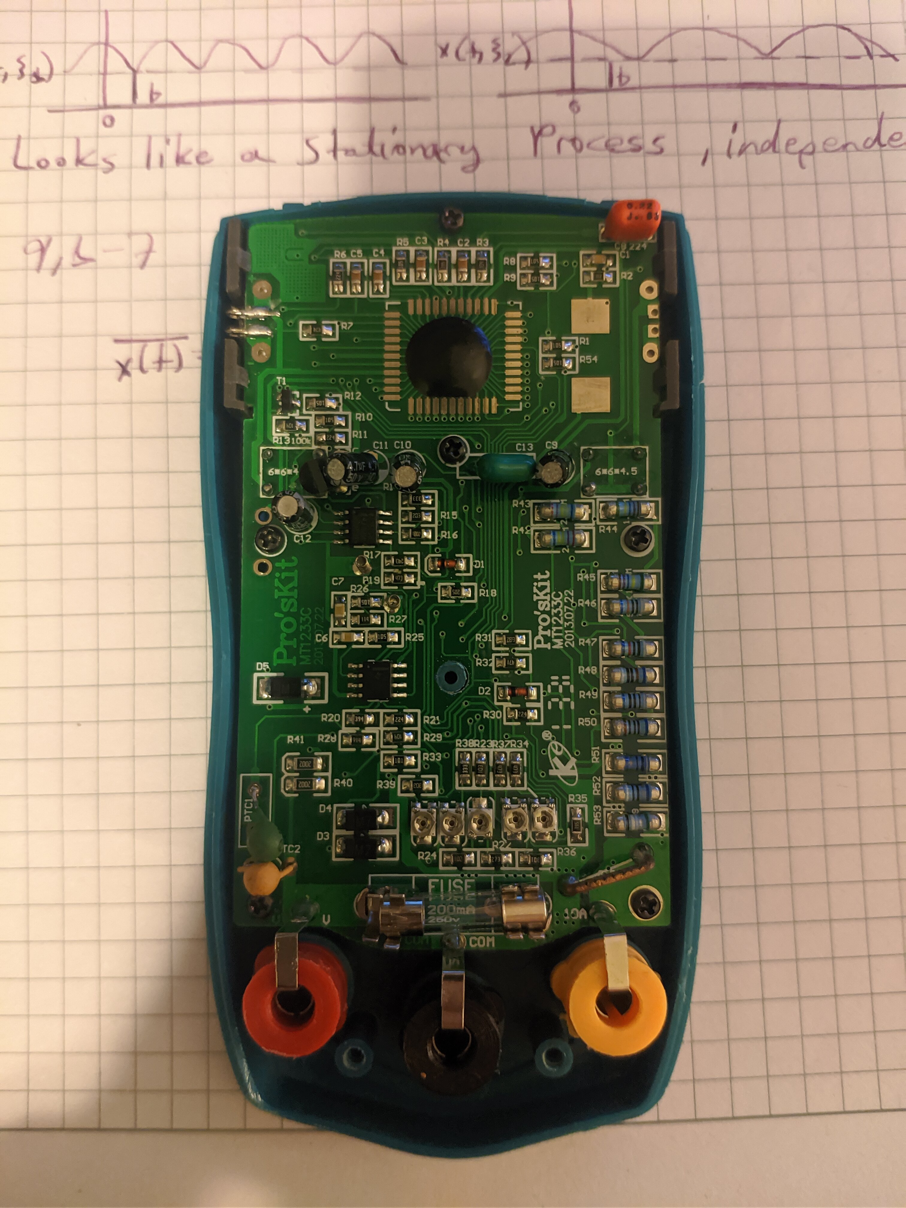

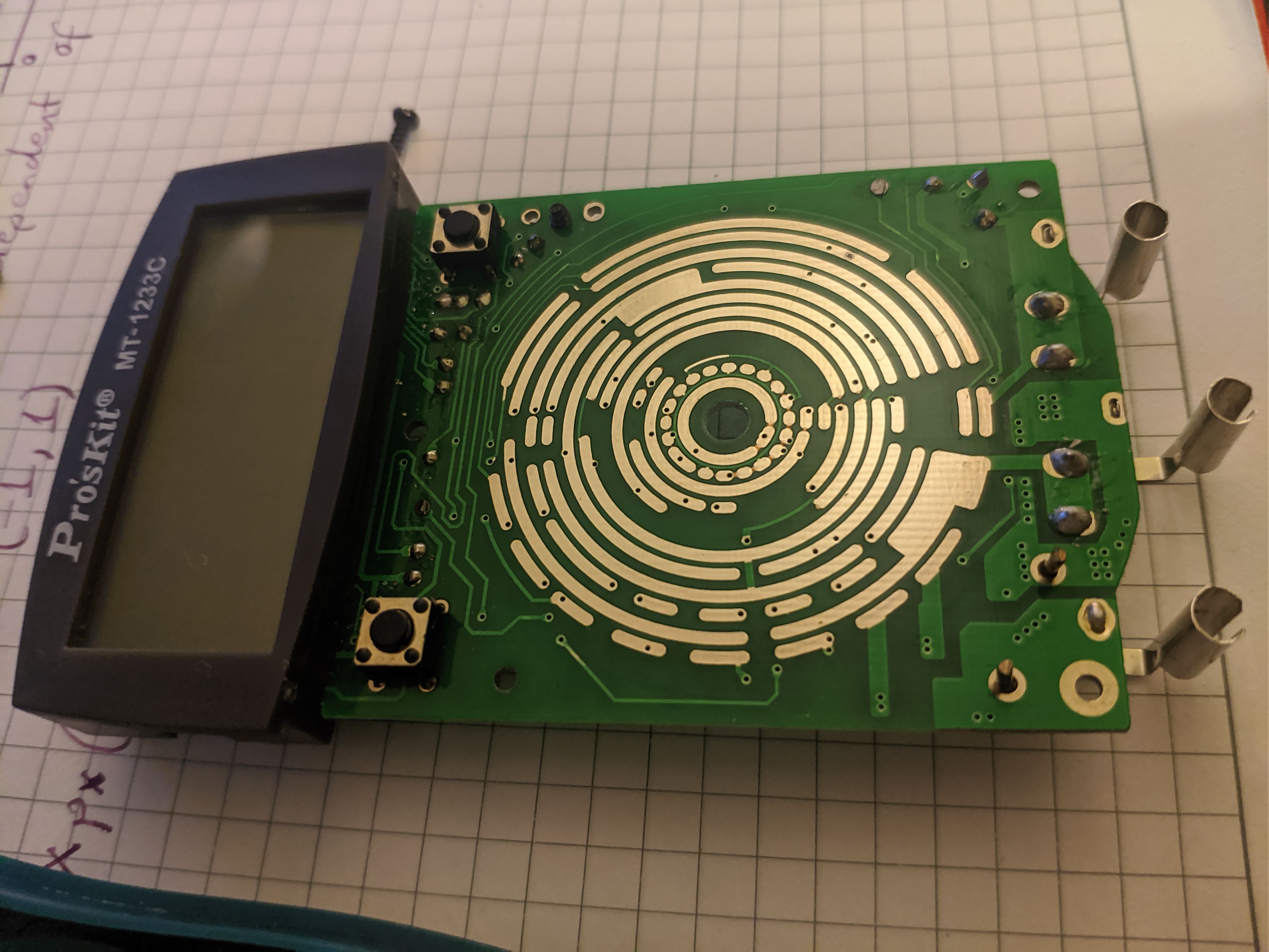

Final cheap multimeter I got started acting up again with illogical behavior after only week of usage. I just want to measure DC, resistors and sometimes DC current. I rarely measure AC since AC stuff I want to measure is usually thousands of volts anyway and I got a small oscilloscope I can use for high frequency low voltage readings. I don't need fancy stuff for but cheap stuff keeps breaking down and feels awful to use. Sometimes I can link device failure to my user error but it is usually randomly occurring nonsense as I explained.

The low cost meters use a crappy range/function switch implementation with
wipers on PCB. When my meters act up first thing I do is clean that interface,
and usually all problems disappear.
The other problem is the flat ribbon cables connecting LCD to display, and the zebra
strips used. Again if you get partial characters, clean that interface.

I did clean the interface as you said you can see the problem I got with my longest lasting multimeter at post #34 and 35. I don't think dirty contact can cause the beeper to beep and screen to light up in resistance measuring mode.

It is clean as it gets. I renew some of the bad looking solder joints on it but it is still broken.

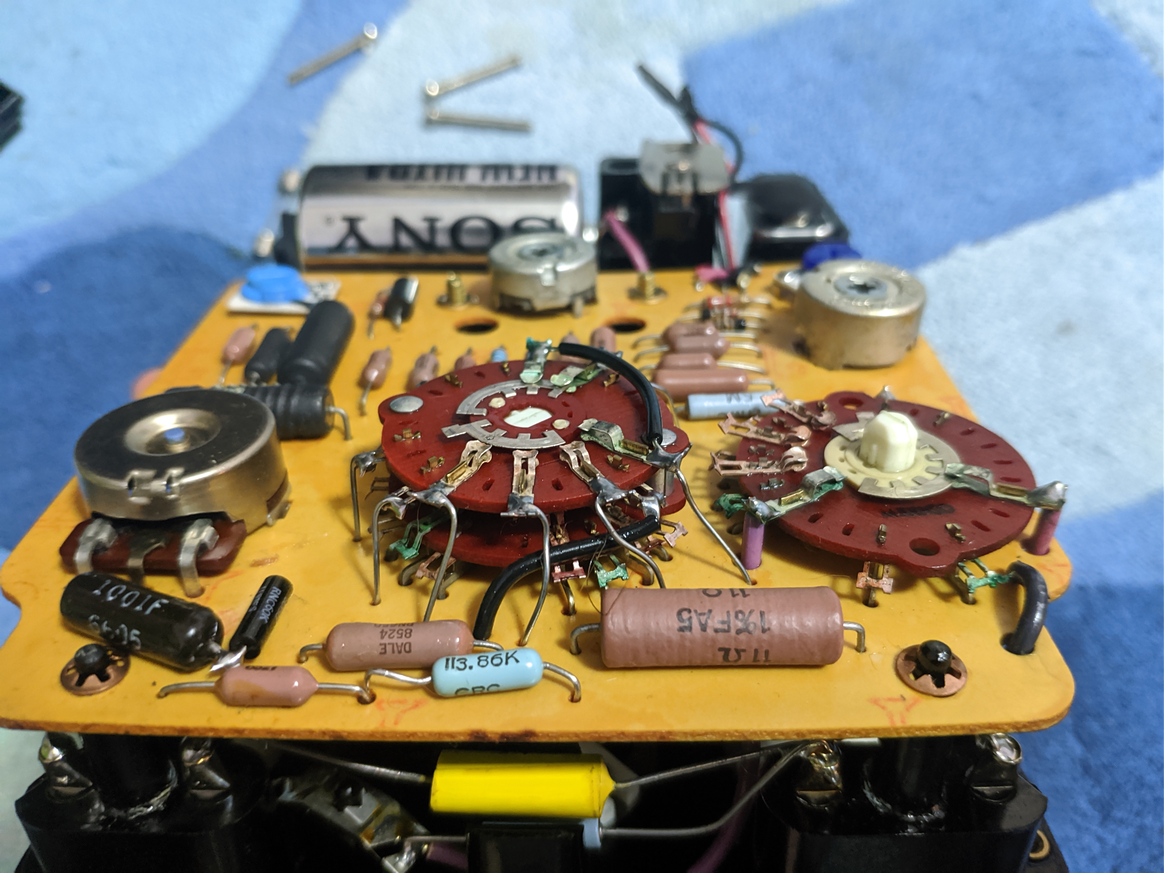

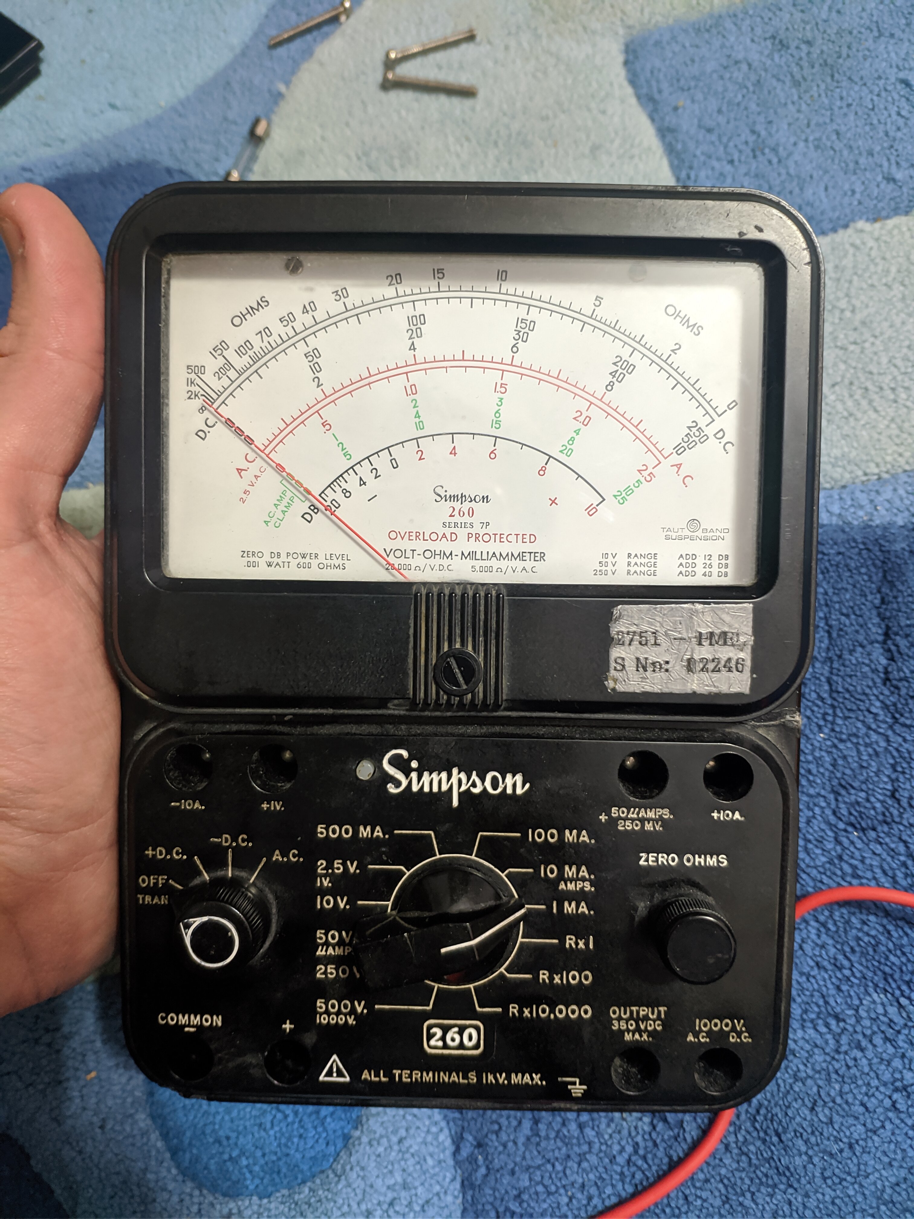

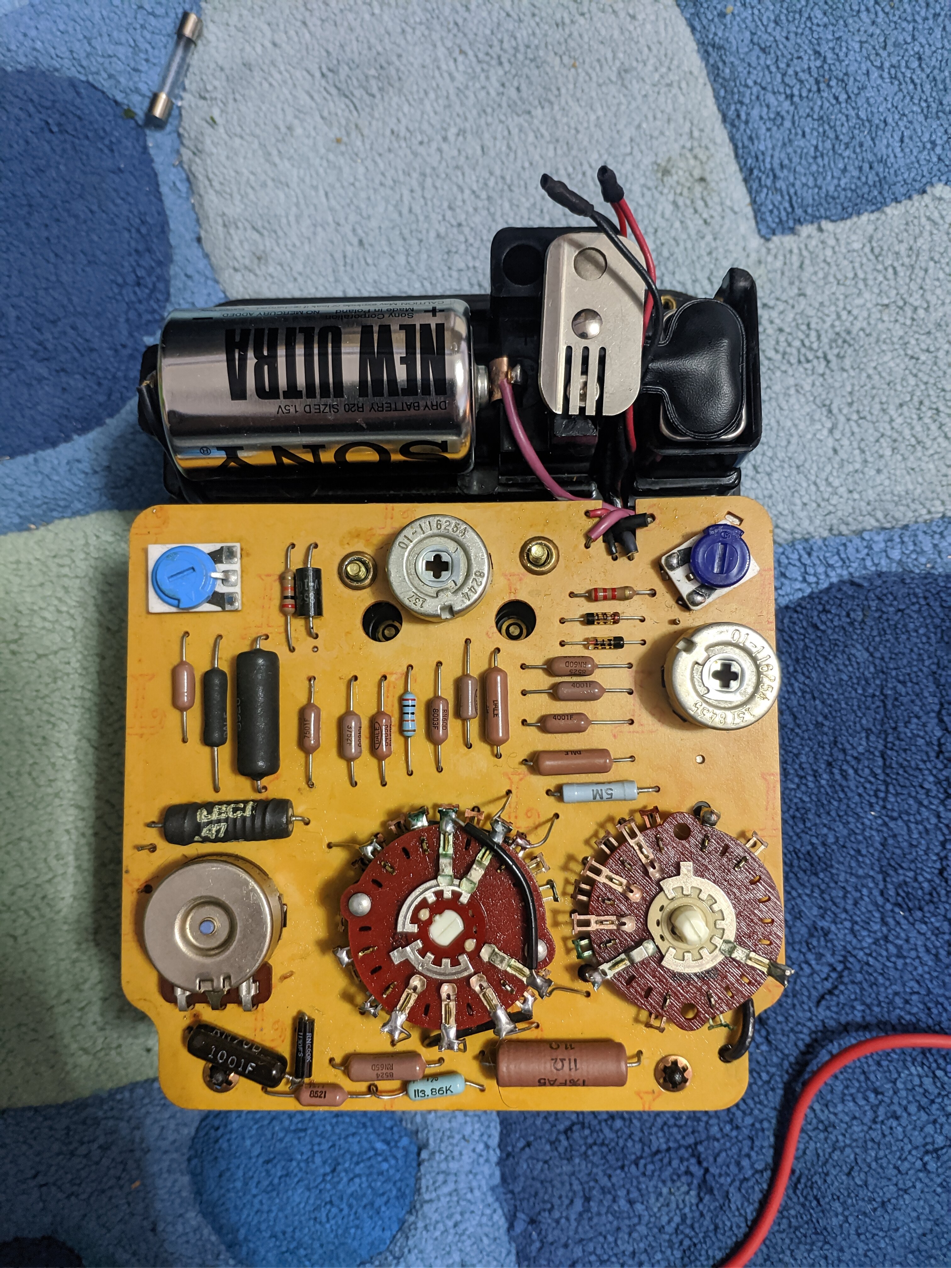

There is my Simpson multimeter. It has these corroded contacts. It slowly lost functionality from the middle selector switch and died. All battery voltages and fuses are fine. IDK how to fix it or remove the back PCB. Brushing the switches with acohol or rust remover did not help.

Try some light oil, applied in very small amounts from the end of a thin wire?
eg. 3-in-1, sewing machine oil, clock oil etc., not a heavier oil or spray.
Deoxit would be best but it's very expensive, more than a cheap multimeter!
(Unless the school or an electrics shop uses it & you can get the switches treated without buying a can).

Would the oil for cleaning and maintaining guns work. Basically machine oil they sell for the stuff you said. I have some other stuff for cleaning electronic contacts but they didn't work on this multimeter.
From what I remember, Gun oil is quite thick? Or at least the stuff my father used on shotguns seemed to be.
It may work, it will at least stop further corrosion.

I have this kind of generic lubricant. It is not viscous, more like regular vegetable oil. The contacts were already oiled from my past attempt to fix it. The odd thing is when I first got this multimeter it wasn't working because middle selector switch was dislocated by some impact that broke PCB standoffs. After fixing it it worked like a charm then started dying after I used it for a short while. It is a very old device so it is odd that it decided to degrade that fast after I fixed it.

I fully wrote about and put more photos of the Simpson 260 meter here since that site was the one that came up first when I searched problems about this meter. It died completely after sitting on a shelf so It annoys me greatly that I can't use it now for unknown reasons. I think it is something other than mode dial since it doesn't respond to anything.
Hey, I finally got Simpson 260 working. It was a burnt fuse. Interesting thing is I checked the fuses like 2 times before taking it apart and looking for something else but at the end the fuse was the issue. I don't know how it escaped all of my checks. The mode dial was still corroded so it took few turns until 1X resistance measurement was working again. It seems accurate enough right now but I should probably fine tune it since it was dropped hard on ground judging from the giang crack across its body. I filled the crack with epoxy and put the missing nuts that connected the meter itself to the PCB. It is fine now.
