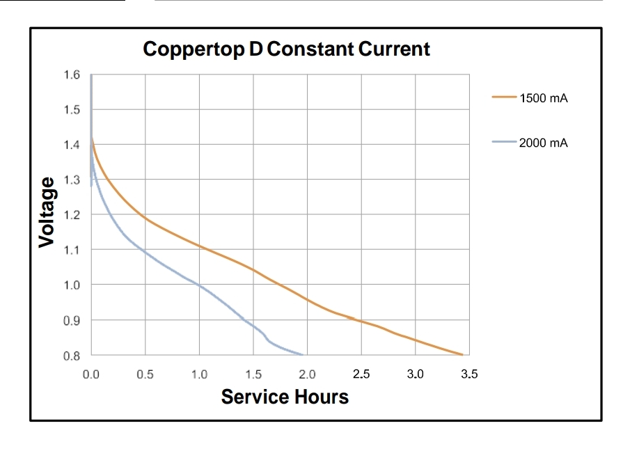

You might want to think about getting 8 amps out of a D cell. Apparently you connected an ammeter right across the cell?
D Cell Data Sheet
The mini flashlights operate from 3 AAA cells. The voltage from 2 D cells will be marginal at the start and quickly be too low to illuminate the LEDs.
