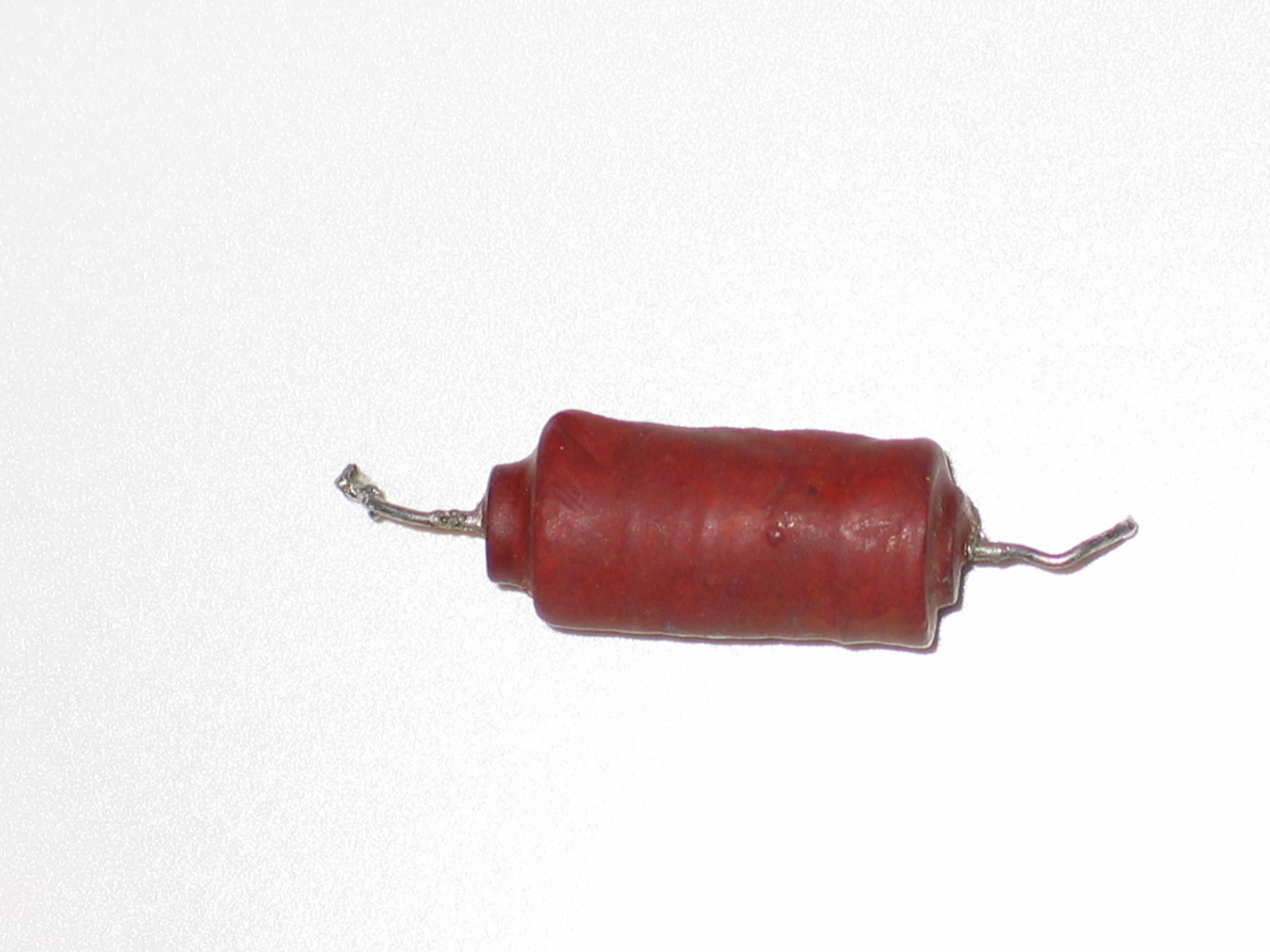

What is this part
Can you tell me what would be the value of the inductor.
I have placed a photo of the inductor with this post
Thank you very much for your input as it is very informative

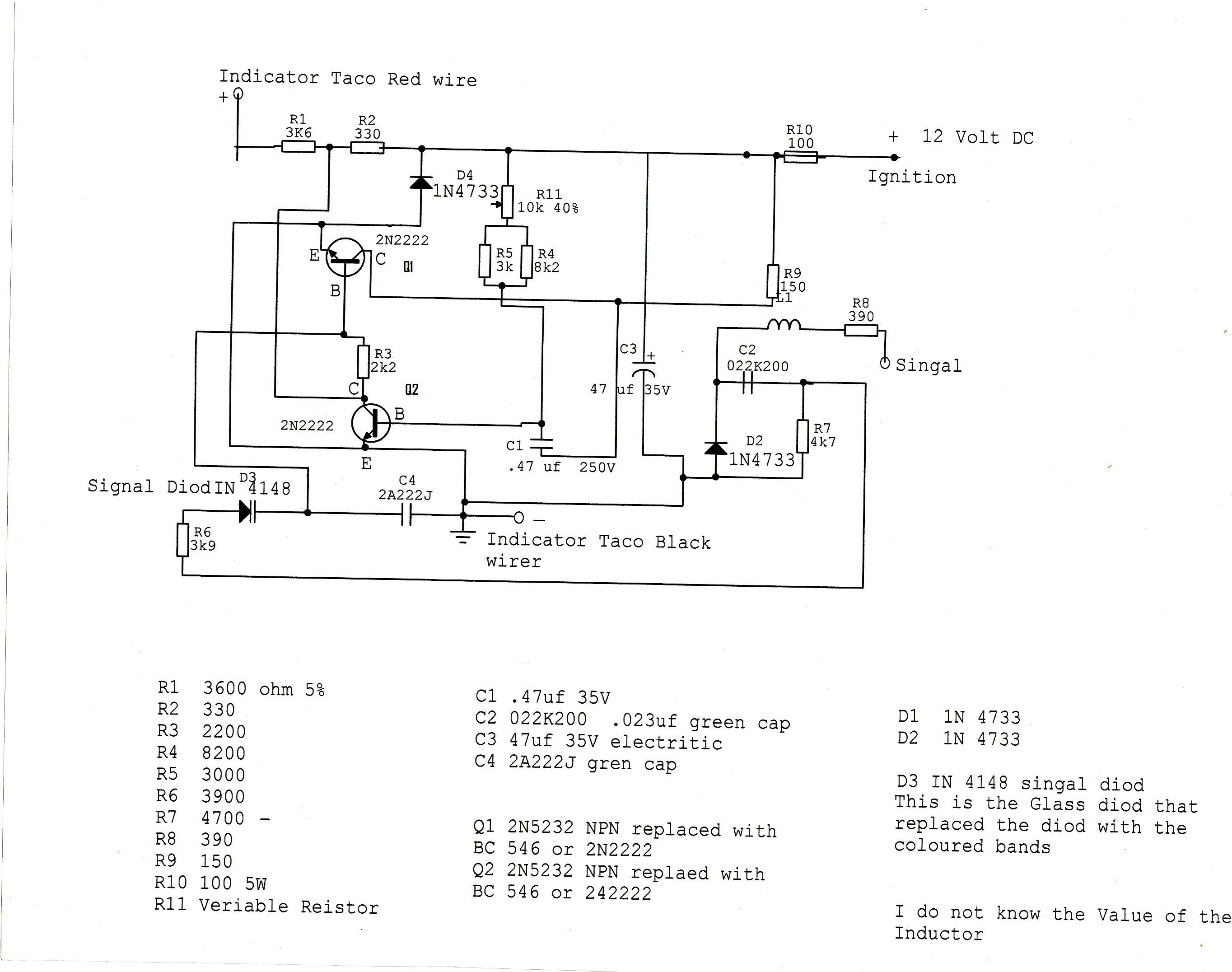

I have altered the Circuit diagram as you recommended.
Had a look at the circuit diagram of the monostable and I can see where the drawing is much simpler than the one I have drawn.
The transistor 2N5232 NPN I have replaced with a 2N2222 Q1 and Q2
and the signal diod I am using a IN4148 is this ok.? for the above also.
I have placed a attachment of the modified circuit diagram.
I hope that it is correct
Thank you Greg

There is a inductor do i need this inductor to test the rev counter.
If i do require this part then how do i work out the value as the one i have dos not giv a reading on a inductance meter.
Greg
Generally the type of the 2 transistors won't matter too much they are both only connected to low voltages and switching low currents. Any 2 small NPN should be ok.
The inductor is just a hash filter on the input. As long as it conducts (is NOT open circuit) then you can assume it is working ok.
The picture shows a typical "coil wound over axial" with fairly fine wire. I'd try a 330uH or 470uH which should be fine.
Its unusual for that inductor to fail, it will be rated at 100+ mA maybe even up to 500mA and even with a worse case miswire of +12v to tacho ground and ground to input the 390 ohm resistor would have limited inductor current to about 30mA.

Excuse my question but you mentioned to use a 330 uH or 470uH Inductor .
I was looking in the parts book and found the inductor but it was under the RF Chokes / Inductor.
Is there any difference in a RF Choke Inductor annd a inductor.
Greg
Generally "RF chokes" are smaller and used for signals, inductors larger and used in power supplies but they are the same thing. In your circuit it only requires a small choke/inductor capable of 200mA or so.

I have installed the taco and the trim pot will not trim the unit enough to 0 the needle .
Replacing R1 with a bigger value will this bring the unit back to 0 and enable me to adjust the trim-pot.
There is a circuit diagram in this post that I drew up .
Can you advise me regards this problem.
Try increasing the value of R2, it seems a little low.
To make the gauge read zero Q2 pulls the voltage low, and it will never reach as low as 0v, but increasing R2 reduces Q2 "on" collector current so you will get a lower reading. That type of tacho probably never read exactly 0v anyway, or maybe was mechanically compensated at the dial spring.
