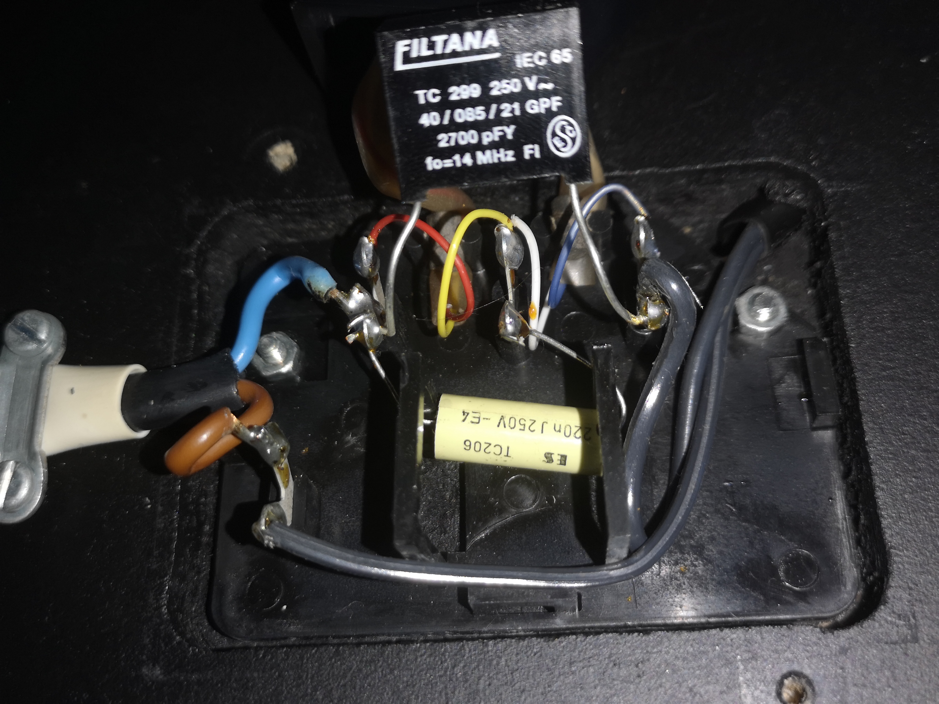

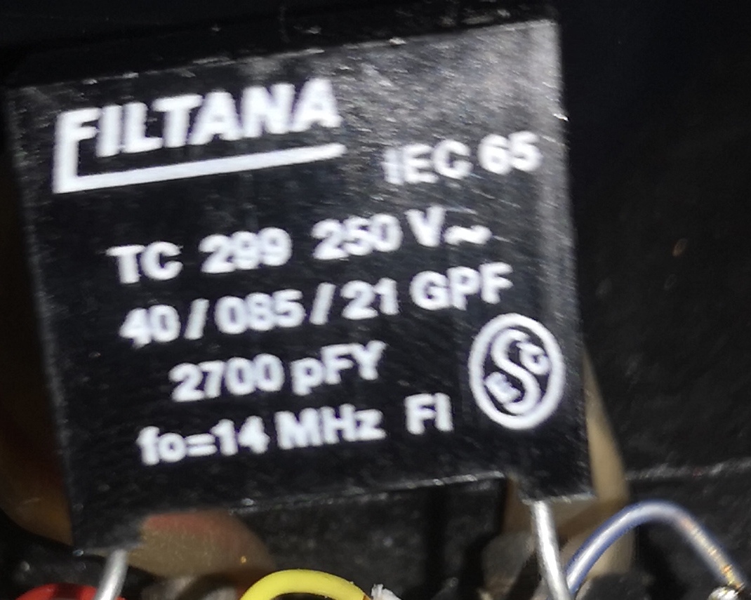

I am looking for a replacement for this component, I believe its a capacitor of sorts, not sure whether if it's a standard capacitor or not. It's fitted to a pro tech P1. 2 turntable, quite old 1990's which is powered by 240v. Its part of the power supply circuit. See pictures.
Any help and advice will be greatly appreciated.

thankyou for your reply, yes the black wires do go to a switch, I am looking to go the 240v motor route in another turntable that I have, which was a 16v turn table which needed a separate external power supply, but the motor has stopped working. I can get both replacement motors 16v and 240v, but im thinking it will be easier to go the 240v route if I can get replacement capacitors. The one in the picture is old and I've not been able to find the same, so im wondering if I can use capacitors of the same rating from else ware.
What do you think?
Martyn Topham
It's a "Class Y" suppression capacitor.
2700pF (2.7nF) is not a common value but a 2n2 or 3n3 etc. would be just as good.
Most electrical suppliers should have them, or they are readily available on ebay etc.
eg.
It's not a 'functional' component, and the turntable will work perfectly well without it - it's just there to filter out some of the possible high frequency noise coming down the mains. However, in the UK the mains is exceptionally good anyway, but even in countries with poor mains you won't tell any difference if it's fitted or not.
