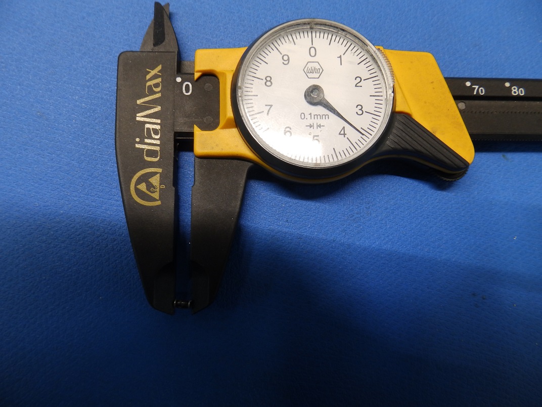

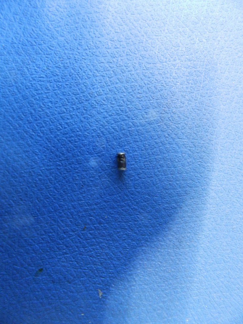

I repaired a power supply. I found a diode in short-circuit. I would like to know what sort of diode it is. I can read 7777 on the diode.
Thanks in advance for your help.

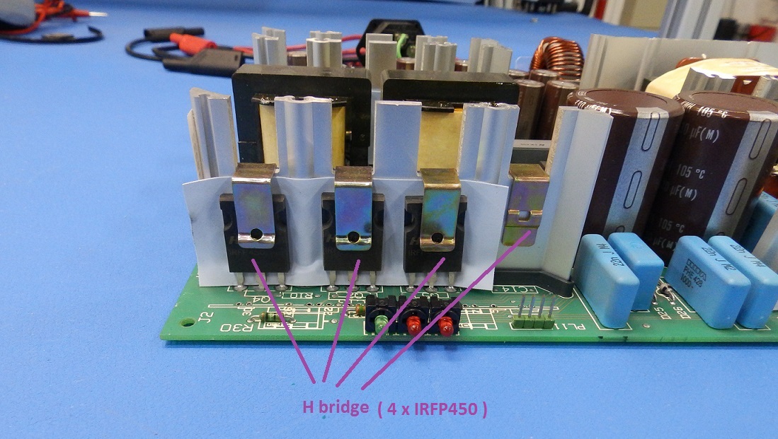

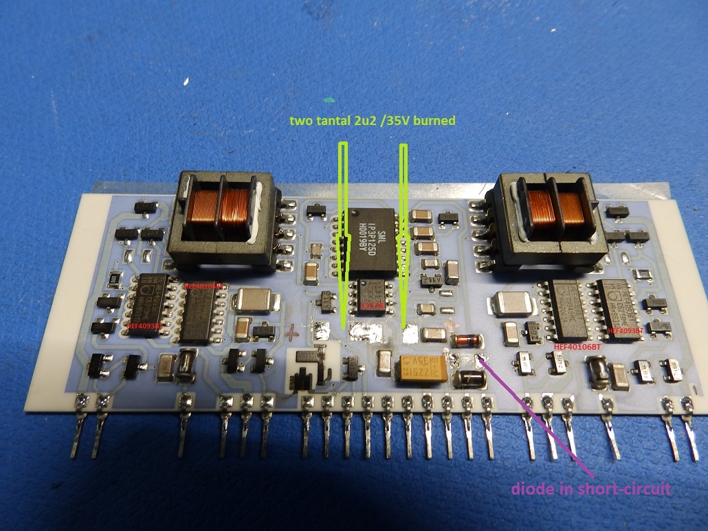

What kind of power supply and what major components were near the diode?
Hello,
I attached a picture on wich you can see the major components near the diode.
The sub-board control the H-bridge.
Ask me if you need more information.
