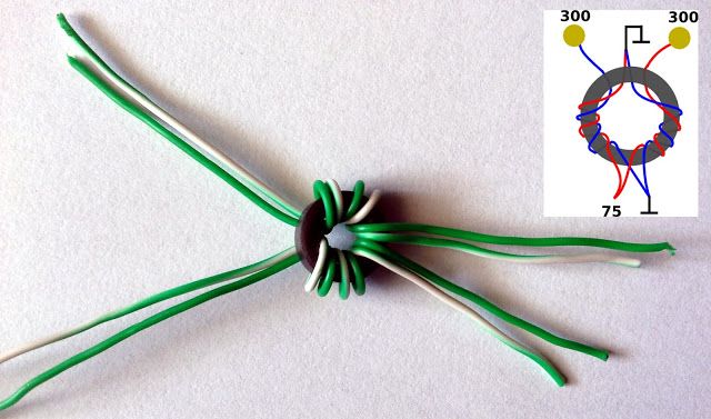

If you were to build your own T splitter & balun what will your circuits be ?

I have everything to build that balun. But my antenna is working excellent so I don't actually need to make a balun but I want to just to test it and see how well it works compared to a factory made balun. The only ferrite toride I have is 5 times larger than factory made baluns I wonder how that will effect performance of the balun. I know I have small twin lead wire somewhere but not found it yet that will make this project easier to build.

I tried to make 3 baluns so far I think the smallest one with enamel coated copper wire is the winner, wires need to be ohmed to figure out which wire is which.

Google online search. I have no clue what the answers are to any of the fill in the blank questions? I have no clue what the questions mean? TV real channel 60 is 750 MHz. I know balun is 2 turns for each of the 4 wires, does that = 8 turns?
Looks like 3 bi-filar turns. 2 full and two 1/2 turns based on your diagram.
Bi-filar Two wires together.
You have 4 windings.
