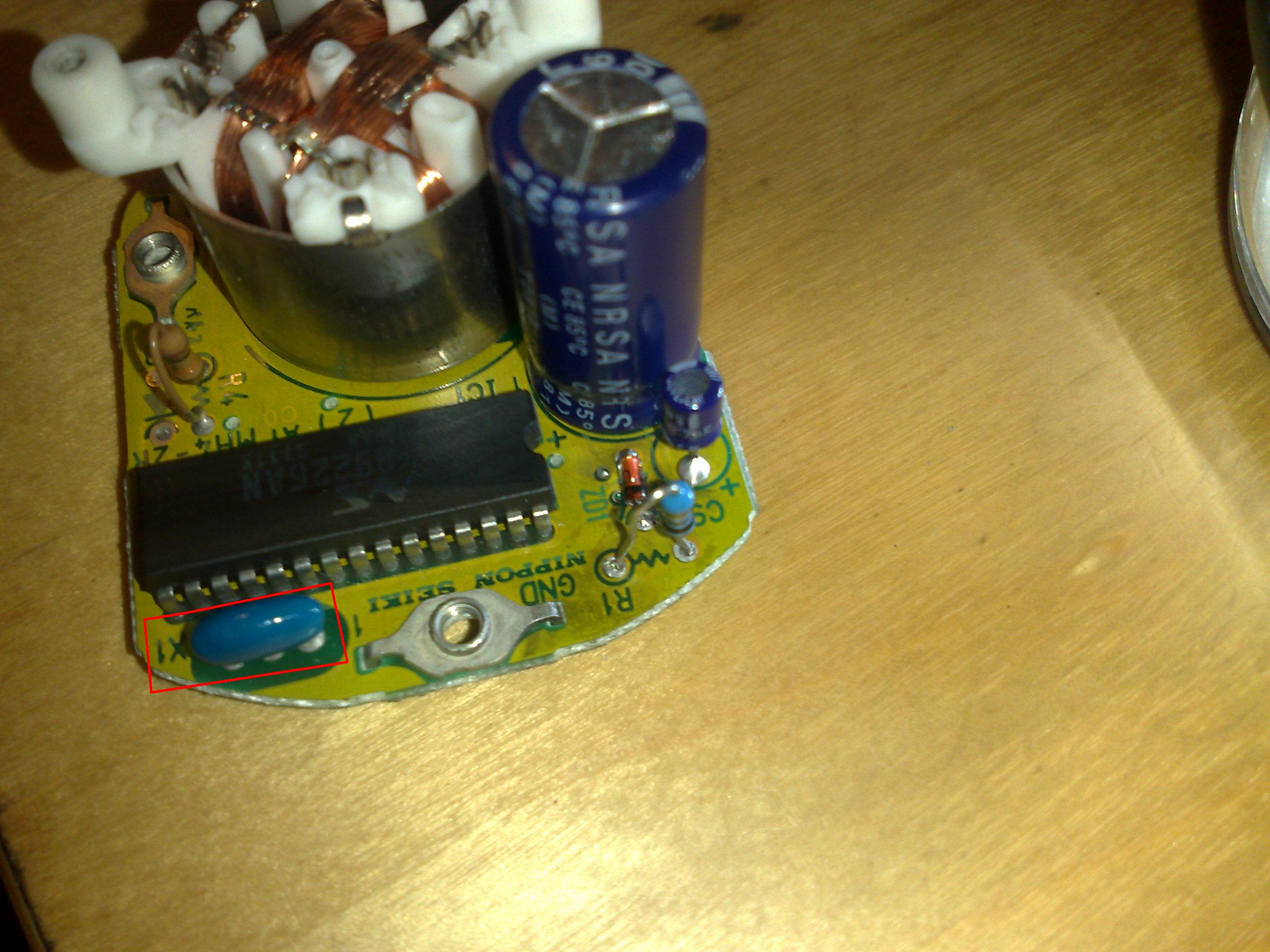

Ive been trying to repair this rev counter from my motorcycle for some time. I finally managed to get the thing to work by replacing 2 capacitors, zener diode and a resistor, all on the right in the picture.
What is bugging me though is the rev counter needle isnt as responsive as an identical rev counter that still has all the orignal parts. The one ive repaired seems to have some sort of lag.
I havent any idea what is causing this needle lag and as a last resort i was trying to find out what component the thing ive highlighted in red is? It has 3 legs and no markings anywhere?
If anyone has any suggestions about the lag or what the mystery part is i would be very grateful.

The big chip is likely a u-controller and the circled thing is a ceramic resonator used to control the frequency of the clock that the u-controller bases all of its timing on. If that part was bad, likely the entire thing would do nothing at all.
That item is most likely a ceramic resonator. It is the component that determines the frequency of oscillation of the clock in this digital circuit. These resonators are not easily broken and don't usually drift all that much, so if the counter is working at all, I would not suspect this part as being faulty.
You mentioned that you replaced some other parts including a capacitor. I wonder if you have put too large a capacitor in and this is causing delays in changes to the input signal. And on further thought, it is possible that too large a resistance might cause trouble too. Did you replace with identical values?

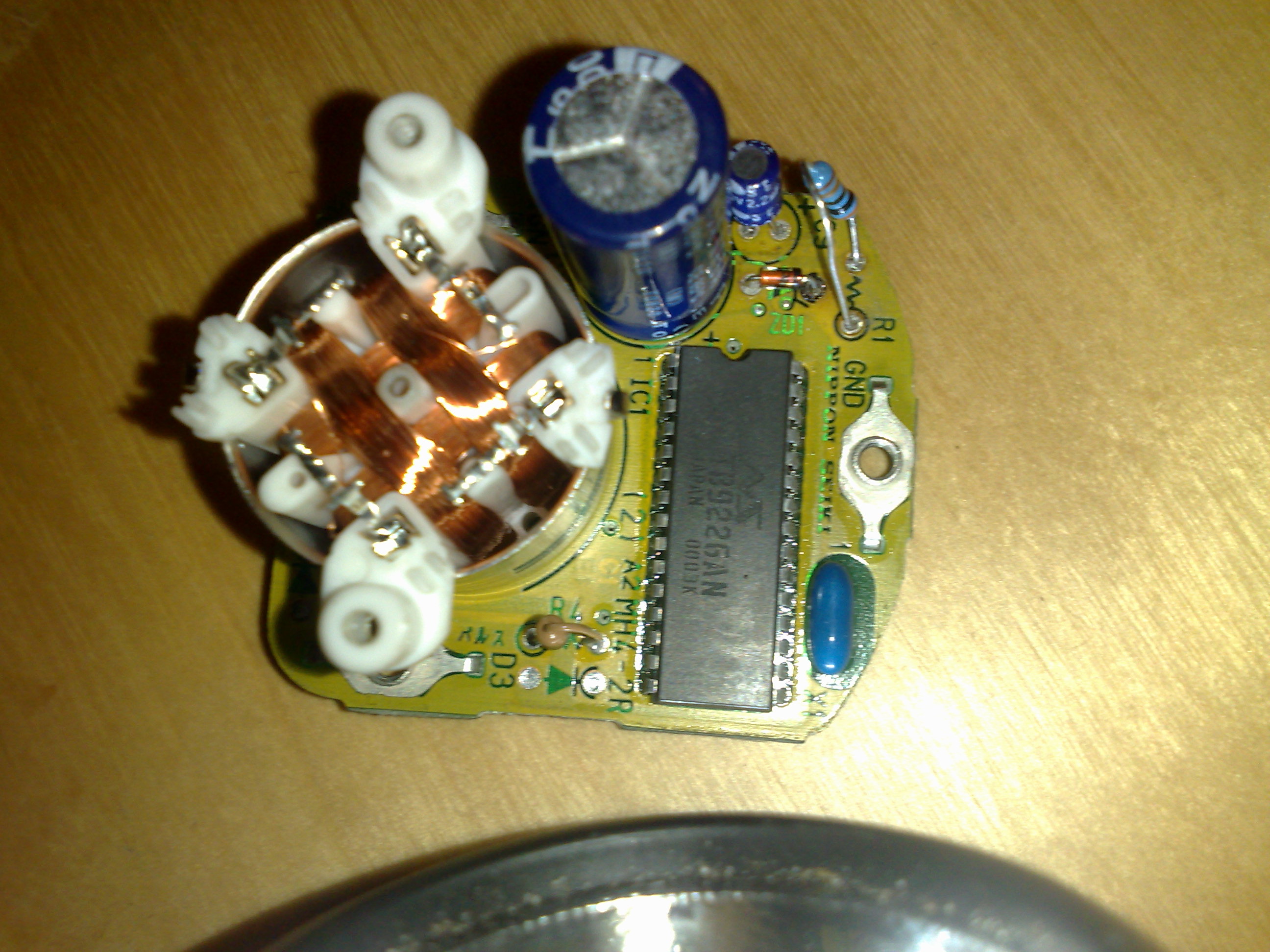

Some thoughts.
1) I verified that your negative leg is correctly connected on the electrolytic capacitors in the picture, so good going there.
2) Difficult to see your diode and be certain of its bias. Are you certain the black cathode band is in the same direction it originally was? That would unlikely be the problem as you say it functions though with a lag, but make sure it is the same.
3) Do you still have the original components? Perhaps you could snap a photo of them so we can be sure the replacement components are in fact identical. I'm sure you have it right but we are all human.
4) The DIP IC is obviously functional, but we don't know the assignment of every pin and a partial failure could have occurred when the regulator failed...ICs have internal resistors, diodes, transistors that can conceivably function with one internal component faulty. Also, I can't see the ID for the chip. Perhaps you could offer the numbers printed on it and we can pull a datasheet. It might be a uC or OEM device but it might be a standard package too.

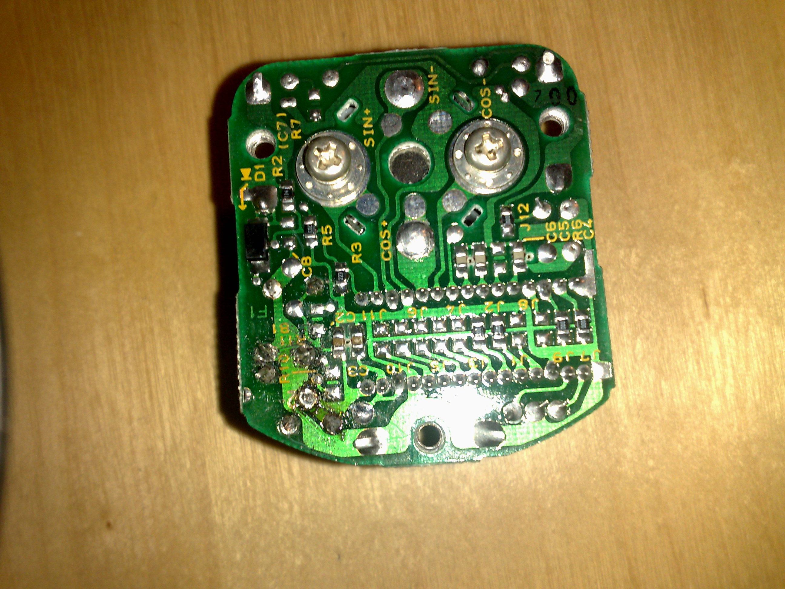

It is a pretty small circuit. Reverse engineering these is always helpful. That is if you can draw schematics. Backside photographs might help too.

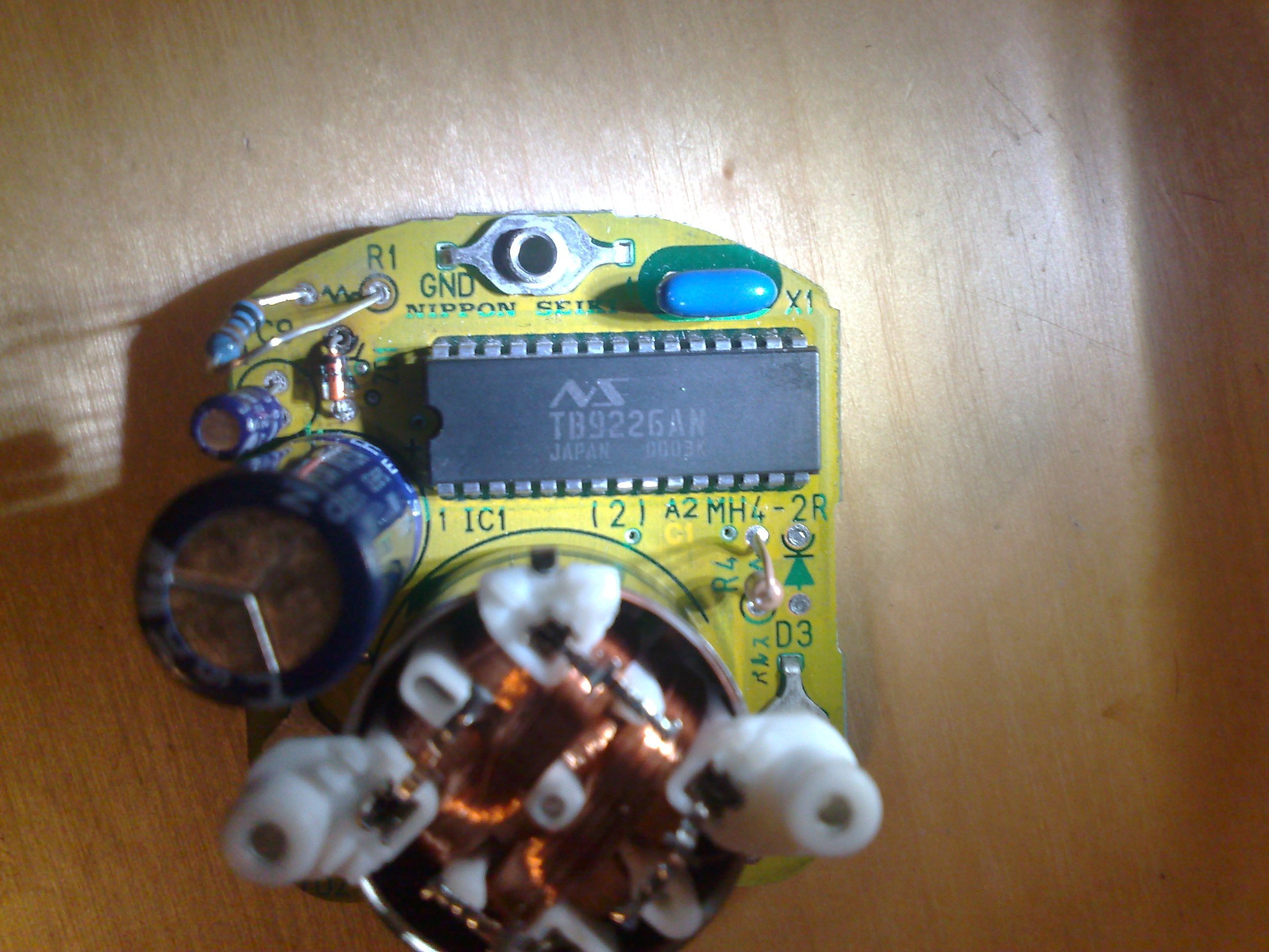

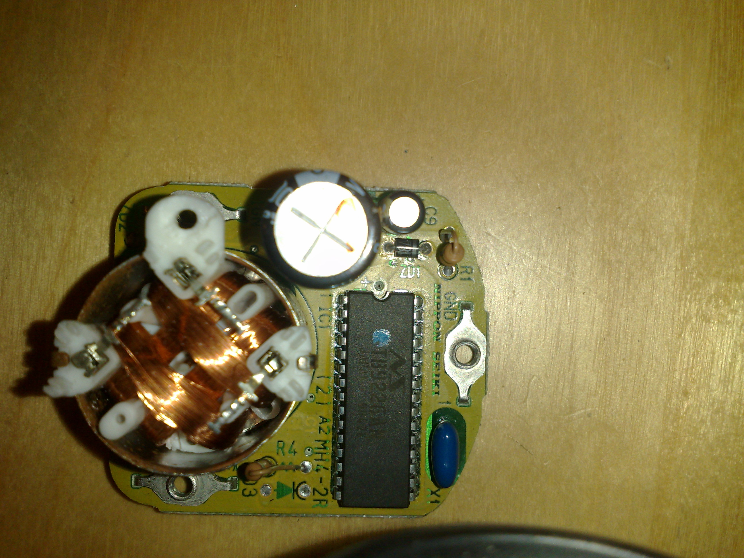

Heres some more pictures, hopefully you can see the chip ID and the diode bias. There also a picture of the backside of the pcb.
I will try and get a picture of the original too, just to make sure it isnt user error with the components ive already got on there. Dont rule it out
On on the limits of my soldering ability too, ive got no chance of soldering a chip, although i would give it a go as ive got nothing to lose and im sure the practice would do me good.
Also how would you work out the value of the ceramic resonator if theres no ID on the part?

looking at the underside of the pcb there seems to be a poorly soldered join directly to the left of a 22k surface mount resistor which needs desoldering and resoldering again....also on the underside of the board where its marked R10 there is some more poorly soldered joints....if you have access to an oscilloscope or frequency counter it would give you a good idea as to what frequency that unmarked item is oscillating at.......

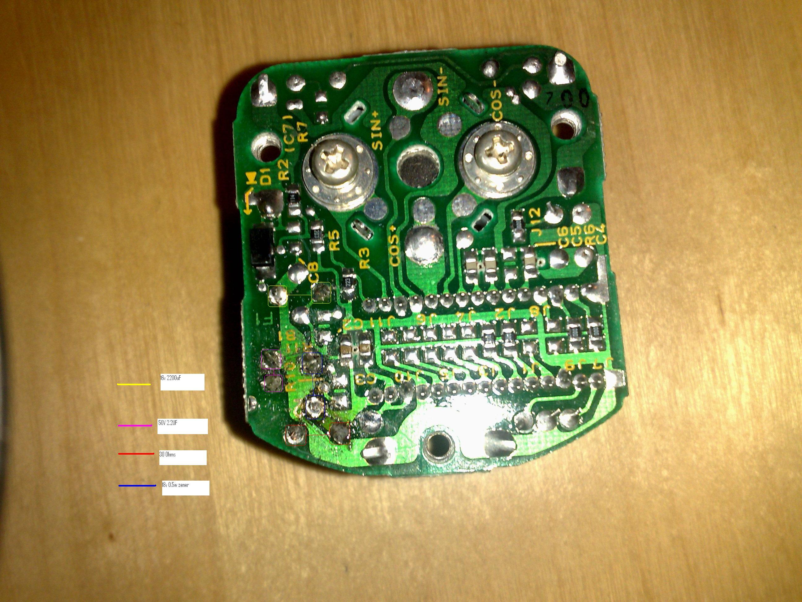

Point taken, i will give it a go tomorrow to clean the joins up and get hold of a magnifying glass to make things a little easier. Ive also highlighted the area and the components i soldered on.
It still leaves the question of the lag of the needle.

Just taking a shot at the IC, I didn't turn up a datasheet...though I did find a "similarly" I.D'd uController from another manufacturer. The NS on the chip is the same logo on the Nippon Seiki website (not surprising)...indicating that this is likely OEM/proprietary and a datasheet won't be forthcoming. The significance of this is that reverse engineering and really knowing whats going on with the circuit is not going to be "doable" without a lot more expertise than I possess
It probably is a programmed uController unfortunately.
But that is unimportant. You have a lot more going on with the circuit even beyond that. You have a good amount of SMDs which look like resistors, diodes, and transistors. If a regulator failed any of them could have been damaged. With a scope, board connected "in circuit", with the right input and output transducers and signals being generated...you MIGHT be able to find an open circuit with some waveform and voltage checks and ID a failure.
...More trouble than its worth IMHO. I'd get a new board and fuggetaboutit if you can't live with the lag. But that's just one man's opinion.
Oh....but I would add. A couple of those SMDs look like capacitors. A change in response (a lag) would seem to indicate a reactive element not behaving. A capacitor would qualify. An SMD capacitor might be especially vulnerable to a regulator failure. If I went any further with this I would replace at least the SMD caps.
Yeah...C2 thru C6 appear to be for coupling or noise filtering at the IC inputs. Some associated resistors as well in there. You also have some kind of diode (D1 I think?) on the backside that might need to be checked. And cleaning up the solder joints might set things right as well for sure. Be careful with soldering damaged or potentially damaged thru-hole components. Pieces of trace can be lifted. There are techniques like scraping the lamination off of foil trace and soldering the part to the trace when damage like this occurs.
I could be completely wrong, but here's my theory. I think that the small capacitor is for filtering the speed signal. Not the pulses coming from the ignition system, but the voltage proportional to the revs.
Electrolytic capacitors like that get less capacitance with age and have very wide tolerances. It could be that the one you fitted had a much larger value than those on the rev counters you are comparing it with, even though they have the same numbers written on them.
You could try running without a capacitor there at all, which might make the needle vibrate, especially at tick over. Or just try half the value.

I'm just curious as to why Diode D3 is mising from the board. Is that factory?
