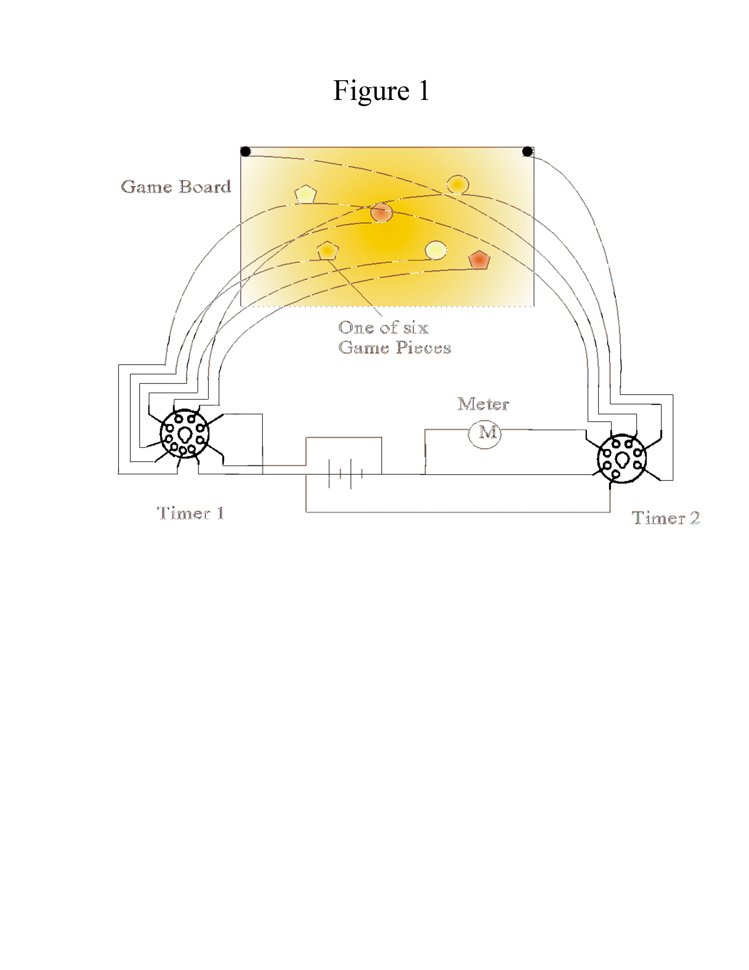

In addition to availability, what are some other disadvantages of a resistive sheet? I’ve made a new diagram of how a resistive sheet could be used as a game board, so I’m going to go ahead and post it in this reply.
Right now I’m working with a model in which the game pieces are a little cumbersome because wires that are used to communicate the pieces’ properties – and that could also be used to indicate the pieces’ positions instead, connect to each game piece and run across the top of the game board to terminals. I intend to complete the circuit using a schematic similar to the one attached – which I still need to review. The signal may be varied according to an amount of resistance that I am hoping will vary somewhat consistently with respect to a distance between the game piece and each source of electricity on the game board labeled in the attachment – if and when I find the right material to make the game board out of. The play area is about two feet by two feet.

It's not too hard to model this, (nice graphics aside), what you have to do is solve Laplace's equation on your surface. You will find plenty of references (and code) on the web. I don't think you need to go this far. You can see the sorts of problems you are going to get from a much simpler problem that can be solved exactly. Consider a sheet that is infinite in all directions, and the two contacts are made with conducting discs of radius 'a', separated by a distance 'D'. In this case the resistance between the discs is proportional to
ln(D/(2a) + sqrt((D/(2a))^2-1))
which goes to ln(D/a) for D >> a
What this tells you is that errors in 'a' are just as important as errors in 'D'. So if your pieces are 5mm dia, spaced at 100mm, if the surface is not perfectly flat and they make contact only over the middle 2.5mm, then you will be out by 100% in the distance estimate. Note that this also says that the worst thing to do is to use a point contact!
Also, other pieces in close proximity will significantly affect the result. So unless you can solve the connection reliability problem, I'd look at other techniques, e.g. the capacitively coupled grid option, or optical methods.

You are misunderstanding the concept of resistance in a 2D sheet. This sort of material is characterised by resistance per square not per length. What I was trying to point out was that it is not meaningful to say what is the resistance between two points 100mm apart, you also need to say how big the contact areas are (and actually what the shapes are). It is producing a reliable contact that I think will probably kill your design (even if you can find some suitable material). What those equations tell you is that if you have two contacts 100mm apart and pass a current I between them, if the contacts are 5mm dia then you measure a voltage V, but if the probes made poorer contact and were effectively 2.5mm dia then the voltage measured is 2V, giving you a 100% error in distance estimate. Because the current density is so much higher in the vicinity of the probe, you can get the same voltage drop over the last 1.25mm as over the whole 100mm.
If you want to pursue models, if you are good with programming you can write/modify a Laplace solver (e.g. see https://www.electro-tech-online.com/custompdfs/2008/12/ohmic.pdf for some theory), to play with some simple models there are free packages like QuickField software license types that could help you learn (I've never used this, but it does solve these problems).
But to me, the killer issue you have to solve is making consistent contacts.

I plan on using contacts that are about the area that the rounded part of some of the tacks that are sold would make with a flat sheet - or the area that a very small clip would make with a thin pin protruding from a sheet. So, the contacts could be weighed down or mechanically attached in this way. I may be wrong, but I don’t foresee either of these methods resulting in a poor contact.
What is the force that is causing the electrons to flow through the sheet? I thought that the force would be, in my case, a chemical reaction in the battery. So, I was thinking that the electricity would flow through the path of least resistance to the other terminal on the sheet that completes the circuit with the battery. But, what you are saying, if I understand you correctly, is that the electrons will be traveling with the same characteristic in all directions outward from the negative terminal. I want to be really sure that I understand this concept because, if the electrons travel in a manner characteristic of what you are saying, then I might not need a sheet with special resistive properties. The resistance would seem to me to decrease both as a function of area and distance according to this theory.

I found a suitable picture of the current flow between two contacts
This is the solution to a different problem (which is why the lines are labelled E and H), but the equations being solved are the same and so the picture is relevant. In the picture the E lines correspond to current flow (and the closer the lines are together the higher the current density) and the H lines for your problem correspond to lines of equal voltage (with equal voltage difference between adjacent lines). Note that the current density gets very high around the conductors, and the voltage gradient increases. This is what makes the problem very sensitive to the actual area of contact, and what I think is the achilles heel of the design.
If you want to explore further, you can get Maxwell SV from Ansoft, a serious commercial solver that is free, and has no limitations for solving this sort of problem. **broken link removed**

Would it be accurate to say that as the resistance of the material increases, the current density off to either side of the wires and the current density between the wires becomes closer? Is this going to effect the resistance in the wire apart from the sheet? Do electrons take a longer time to travel along the longer red curves from one wire to the other, and is this travelling time measurable just using the two wires? What is this travelling time called? What in the diagram would cause a measureable change of electricity in the wire apart from the sheet as the distance between the two wires contacting the sheet changes?
1. Did you think of your physical circuit implementation to detect something on a resistive sheet? The only way I can come up with is to line the edges of the sheet with contacts and then measure the resistance between every single opposing pair of contacts and then choose opposing X-pair with the lowest resistance and the Y-pair with the lowest resistance and call that the position of the playing piece. A few problems arise with this method. First of all, it is IMPOSSIBLE to detect the position of more than one piece because there is just too much coupling between the outputs and the positions of the pieces. This pretty much puts the nail in the coffin for a gaming board.
I may be able to time the signals to distinguish them using this model. However, I’m not sure if I really understand this model. Let’s say I introduced electricity into a sheet at a location corresponding to the location of the game piece. Now, if the edges of the sheet are lined with contacts – as this model suggests, would the contacts nearer the game piece – specifically the contacts closer to a perpendicular bisector intersecting an axis and a game piece, receive a larger measure electricity than those contacts further away along the same edge? What electrical property of the sheet would have to be changed in order to change the difference in measure of electricity between contacts on the same axis? What would be the reason for this? In order for this difference in measure of electricity between contacts to be practically measurable, would the sheet have to have certain electrical properties? Using this model, would I have to time the circuit connected to the contacts on the x axis on a different interval than the circuit connected to the contacts on the y axis – so that small changes in the amount of electricity received from contacts on one axis is not equally compensated by small changes in the amount of electricity received from contacts on the other axis at different locations where electricity enters the sheet?
